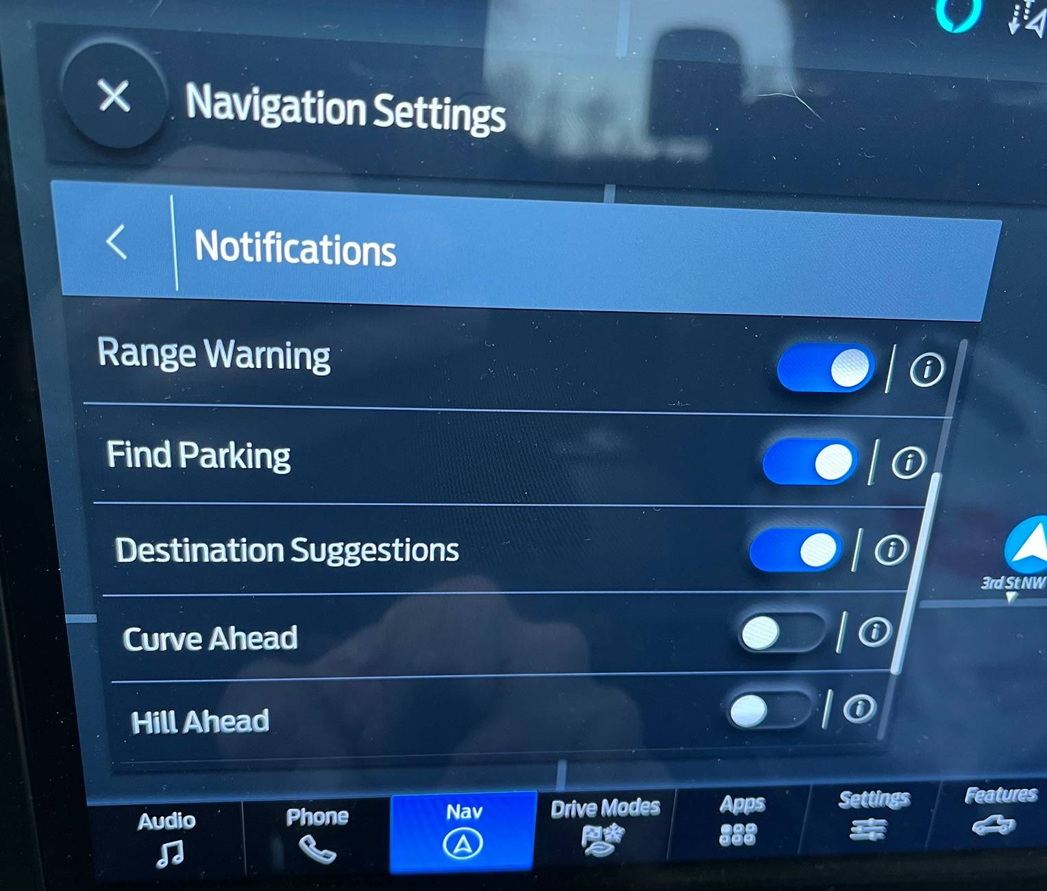

Found this in the Map Settings while I was waiting for the kids to come out of school. I guess I can turn it off if it bothers me too much.
Keep looking, there is a setting in pro power on board that lets you adjust the energy reserve to a lower mileage, it's primary purpose is to ensure that you NOT run your truck out of energy while in generator mode, adjust this setting from 50 miles to 10 miles it will also affect the navigation warning IIRC, select a value & irritation balance so that your not caught dead on the road.
I would strongly suggest turning off that "Destination suggestions" switch too. If you've ever heard a "bong bong" double chime for no reason when starting the truck... well, that's the reason
