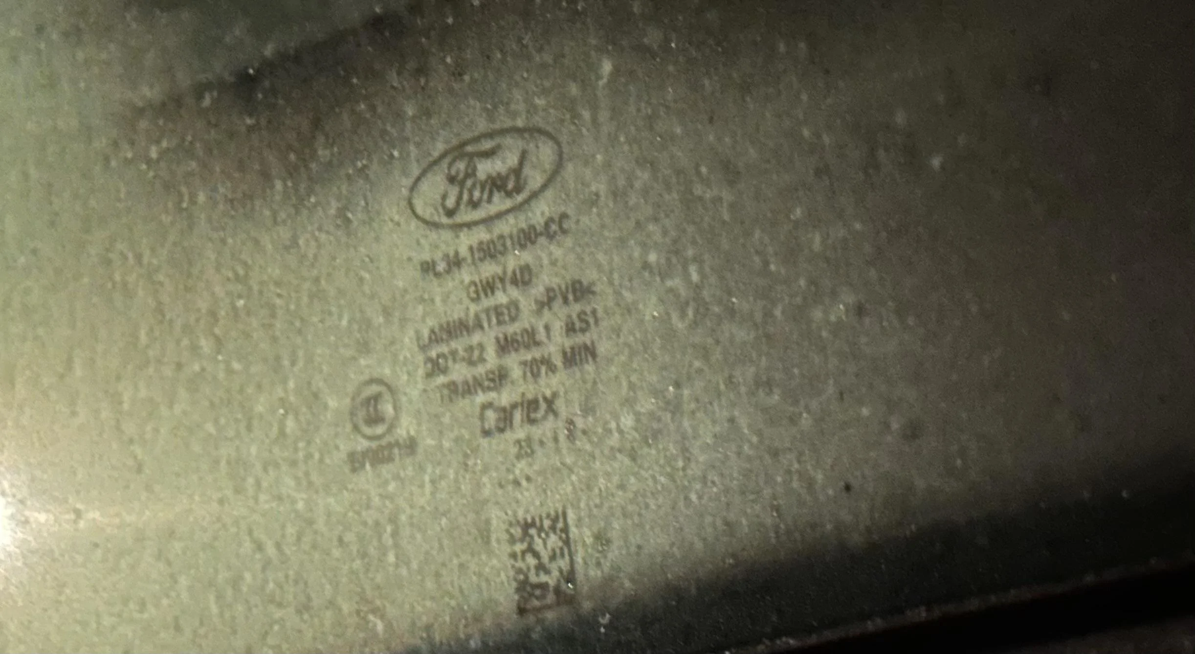

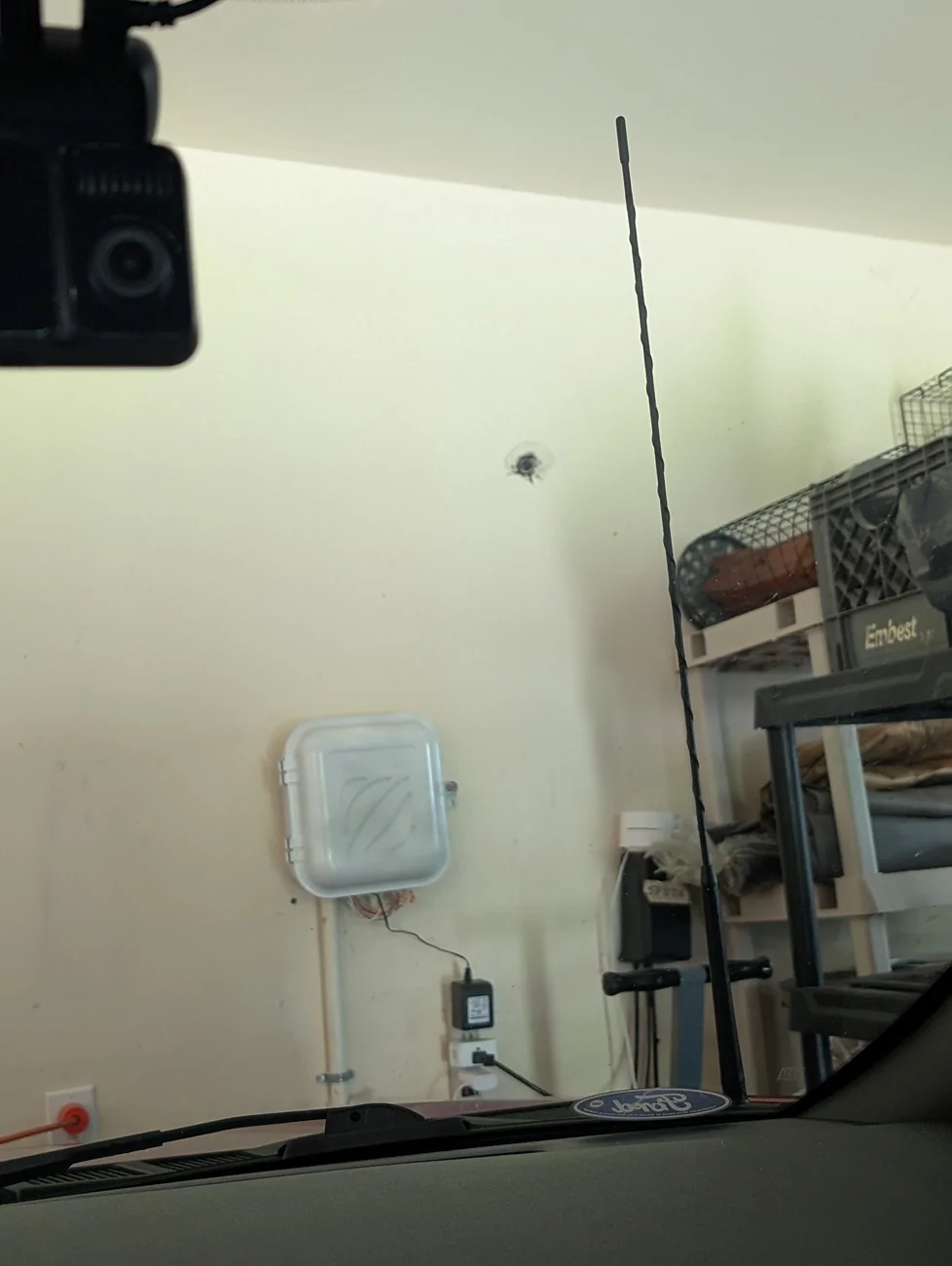

Hello folks, does any one know the part number for a replacement 75th anniversary windshield? I want to make sure Safelite has the correct part before they come out. Looks like a rock got me and my windshield has a growing crack
Thank you!

I didn’t realize the part number would be on my existing windshield anyways! Sorry, keeping it around in case it helps anyone else
Ford F-150 Lightning 75th Anniversary Windshield part number IMG_1125

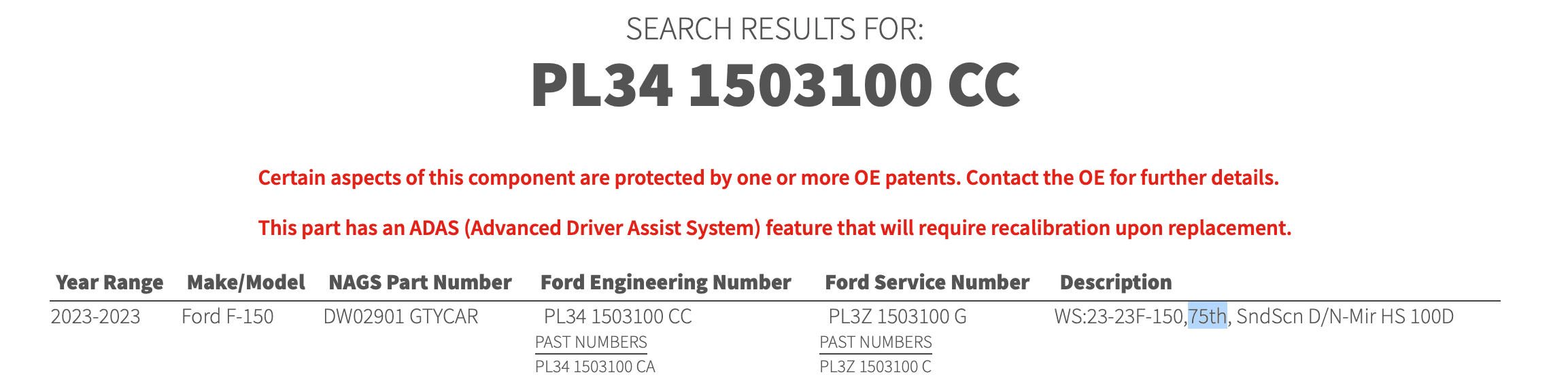

Safelite will let me send me a picture of the windshield when it arrives before they put it up. I looked up various part numbers for it on Carlex, attached

Part number is PL3Z1503100C, which I can see can be had for about $500 from online sellers.

Keep it handy. In my above post, I also attached the NAGS part number that Safelite and other glass providers may go by. Since these trucks are new, your insurance will most likely want to use OEM parts. If the glass company uses your VIN to order, it should come back with the correct windshield. Just verify before they put it on

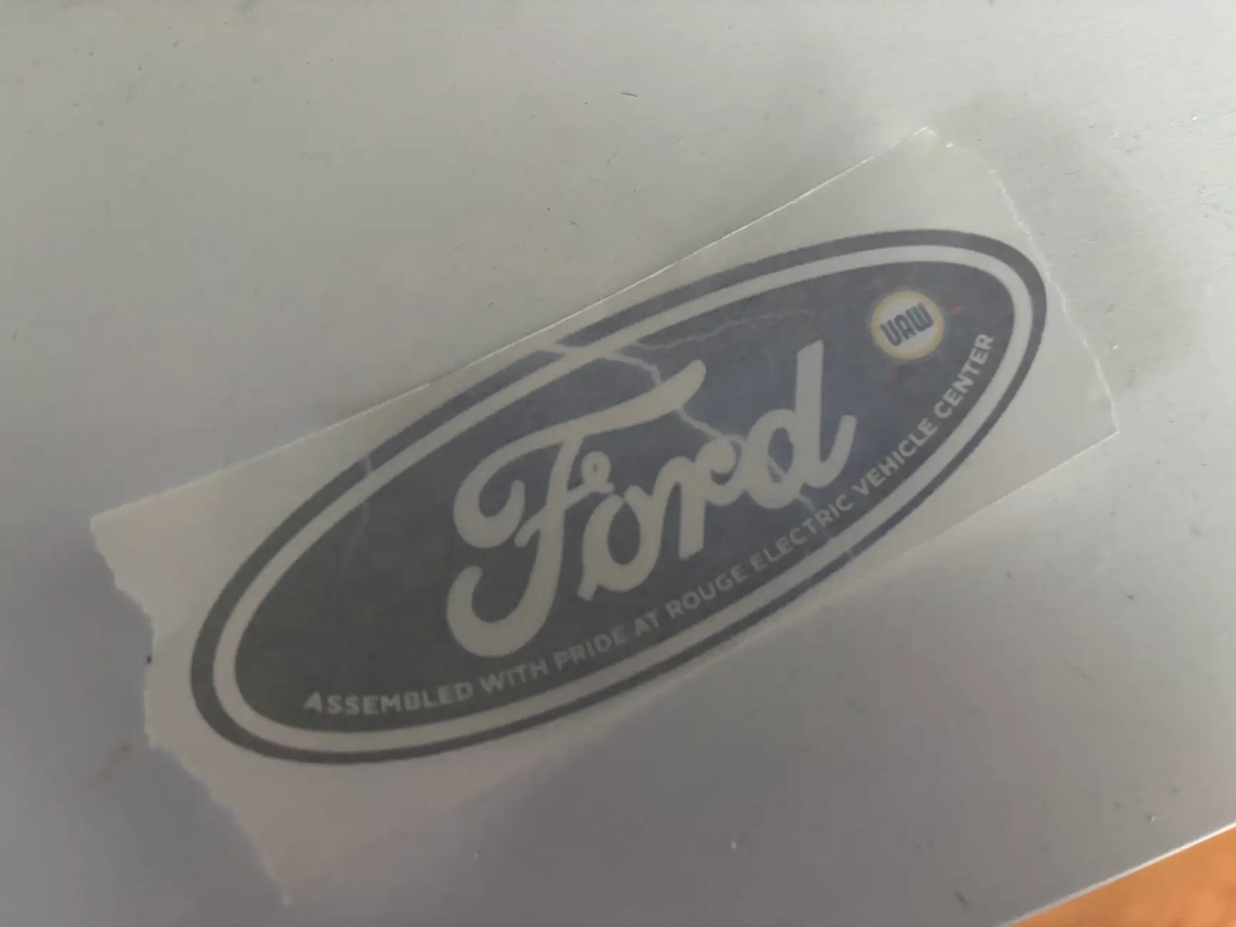

Update: Safelite completed it today, it has the 75th Anniversary decal ?
Now to find a replacement UAW sticker!
