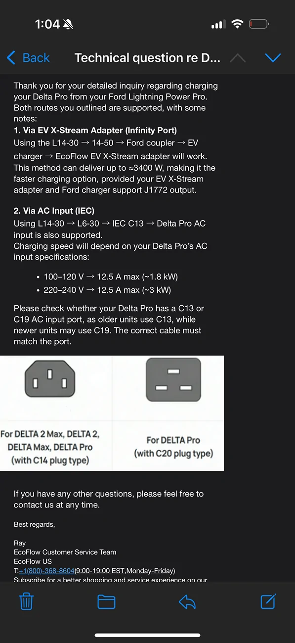

FWIW, this message is from Ecoflow Tier 2 technical support. Hard to say how how much they know about the Ford Power Pro, but at least this suggests the DP won’t fault. Also, the charge rates are informative.
Ford F-150 Lightning Charging home battery backup system using F150 lightning IMG_8067

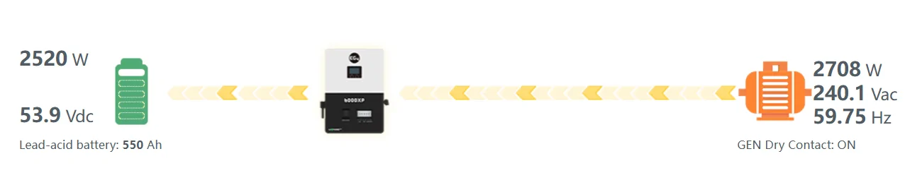

I run an RV shore power cable from the trucks 240v outlet to the generator port on my EG4 12000xp. Works great to charge my batteries, I have a home solar setup using mostly ecoworthy stuff, trackers, panels, batteries.
This inspired me while I was creating a similar off grid solar setup at my house. I opted for the 6000xp and have it connected to two EcoWorthy 280Ah 48v batteries. I wired the female end like you commented and plugged in the other end to the bed outlet. The EG4 seems to recognize it's there, reporting voltage on each leg and the AC freq. But I can't seem to get it to charge the batteries. If you find a spare moment, could you let me know which settings you configured to get it to work?

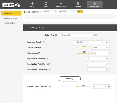

I don't know much about the 6k other than what's obvious, here's a couple of ways I can do the batteries, one is eg4 native and the other is Solar Assistant.
Ford F-150 Lightning Charging home battery backup system using F150 lightning 55042499317_9745c57c29_w
Ford F-150 Lightning Charging home battery backup system using F150 lightning 55042499992_5a31354306_w
2,532
2,689

I hadn't switched the EPS toggle to ON....lol
Charging batteries from PPOB is awesome
