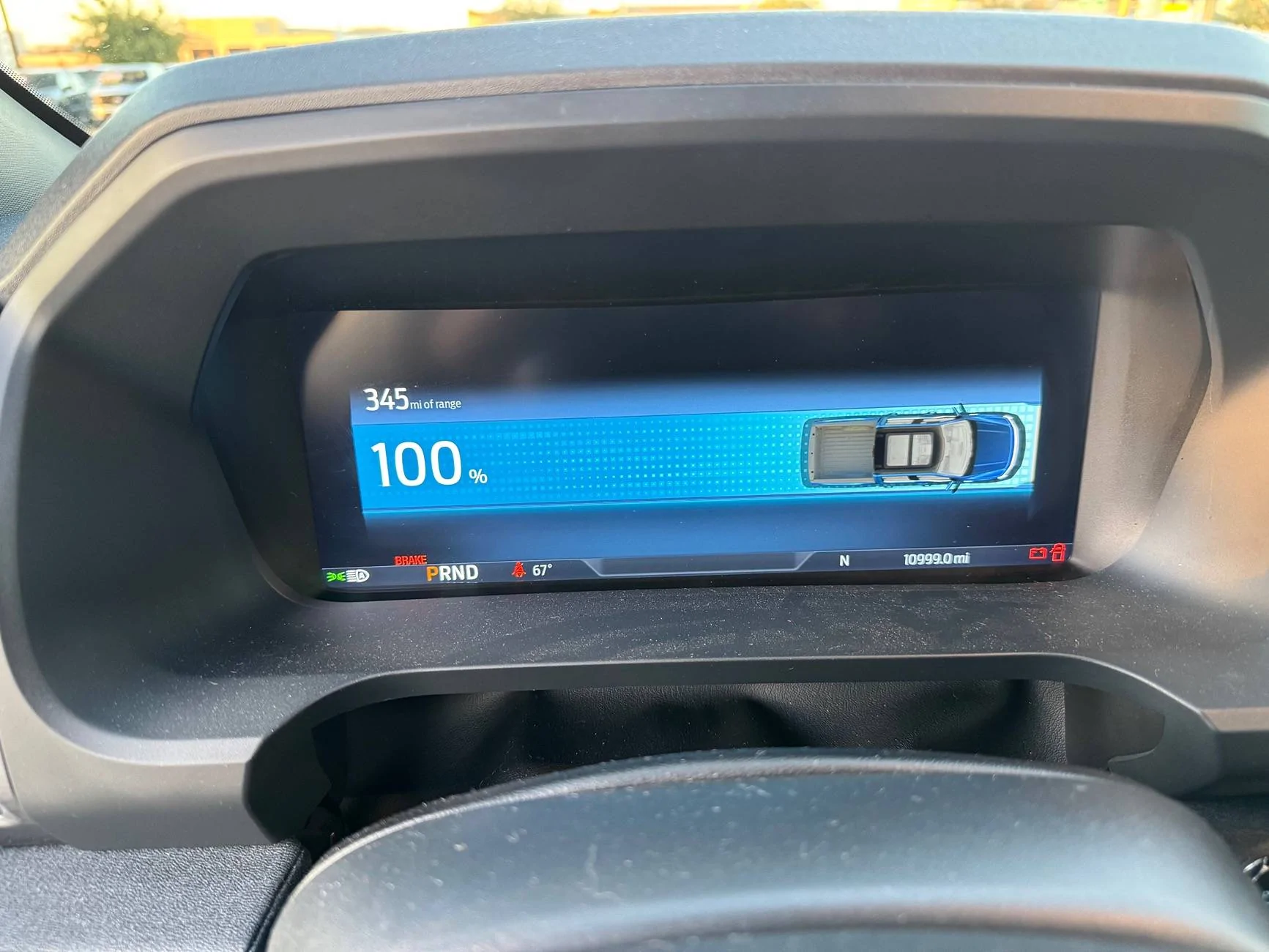

My truck has been repaired and is back home!
Ford F-150 Lightning Charging station not detected IMG_1194
I guess they added a couple of energizers???
(345 miles range)
