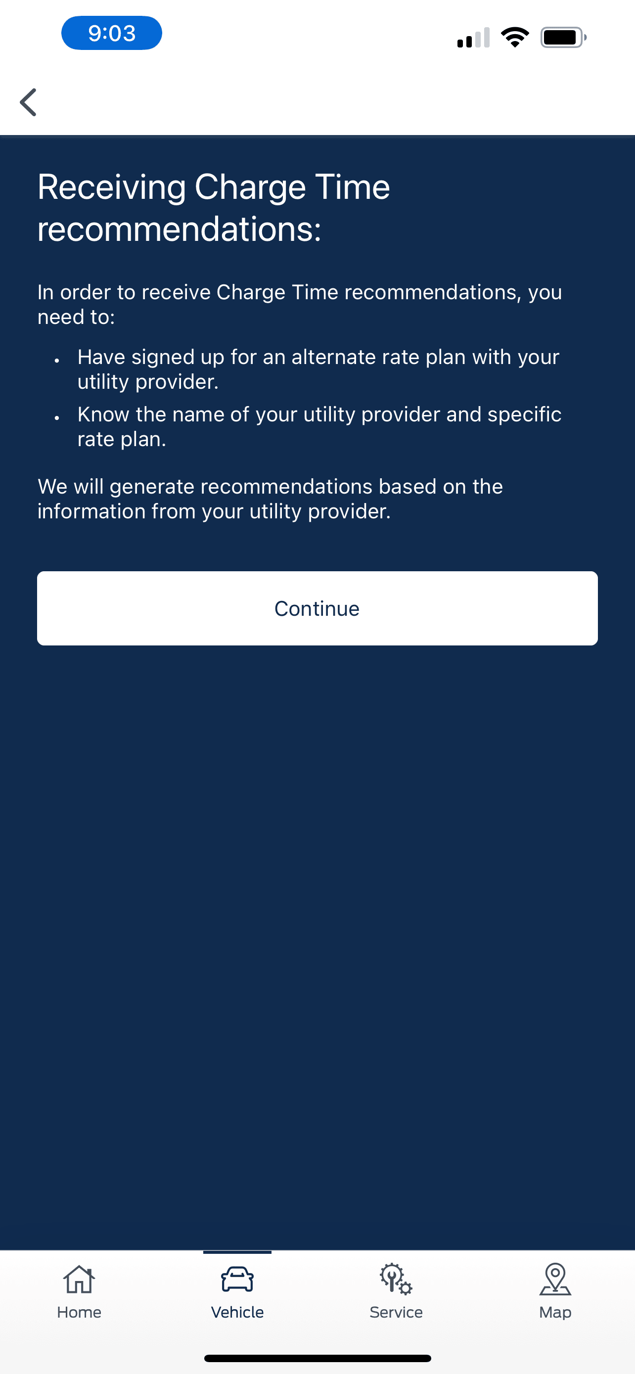

can improve the high voltage battery's longevity by delaying the start of charging and setting a maximum charging limit. We recommend you set your preferred charging times to be at least 2-3 hours after your typical plug in time. This allows the battery to cool before charging begins.
this is an interesting tidbit for us newbies, esp because nowhere else does Ford appear to mention this in connection with charging schedules. EG in the FordPass app, where it offers to guide you through good times to charge, the only metric it suggests is utility cost curves
The reality is that MOST utility discounts are overnight, and that MOST that utilize these discounts plug in hours before, and the vehicle waits to charge. Therefore, these people are inadvertently following the advice.
The other reality is that MOST vehicles aren't getting batteries heated up to the point that they need to cool off before charging or suffer noticeable impact to battery life.
And, the true reality is that a huge percentage of EV owners a) don't read the manual, and b) just plug in all the time and charge to 100%.
