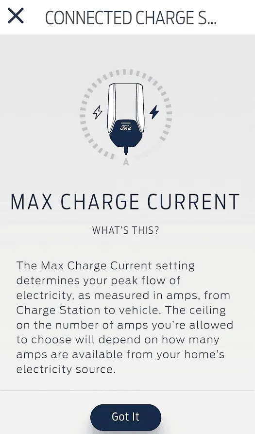

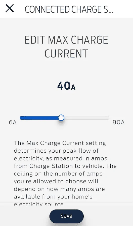

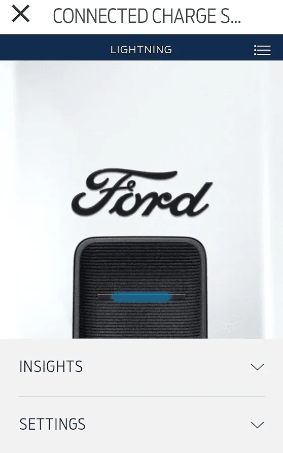

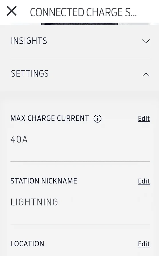

Ford allows us to adjust the charging current flow limit below the maximum 80 amp setting for the FCSP via the Connected Charge Station tile on the FordPass App under "Account"
Just to advise those pondering alternative EVSE's, the FCSP and Connected Charge Station via the Fordpass app allows reduction of current draw to slow the rate of charging to a slower pace, I did a quick test this afternoon, cut my rate from 80 amps [effective rate has been 75 amps historically] to 40 amps.

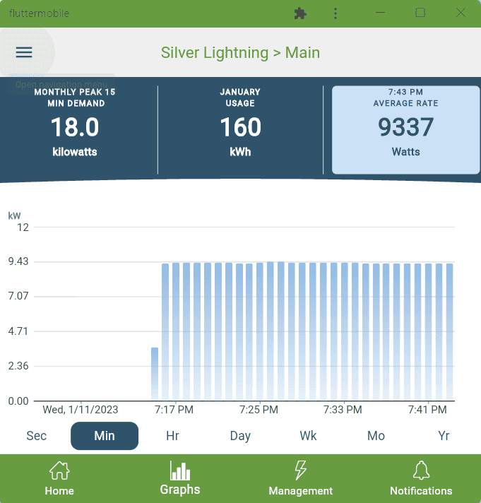

This graph from my Emporia Vue2 confirms the reduction in current flow with the new settings, 9327 watts at 240 volts is approx 38.86 amps.
