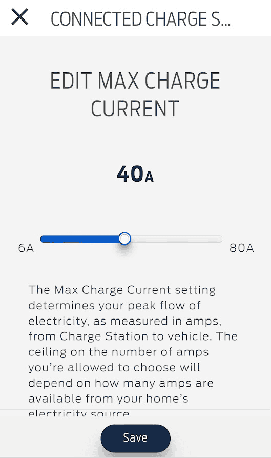

PSA: You have to actually SAVE your charge limit for it to take effect.
After you click to add a charging location, and find the location where you want to set the limit, you need: to go into that location, set the charge limit, THEN click the button at the bottom of the screen to continue to the charge schedule page for that location, and keep going until you get to the "save" button.
If you set it to 90% and then just hit the back button, you didn't do anything.

You have to scroll down and save your new setting. Best to set it in sync. Settings then charge then set one time charge and save.

No problem, that's just one reason why your charging isn't stopping where you want it to.
You can also set your max charge in your Ford pass app under vehicle, charge settings, preferred charge locations, then click saved locations or preferred locations, select a location, set your max charge level & save it. These are suggestions, not opinions of your intelligence.
