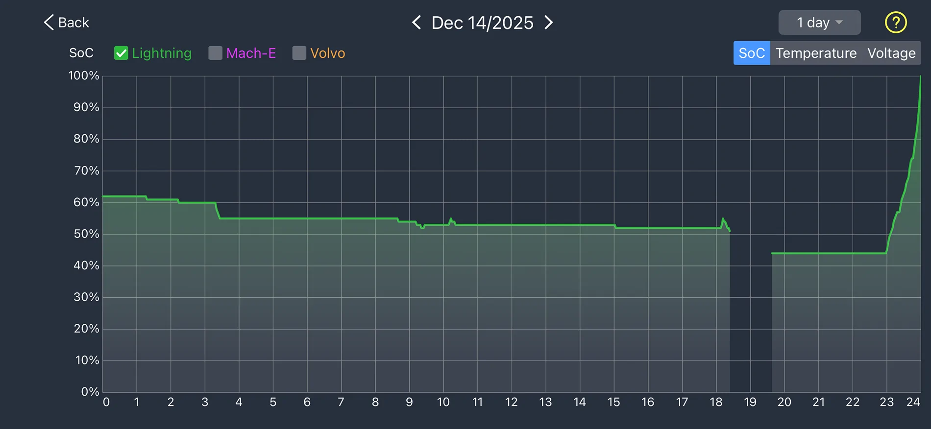

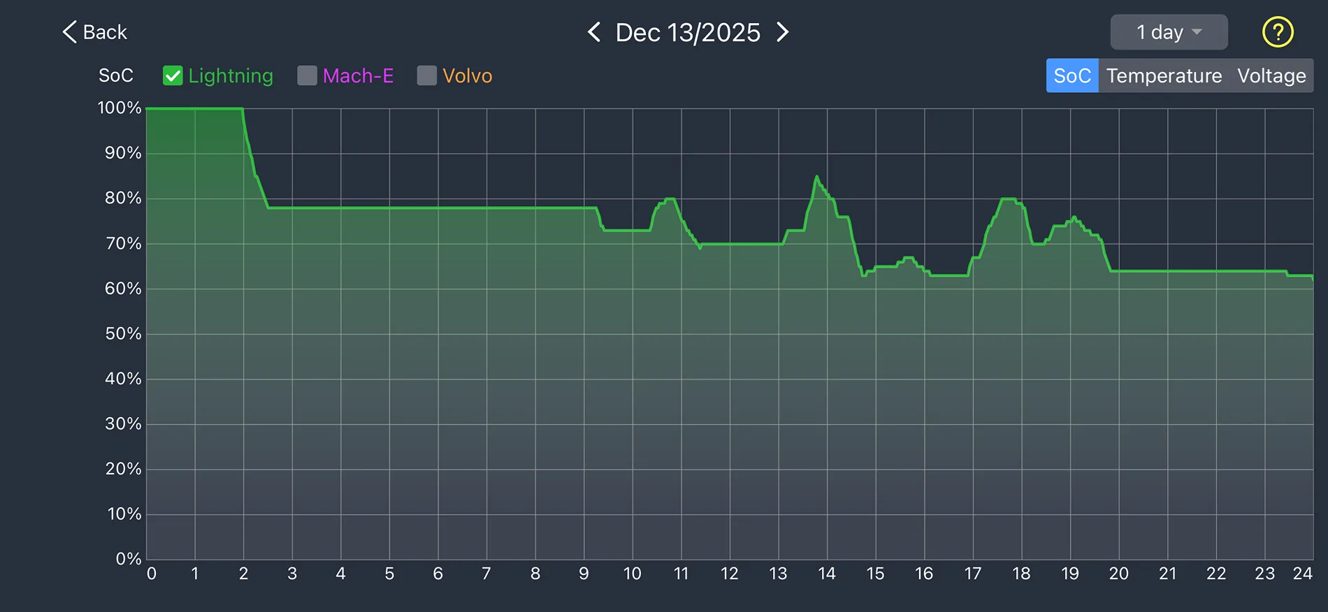

I track mine daily, although I don't have anything recent for more than a couple of days but here is an example of my 12v discharge rate. The jumps on Dec. 13th were driveway shuffles which involved uplugging, moving the truck and replugging, but over 2 days the 12v dropped below 50% SOC and then charged when the HVB charge cycle kicked off at 11pm Dec. 14th. It would probably been about 3-4 days without the driveway shuffles.
Ford F-150 Lightning Charging while parked & unused (over 2 weeks) in cold weather - recorded data 1766938486118-wy
Ford F-150 Lightning Charging while parked & unused (over 2 weeks) in cold weather - recorded data 1766938960865-2r

No, HA polls the Ford servers. Older version of the HA/Ford server combination used to cause a refresh every poll. It seems they have fixed this. I installed the older version and had to uninstall it since the constant polling caused the 12v to discharge.
Looking at your charts more closely, it seems the 12v charger is kicking on with the HVB heat cycles. Thats why it stays at 100% when the heat cycles are frequent. It slows down and your 12v SOC drops when the heat cycles are less frequent. Dec 25 drop of 7% over 8 hours without a heat cycle is normal.
Conclusion: The HVB heat cycle kicks in the 12v charger (this is good).
With a healthy 12v, and without the heat cycle, the truck normally loses about 15-20% in the first hour or so then slows down to about 10% per day if left undisturbed.
