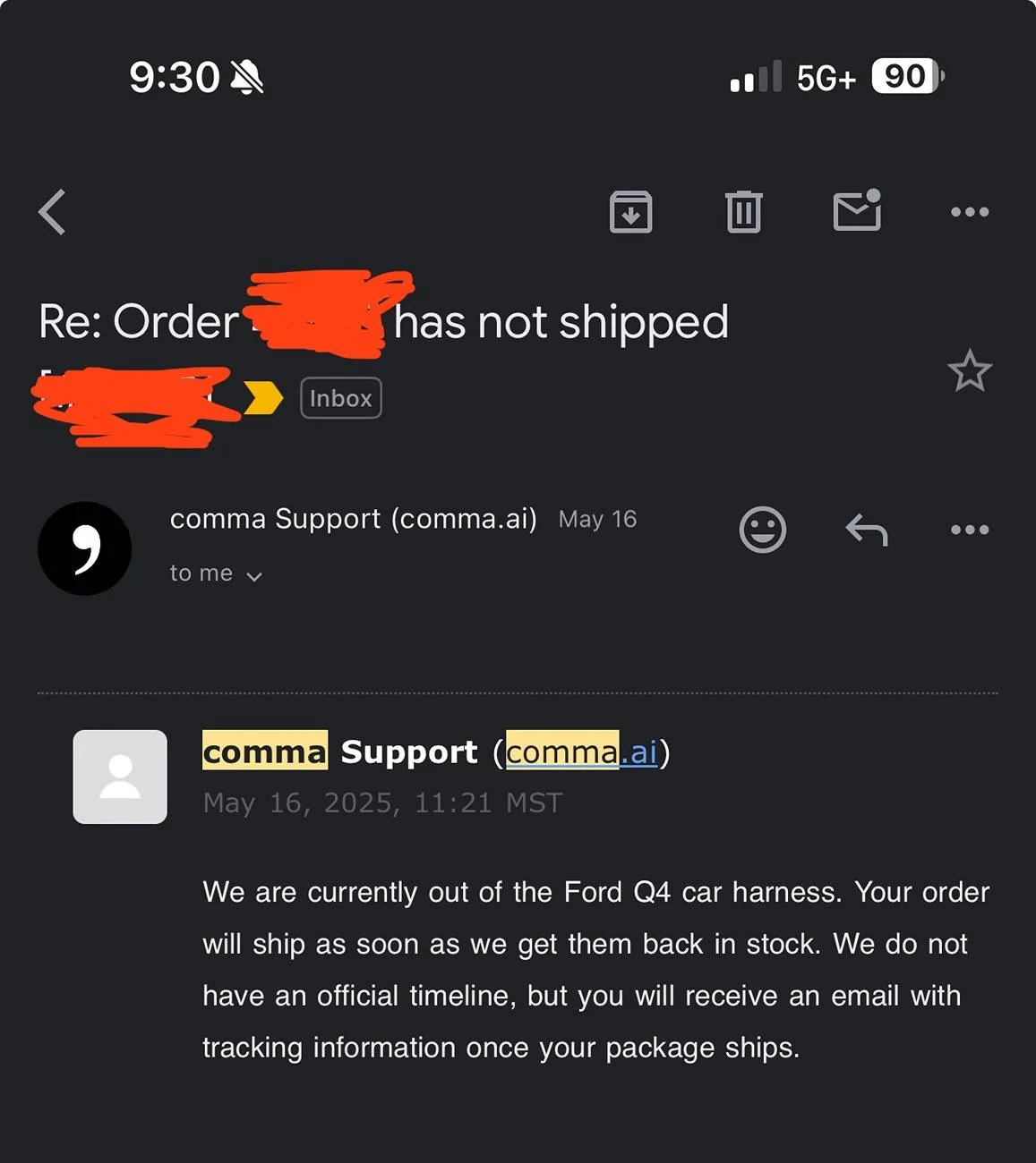

Hey everyone, excited to find out that the comma 3x potentially works on the 24s. I have an April built 24 lighting lariat. I’ve got my 3x in my Santa Cruz currently and I’d like to move it over. After doing some reading it seems like it may be best to just buy a pre modified cable? Is anyone aware of someone selling one? I currently do not own a Ford wiring harness.

this is good news. Seems like it should be a simple fix. I did order one from comma about a week ago but they are unfortunately out of stock. So I'm patiently waiting. I was pleasantly surprised to see a package at the door on Wednesday. Then a bit disappointed when I found out it was only the ODB C cable and my extra set of mounts ?.
I have a few spare Q4 harnesses. Send me a DM.
