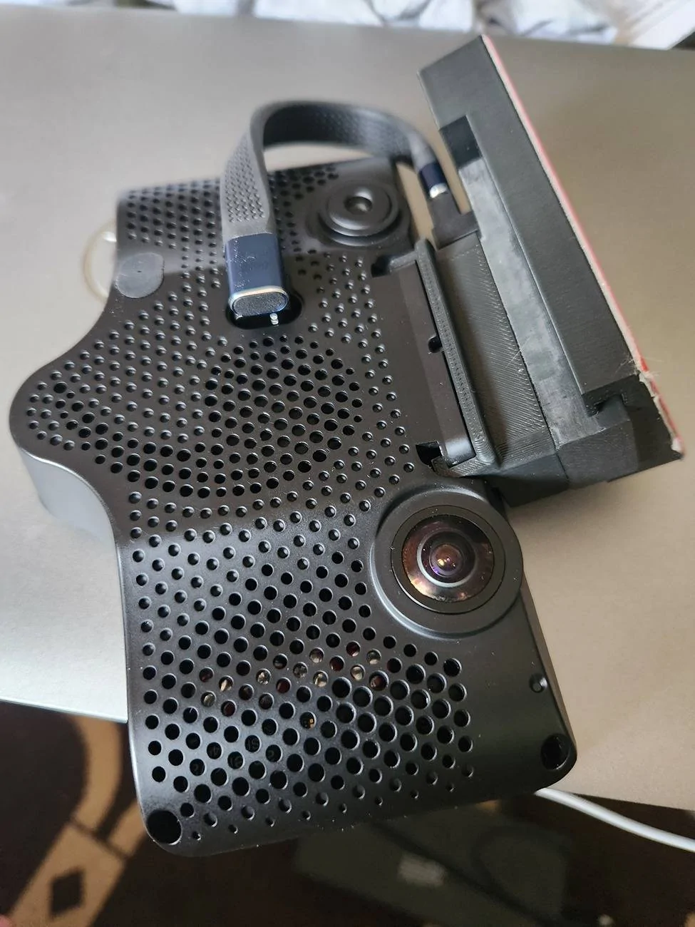

On that same topic, what do ya'll think about this case design? Don't judge the print quality as its set for draft. But in terms of the coloring. The blue is intended to indicate the direction that should face the truck.
Open to notes. I was just thinking this allows an obvious indicator for those looking for it and is hidden when installed. (Granted it likely won't be visible).

Smart. Trying to think of a better solution but I can’t at the moment.

My original design was going to add a lightning bolt to the truck side, but id need to buy smaller nozzles for that and this felt less extra lol.

Funny you posted this. I was just thinking that adding a lightning bolt and a comma on the corresponding sides would be an option but didn’t know if it was feasible. I know pretty much nothing about 3D printing.

That was actually the original thought for these. They are just small for that level of detail. I would have to buy the .2 nozzles to see if it is actually a feasible idea. I have managed to get some really fine details from my printers, but I kind of started thinking about how little these will be seen once they are installed. I plan on putting mine inside the mirror housing.
