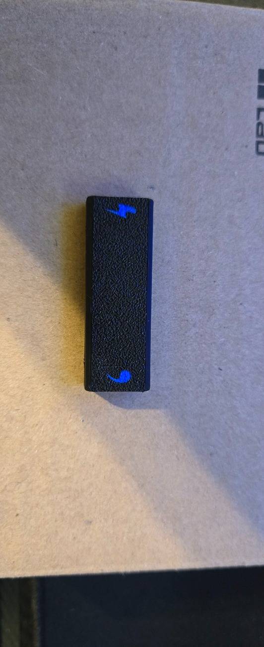

Funny you posted this. I was just thinking that adding a lightning bolt and a comma on the corresponding sides would be an option but didn’t know if it was feasible. I know pretty much nothing about 3D printing.
So.. im apparently not good at not being extra.
