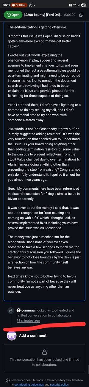

Woops, about to join @Ajzride in comma time out.

That escalated quickly.
Yeah, he's a bit mad. From what I gather, he does deserve credit for pointing us in the right direction. He's just not advocating for himself in the most likeable way.
I honestly didn't see the whole github thread before I started working on the issue. My starting point was this thread and the harness mod.

Just went through and read that thread....they seem totally normal and calm. :censored: Assuming that wasn't a regular poster here or in the discord?
Glad to see the update from a few pages back regarding the '25s working.
It's not someone I have seen outside of the Github thread. It sounds like he might pop up eventually if he knows about the Rivian folks talking about his (784 word) reflection explanation.
