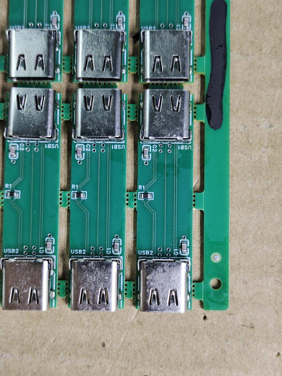

Quick and dirty way is to solder a 360 ohm resistor between pins A-10/A-11. Can be placed on harness or comma end.
Amazon.com: minidodoca 2 Pcs USB 3.1 Type-C Male to Female Test Board with PCB Board 24 Pins 2.54 mm Double-Sided Socket with Dupont Wire for Date Line Wire Cable Transfer (No Pin Header) : Industrial & Scientific
Chanzon 100pcs 1/4W (0.25W) 360 Ω ohm Metal Film Fixed Resistor 0.01 ±1% Tolerance 360R MF Through Hole Resistors Rohs Certificated: Amazon.com: Industrial & Scientific

If you can't solder, just let us know and we can help make you one. We can't really root cause it until someone can pull DTC's from an affected truck and see what may be keeping the AC down once the reflections (Startup Errors) are resolved.

I want to put out there that I don't mind making the breakout board for those that are having issues that are making their life miserable (Lack of AC in the summer or other issues outside of normal startup issues).
The reason I cut off the boards;
1. I would rather you guys only have to install a proper solution one time.
2. The final versions are just about ready to go out (fingers crossed).
3. Between work and family, I was finding it more difficult to get the boards made quickly and mailed out when I said I was going to.
4. I ran out of the ASA that doesn't cause my wife to complain about the smell :lipssealed:.
I won't be upset if you guys offer to make boards for people that need it right now either. Similar to what @PJnc284 was kind enough to step in and do.
The breakouts were originally intended to fill the gap between the initial thought and the final design, unfortunately we have been running into more issues that are making them more of a necessity.

The AC issues is very very recent, 3 reports in the last week, none before. We are still working on the root of the issue. I suspect either a slight change in design by Comma (they are bad about being slow to update their doucments so you know something changed) or a bad batch of hardware from comma. The USB Resistor coupler is the best solution for the errors, and hopefully the AC,, but they are not quite ready yet. You can make a DIY temp resistor until those are ready, especially since no one wants to go without AC for a few weeks.
The breakout board with the resistor did the trick. No warnings and the AC works great. Thank you for the quick response! I’d love to get one of the couplers you guys are making. Also, I’m going to attempt to 3D print both the mirror mount and window mount. I just picked up a 3D printer so it might take a while to get it printing smoothly especially with ASA. Does anyone sell the mounts if I have a hard time?
