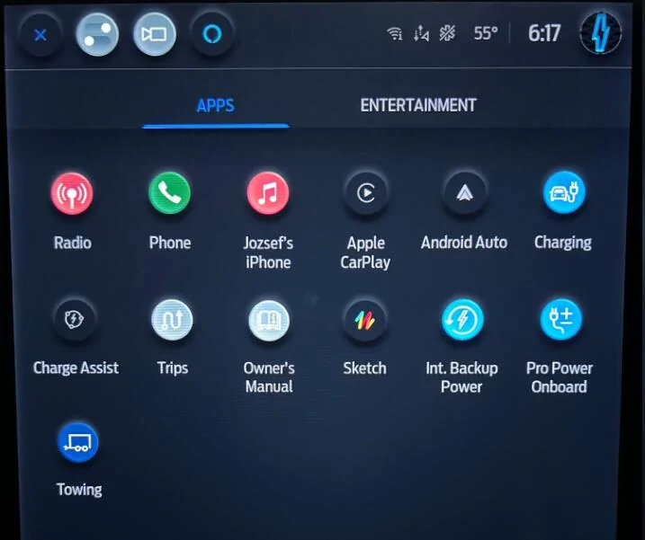

I wanted to use it, but to my surprise, the app icon is gone, and I’m not able to launch it.
Don't want to insult you, but there has been at least one person report it missing because it wasn't here anymore:
Ford F-150 Lightning Connected Built-in Navigation Renewal 1733446984194-y3

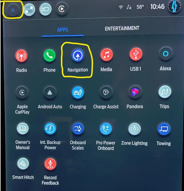

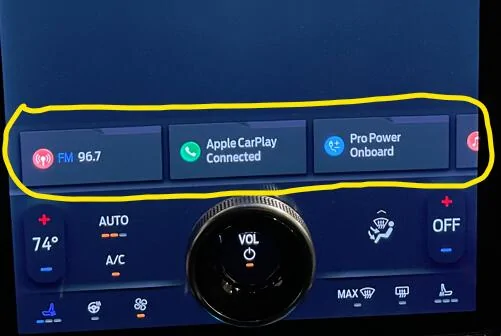

This is the most recently used apps bar and my Nav frequently disappears from here. I have to choose it again from the Apps screen (Home icon at the top):
Ford F-150 Lightning Connected Built-in Navigation Renewal 1733447031571-vo
Sorry if you know this already but believe me, it has happened.
Even when I say “navigate home,” Alexa says the app is still loading and to try later.
That happens to me if I ask within 1 minute of booting up sometimes. That voice is Ford Assistant, not Alexa.

I wanted to use it, but to my surprise, the app icon is gone, and I’m not able to launch it. Even when I say “navigate home,” Alexa says the app is still loading and to try later. It used to work before, but after getting my truck back from the dealer in April, I noticed the navigation was missing. They couldn’t figure out why it’s gone and told me to wait for the next software update that might fix it.
I don’t use it too often, but it would still be nice to have it just in case. I thought I’d wait for the next update, but despite it being more than 90 days since the last update, I’m still waiting.
It's really not there...
Ford F-150 Lightning Connected Built-in Navigation Renewal 1733460808176-9m
Yes, it's Ford Assistant, sorry for mixing it up with Alexa. And it's not related to booting, it's doing any time when you ask it.

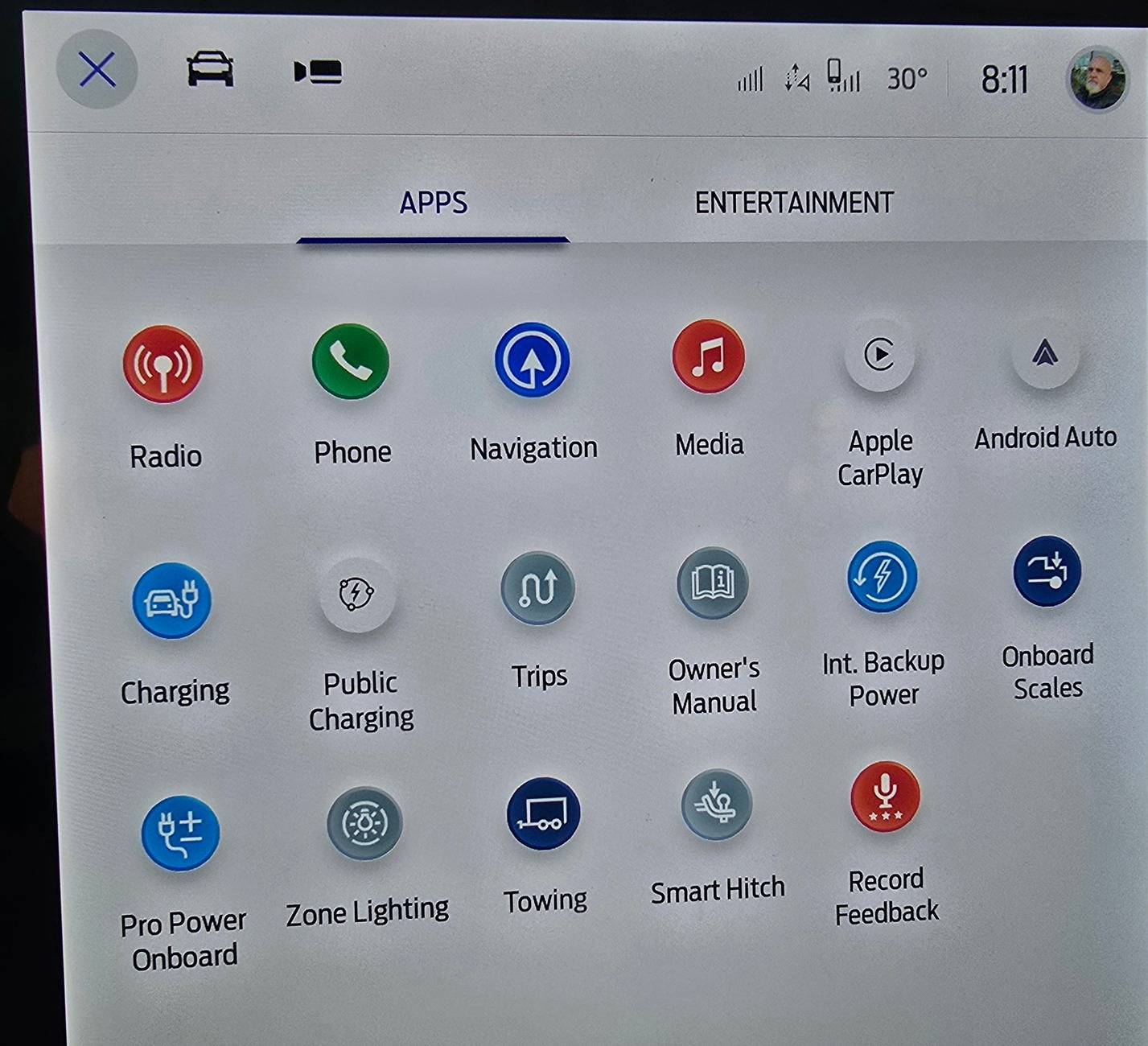

They screwed up the reprogramming of the replacement hardware, bring it back insist it be fixed properly, demonstrate on another Lightning on the lot how the software UI should look on the APPS screen.

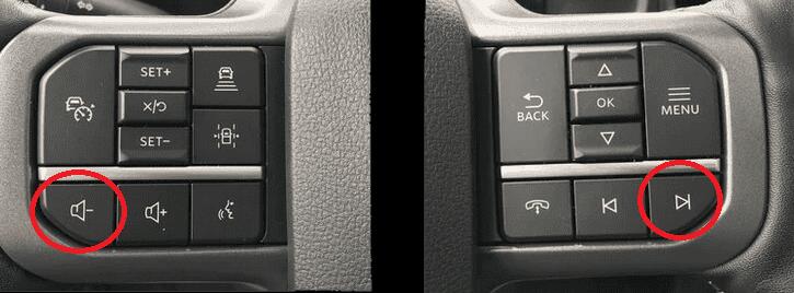

Some things to try before taking to dealer.
1. Do a Sync reset. Hold steering wheel Volume + and right arrow until it reboots. These are the two outer buttons on the steering wheel controls.
