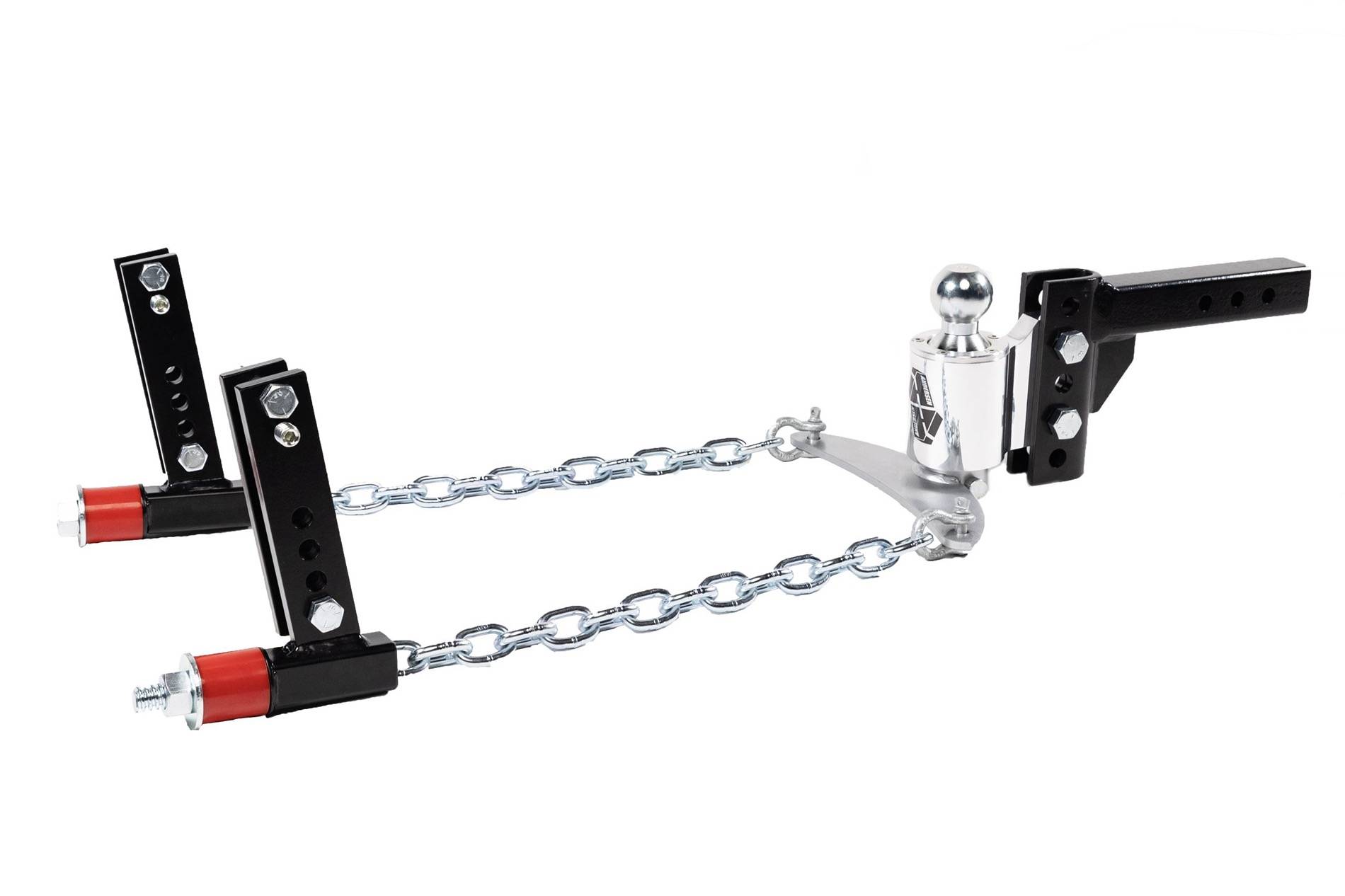

You are towing a 10,000lbs load with a 7,000lbs truck. To control this setup you need to lock them tightly together, other wise the 10k load will control.
The only weight distribution hitch I have experience with is the following.
Ford F-150 Lightning Crazy Surging WDH
I had to carry a 4' long pipe to engage the 1200 lbs (capacity) bars. Once you have properly setup the hitch, and the sway bars you will have a solid system and the truck will feel like your driving a locomotive.
