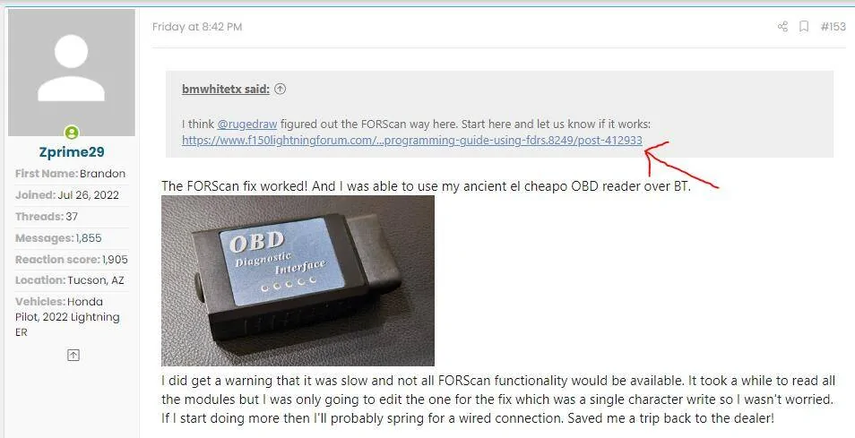

The link I quoted in my post takes you to the instructions. I installed FORScan, connected to BT dongle, opened FORScan, connected to truck and performed full scan (this took a few min due to slow speed of my cheap OBD reader), backed up the appropriate module, made the change, power cycled the truck, FIXED! All in, spent maybe 15-20 min.
Ok,
When I click the link I get an article and a picture of the dongle and nothing else.

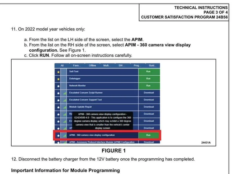

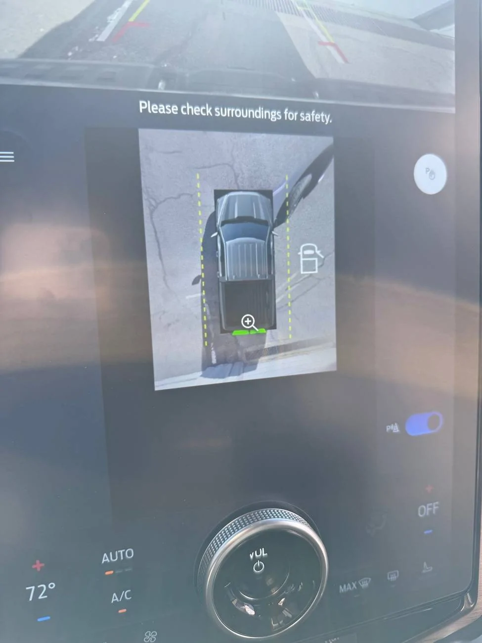

Just had 24B56, 24P24 and 23C38 done. I didn't have any issues prior, but decided to knock them out to get the better BlueCruise functioning. Turns out 24B56 is a real pain. Tech didn't know a lot about what to do, so I had him abandon the mobile install and drove the truck in. Took 2.5 hours, and they almost installed all three successfully. Two things to make sure they do:
1. Provide power to the 12v throughout the entire installation process.
2. Do NOT skip Step 11 (or perform it incorrectly) for 24B56. If your 360-camera looks like the
attached image with the black borders, it's wrong. Be sure to have them redo with the correct steps and it will fill the screen and have new camera buttons on the left.
Hope this helps!

I took mine to the dealer a week ago (9/30), and thanks to a forum member here, I know that they attempted to perform the update 4 times on 10/1, each time while getting warnings that the 12v battery was below the 70% minimum and apparently without hooking up the power supply correctly (suspicion is that it was in charger mode rather than voltage maintenance mode, if they even connected it at all). They then parked the truck for the rest of the week. And yes, I printed the CSP and put stars next to both the first step of connecting the power supply and the step to configure the 360 camera view.

Of course they didn't run the 360 camera config so I have the shrunken camera view issue, but I will do the Forscan fix for that myself. The last thing I want to do is take it back to them.
