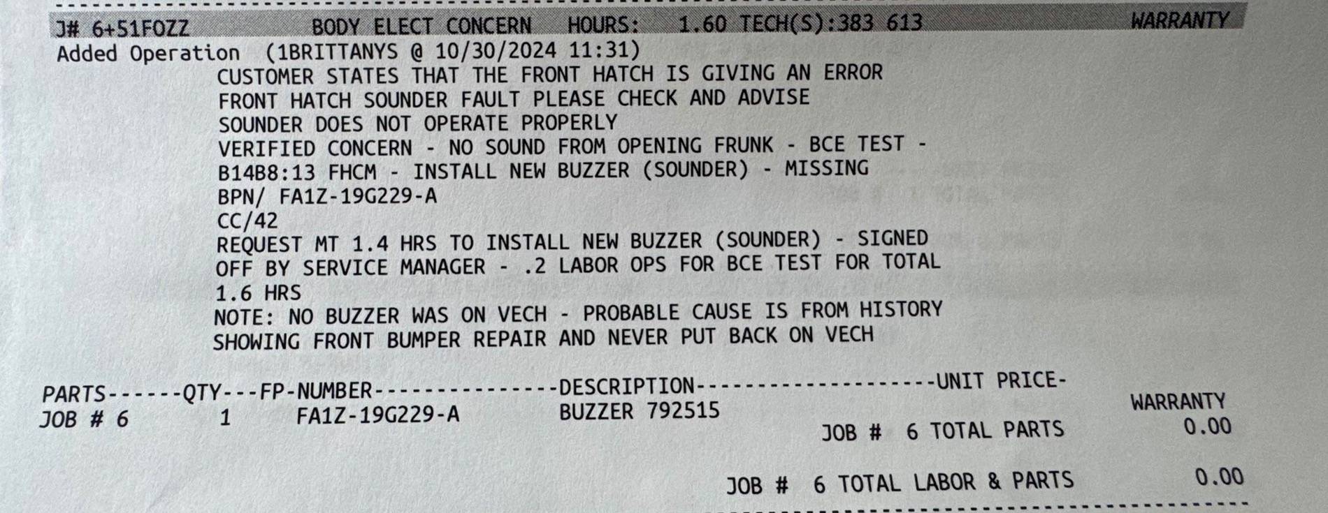

Unless the sound is coming from elsewhere, It appears they also reinstalled the frunk speaker that I removed nearly two years ago because I now have a loud beeping every time I open/close the frunk. :rolleyes:
Wsl346
Dec 20, 2021
498
762
Austin, Texas
My dealer performed this CSP for me at the same time as the parking sensor CSP.
Ok. So this is…interesting to say the least. I just got around to looking at the paperwork from my truck’s visit to the dealership.
Here is the description of work performed related to the re-installed buzzer.
Ford F-150 Lightning CSP 24P24 Front Hood Control Module IMG_2036
First off, I never stated that the front hatch is giving an error, nor was this ever discussed with me. I found out on my own when I opened the frunk post-service only to hear the dreaded triple beep that I thought I’d never hear again. So is this how dealers make money off EVs, by making up warranty claims??? Maybe this is fraud, maybe it isn’t but it seems to be right on the line.
Second, and most concerning is the last note stating “Probable cause is from history showing front bumper repair”.
What history could they be referring to? I bought my truck new with 14 miles on it and have not gotten into an accident. I did remove the front license plate holder that they installed and there is a small dent in the bumper from where it was placed. Could they be looking at that and making an assumption or is there a dealer assessable history that shows a repair was done on my front bumper?
