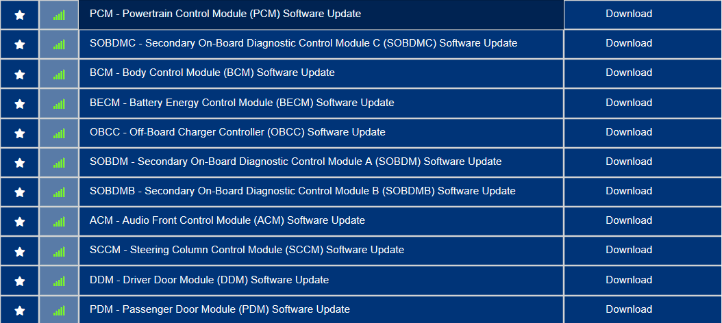

@THX1138 Here you go:
Ford F-150 Lightning CSP campaign and updates 1703826490277
I'm convinced I'm never getting the SOC% update 😭. I've gotten soo many letters in the mail about over the air updates needed per my VIN 1FTVW1EL8PWG03685 might have to waste a day at the dealership for them to not do anything. I have only received 6.4 as of late.....
Your list is below:
Ford F-150 Lightning CSP campaign and updates 1703826793346

Thanks. Dumb question: will the updates listed remediate the two CSP findings?
I kind of think the APIM update will address the PAAK issue? But I'm not sure about the high voltage battery CSP?

2,304
3,217
Thanks again.
I took before and after pics from the tech's FDRS screen when he did the battery CSP.
EDIT: It updated PCM, ABS, SOBDM, SOBDMB, SOBDMC, BECM, GFM2, . It did not update BCM, FHCM, SCCM, WACM, CMR, DDM or PDM.

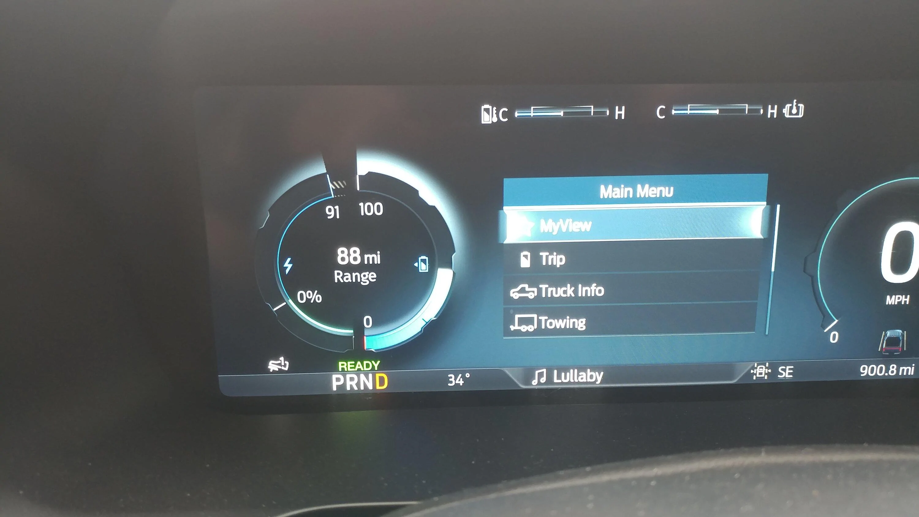

Good afternoon,
I just came from my dealer who performed work on these two CSPs. My dash shows 91% on the left side? Does this mean I have some failed batteries? Wondering what I should do next? Thanks

Good afternoon,
That’s available power, not battery capacity. It is probably just reduced because the batteries are cold. It should come back. Also, after some of these updates it can take a while for the cells to rebalance and the software might be limiting you until that process completes. It just means it might take 4.5 seconds to get to 60 instead of 4.
Ok, that's good to know. I knew I was going to have this maintenance, and I was waiting a few days before charging it. I read to charge to 85%to maintain optimum health... I'll give it a few weeks to see how it recovers. Thanks!
