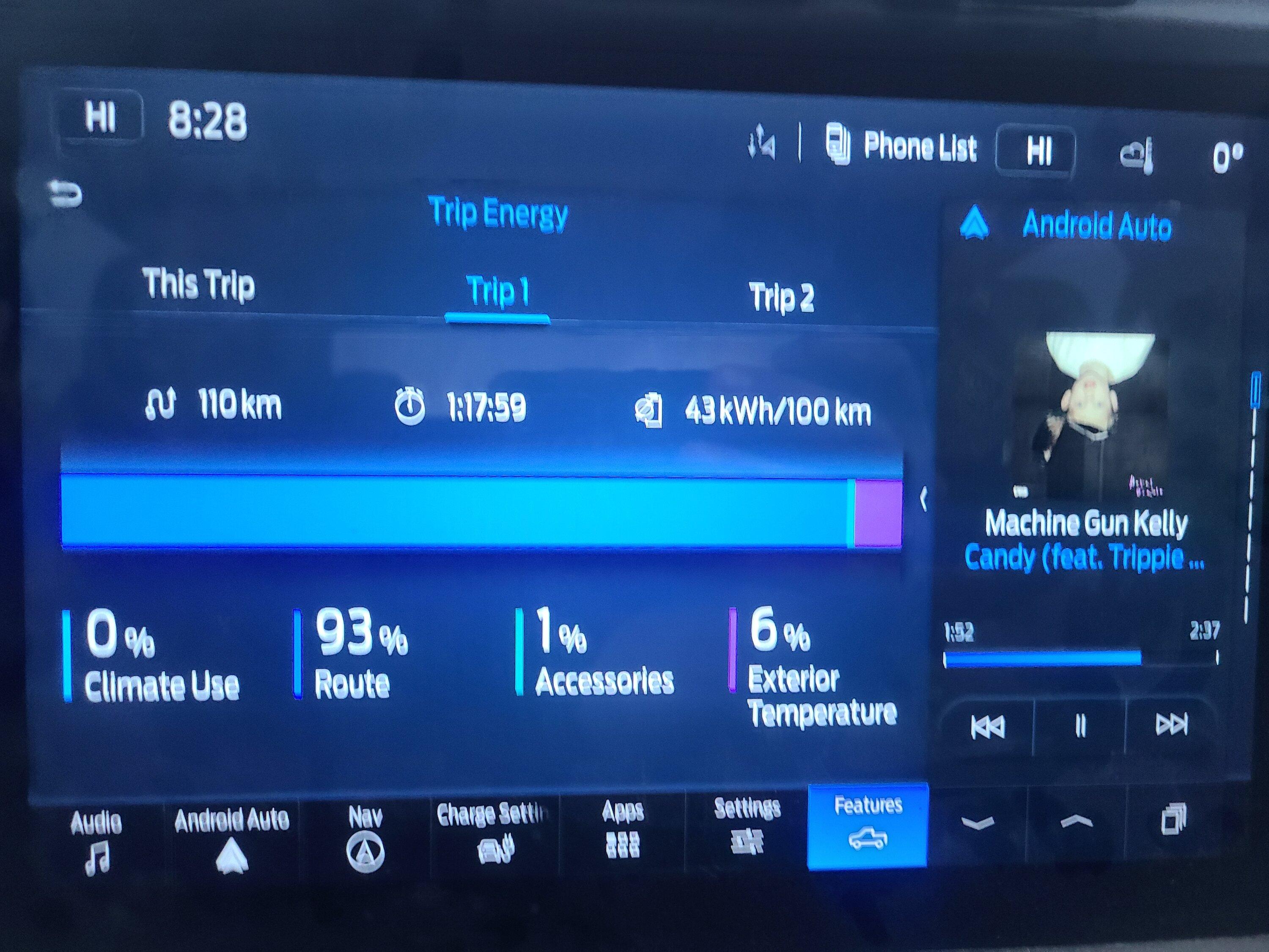

Look at the temp in the top right. I'm also towing a trailer
