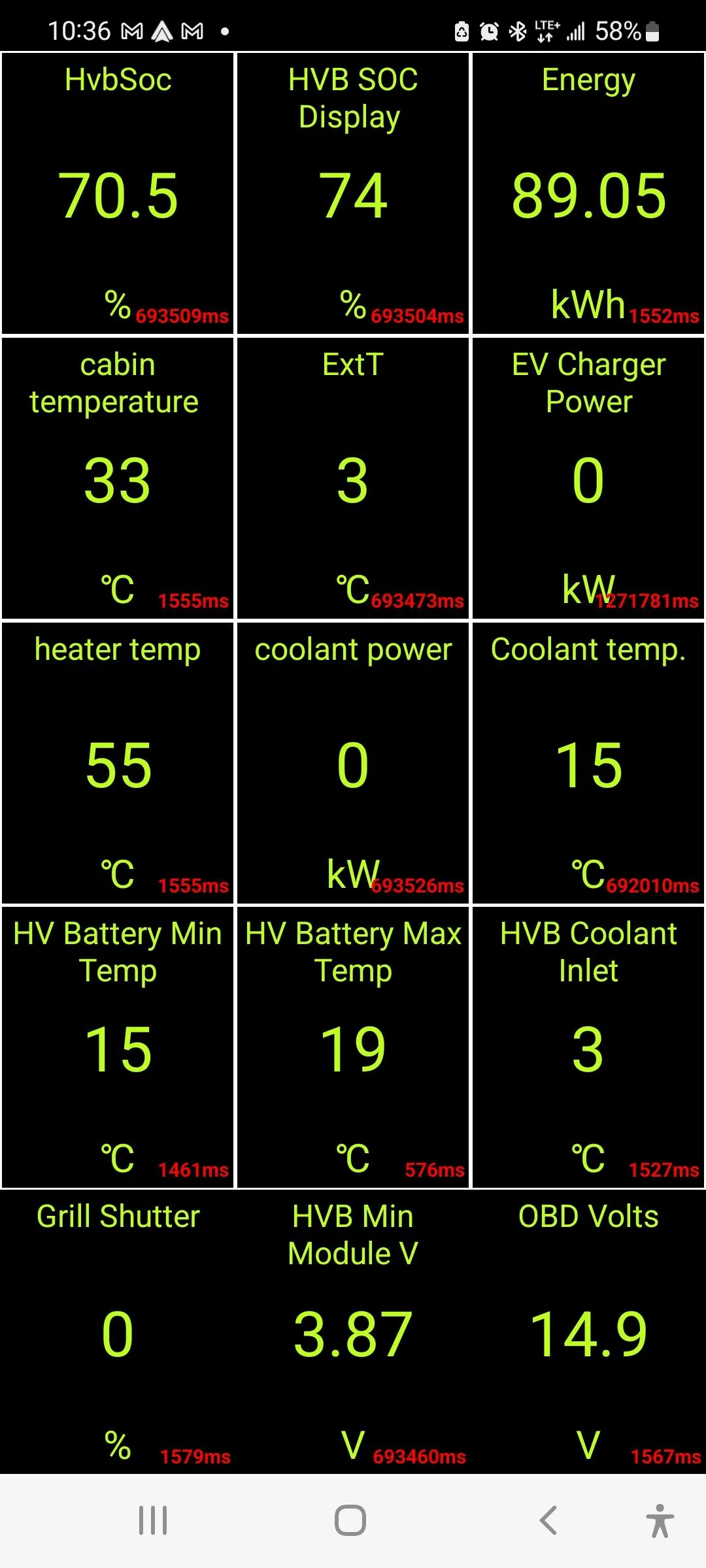

It's amazing look at cabin temp vs exterior temp 0 loss to range I'm doing 320wh/km which is typically better than my summer driving

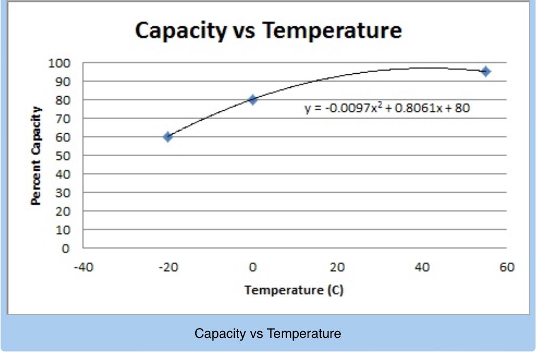

Typical EV battery temp vs capacity curve:
Sure, preconditioning mitigates this initially, but on a long trip, battery power will be used to keep the battery comfy.
What was the source of this chart? What does "capacity" represent? Why isn't up to 100% at any temperature?
I would like to read more about this topic.

It costs me less to travel in freezing Temps with the heater than without. I can also dcfc way faster with it, saving money in canada because our dcfc charge by the minute
It’s from a paper on energy storage for a wind turbine published by The Rochester Institute of Technology.
A Web search will yield plenty of info.

Hey I got a webasto glycall heater so if the truck is turned off and the battery decides to heat it will aid the heater in heating the battery. It's fantastic at dcfc because it will heat the battery almost 50% faster. The coolint in temperature is only +20 of the battery temp so it doesn't get to hot. So if battery temp is at 0 the coolant temp will be at 20. Where normally it's +15 without the diesel heater. I spliced in right at the heater core. The hose I spliced into I purchased new ones to bring back to stock if I need to. Next year I'm going to remove everything and permanently mount it in the battery Co.partment. and the diesel tank in the box.
So when you ask for heat in the cab the ptc heater will turn on and heatbyou
When the truck is off the ptc will heat the battery. The diesel heater will work with both
