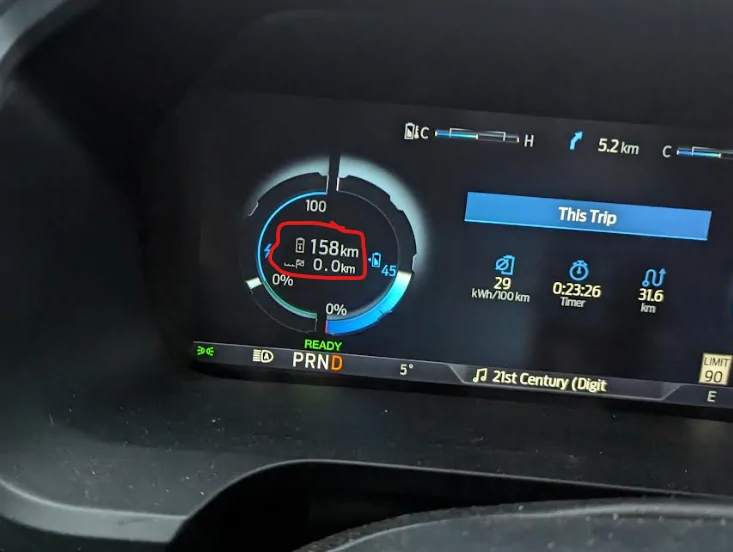

Hey all

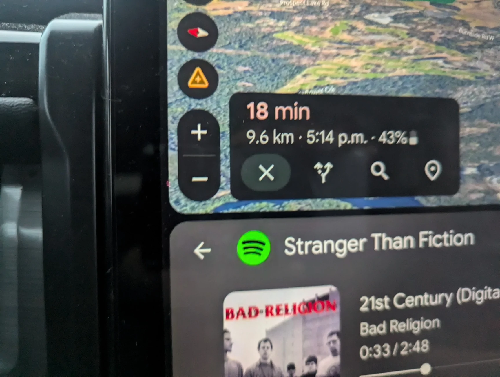

Have been noticing this lately in my truck, wondering if others have as well. When you set a destination via android auto, on the main screen it is still accurately showing the distance to arrival, time to arrival, and % SOC at arrival....but on the dash, it shows a 0.00 km distance to destination.
It knows I have set a destination, as it has the little checkered flag there and the area for that distance to show below the estimated remaining range, but the distance to destination is 0kms.
Any ideas here? Anyone else have this?

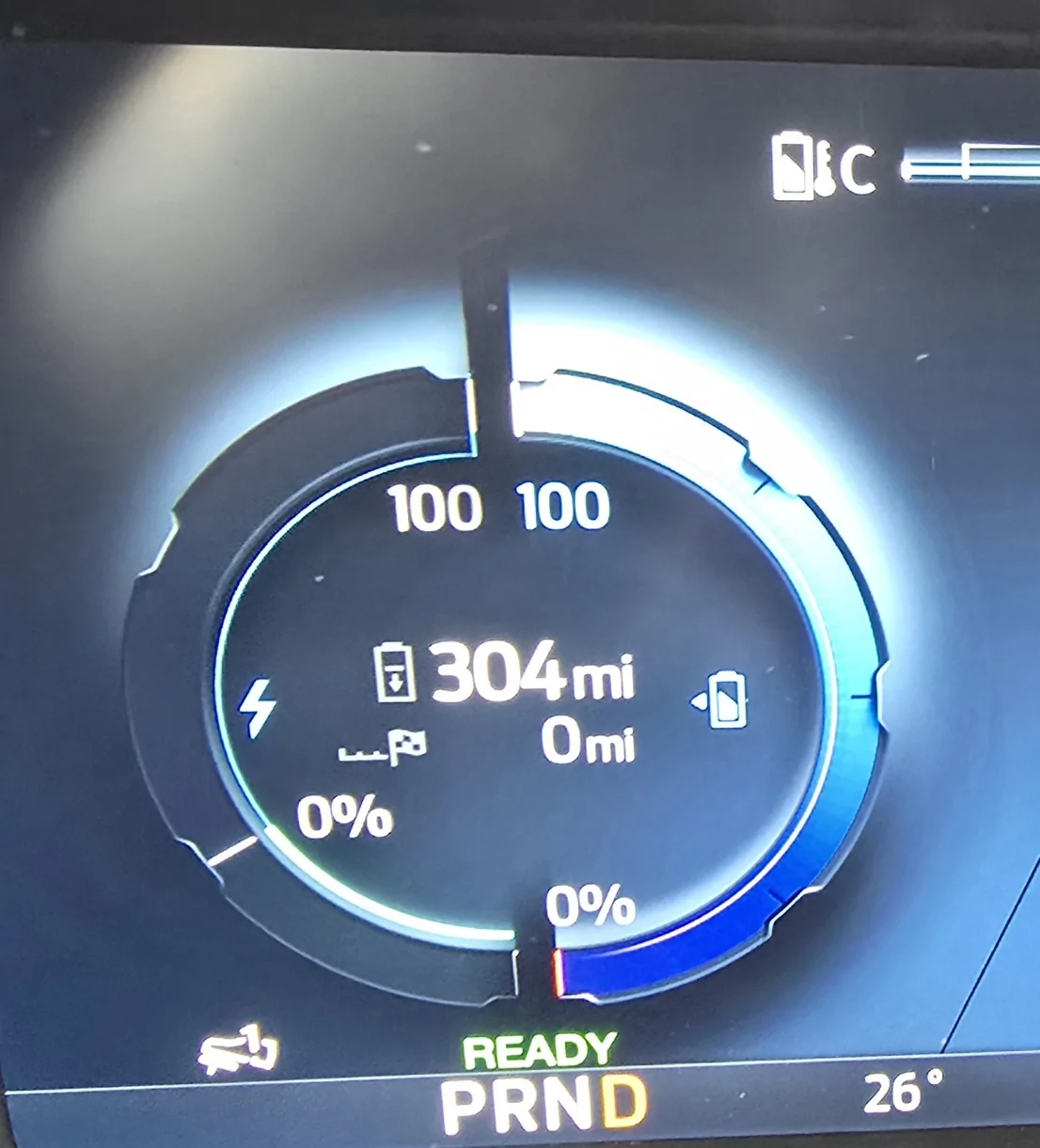

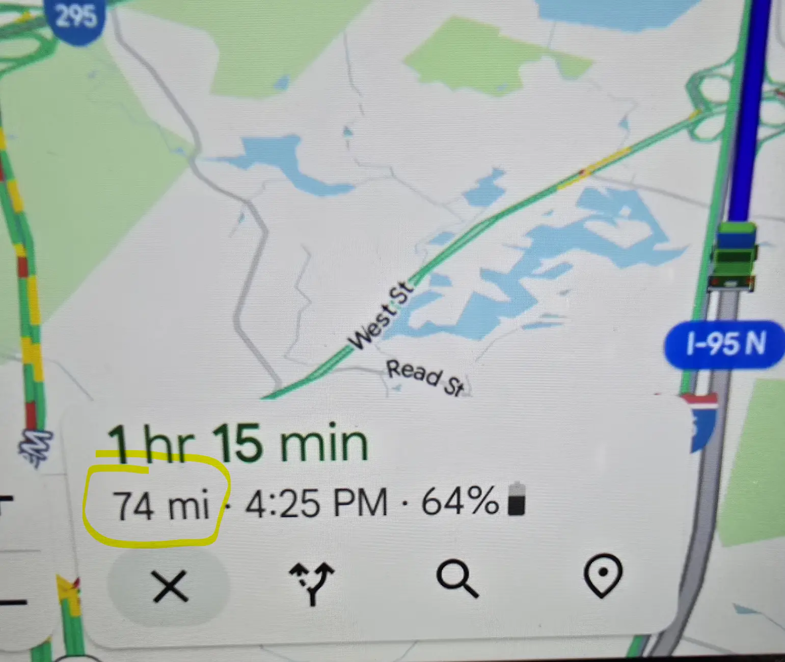

I noticed the same issue on recent road trip, the distance to destination with Ford Nav is fine but missing while using Google Maps you need to look at the center screen quickly before blue cruise catches you with averted eyes, it would be nice to have that on the IPC.
I wonder if this is a failure of android auto / Google maps integration?

Almost certainly. Carplay is OK.

It's a Google maps bug from a recent Google Maps update.
Uncheck "Auto update" (Auto update off) in the upper right menu while in the Google maps app of the play store. Then click the "uninstall" button. It will ask if you eat to "delete all updates", click yes. Reboot phone when finished.
You can't uninstall GMaps unless you are running a custom version of Android, but you can delete the updates. After you delete the updates, everything will work again.
