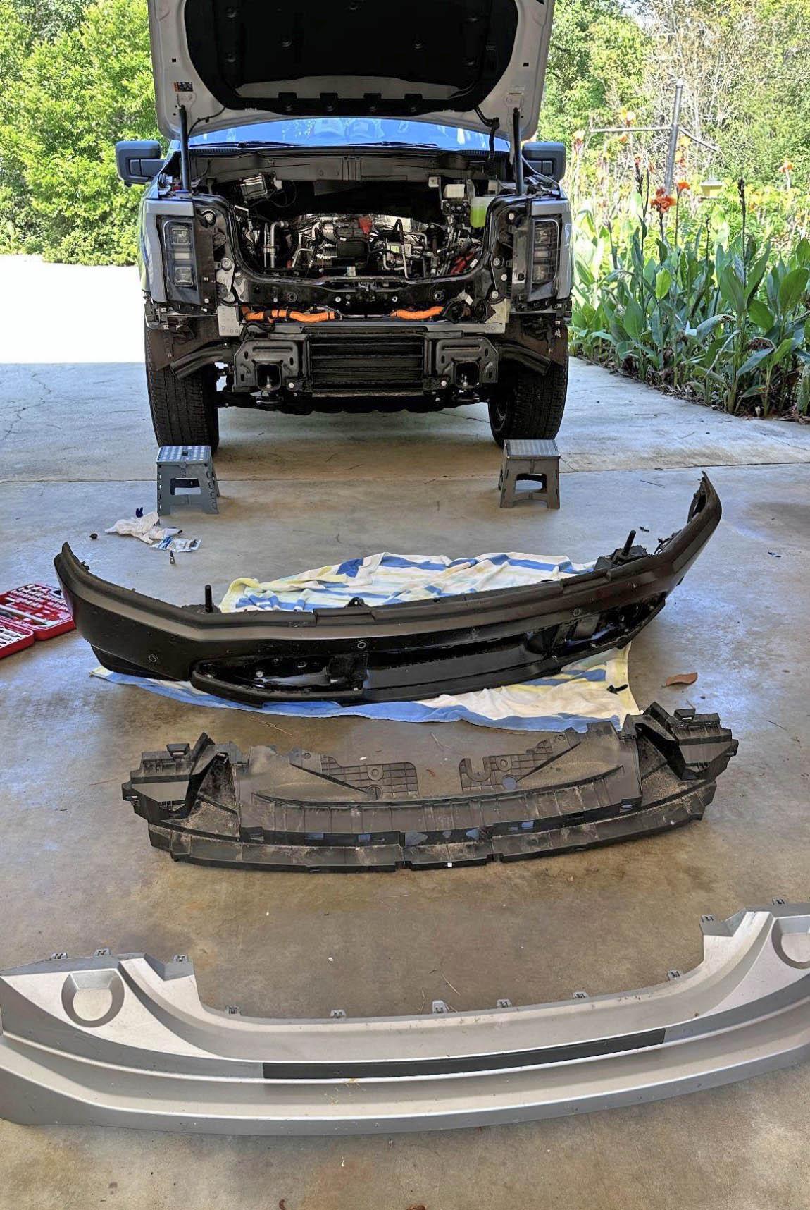

I added Adaptive Cruise Control(Radar and wiring harness) with Lane Centering to my 22 Pro today. I also disabled the frunk 'beeper'...nice!
I'll hand creds to Brotato and others at https://www.f150lightningforum.com/...keep-alert-to-2022-f-150-lightning-xlt.14870/ for others finding success ...
I updated my own programming PAGES(Attached) for an easier way to look at how the code thru Forscan, my first time, too.... you may need to hunt and peck around the Forscan screen to get to the module you are looking for, etc.
After ordering the parts from a local Ford dealer, and while paying $160 more than other options, I felt that using 'direct from Ford' parts might be best: total $760
I started this morning at 7am, and had the truck operational with the additions at 12pm lunchtime. I took the last programming steps, while running around 45 to 60 for a few miles, without the bumper, and other un-needed parts, until I knew it was a success.

I now see where the horn(s) is located.
How may things had to be removed to get there?
[the Frunk 'Beeper' speaker/sensor]
if you know exactly where it is located, it's possible that you could reach up into the interior of the bumper, passenger side, and disconnect it... but... it's fairly simple to remove the front painted facia, and the bumper 'cover' to get to it below, although I'll bet you might have to remove the frunk tub(which is easy) to most easily get to it...sorry.
and YES! I am very much enjoying the 'no more beeping!' when opening and lowering the hood : )
