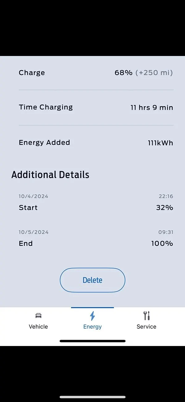

Am I charging to the maximum capacity of the battery and using the buffer?

So I charged to 100% on my 2024 Lariat which reportedly has a usable capacity of 131kWh and supposedly 143 kWh of actual physical capacity. Did the software get glitchy and charge the entire capacity of the battery? My Chargepoint EVSE correlates with the Ford’s readings.

104 kWh delivered per the Chargepoint EVSE. So I’m led to believe that the Ford app is accurate.
The question is why was the Lightning reading 32% state of charge but then allowed the truck to add 111 kWh of capacity?
This suggests that the entire battery is somehow 163 kWh instead of 143?

There seems to be a select few of us that are having a software bug where the bms is not able to properly detect or display the true SOC. Mine is currently showing around 5-8 kWh off of true dSOC. This weekend I am doing the deep cycle bms calibration to see if that helps since I normally don’t go low in the pack thanks to @MickeyAO hard work.

YES, I'm not trusting the latest V of FP when it comes to energy statistics.
Others have observed similar, but 20 KWH of overhead is not accurate for the 68% increase in SOC

The lightning battery is nominally 143kwh, but that is at a set voltage per cell (say 4.15v) and a set discharge voltage (say 2.5v). If for the specific use case of the battery Ford decided to trim those numbers to 4.10v and 2.7v then the USABLE capacity will be less than the nominal capacity.
This is NOT a buffer.
Ultimately Ford may limit the max voltage or min voltage for a variety of reasons. It could be warranty. It could be fire risk. It could be Cooling capacity. And it could be because it's sold in Texas and 4.15v in a Texas summer would damage the battery.
I just offer this as caution as the capacity of the battery is whatever Ford decided to set their voltage limits at, not the sticker on the outside. That is also not the same as a buffer

My real question is why am I delivering 111kWh to charge the battery 68% (from 32-100)? That would imply I have a max capacity of 163 kWh. That doesn’t seem likely, so the next most likely problem is my state of charge reading is incorrect when I started at 32%.

Because the information you are being given is not accurate.
There are quite a few threads on this. I think one guy even had 250kwh delivered to his truck.

That was me 256 kWh! I said that I must’ve gotten the battery expansion OTA update.
Sometimes there’s just a glitch(or gremlin)!
