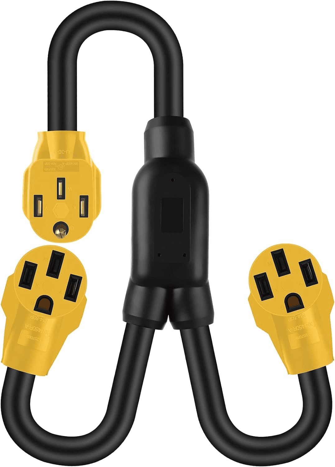

so, I dove deep into what it would mean to try to have some solar power output, even while the grid is down: with microinverters, my choice of how to do my own solar, you will always need them to have 'power' in order for them to then OUTPUT power.
the simple answer is: your LIGHTNING ProPower
so, for instance, even if you use something like the GenerLink, or PG&E's version of it, you are using the ProPower output to then 'power' the home...yes. That will work just fine. But, for the
MicroInverters to continue providing any SOLAR output, you would also then need to simply provide an external NEMA 14-50 outlet, maybe even the SAME one you use for your truck, for your power to your microinveters.
Now, yes, this gets a little complicated, as you would need your own method or design of how to 'plug in' those solar panel/microinverters to this outlet, but that is what they need to 'see' power and continue output. A length of 8awg SOOW cable with the appropriate male and female plug ends would work, depending on the length of the run.
Ford F-150 Lightning Easy way to safely access backup power for home and free (for some PG&E customers) 1718976053516-w4
One method would be to also use a 240v 'splitter' Adapter: meaning that your truck is providing it's 240v 30amp output to TWO sources, your Generlink, AND your MicroInverters, at the same time.
Now, your solar output continues, and takes some of the need of the LIGHTNING's own ProPower output for the home, as long as, of course, the SUN is out, and the solar panels are producing as much as is currently being used by the home. The ProPower then only 'supplements' that need, when clouds arrive, or nighttime comes.

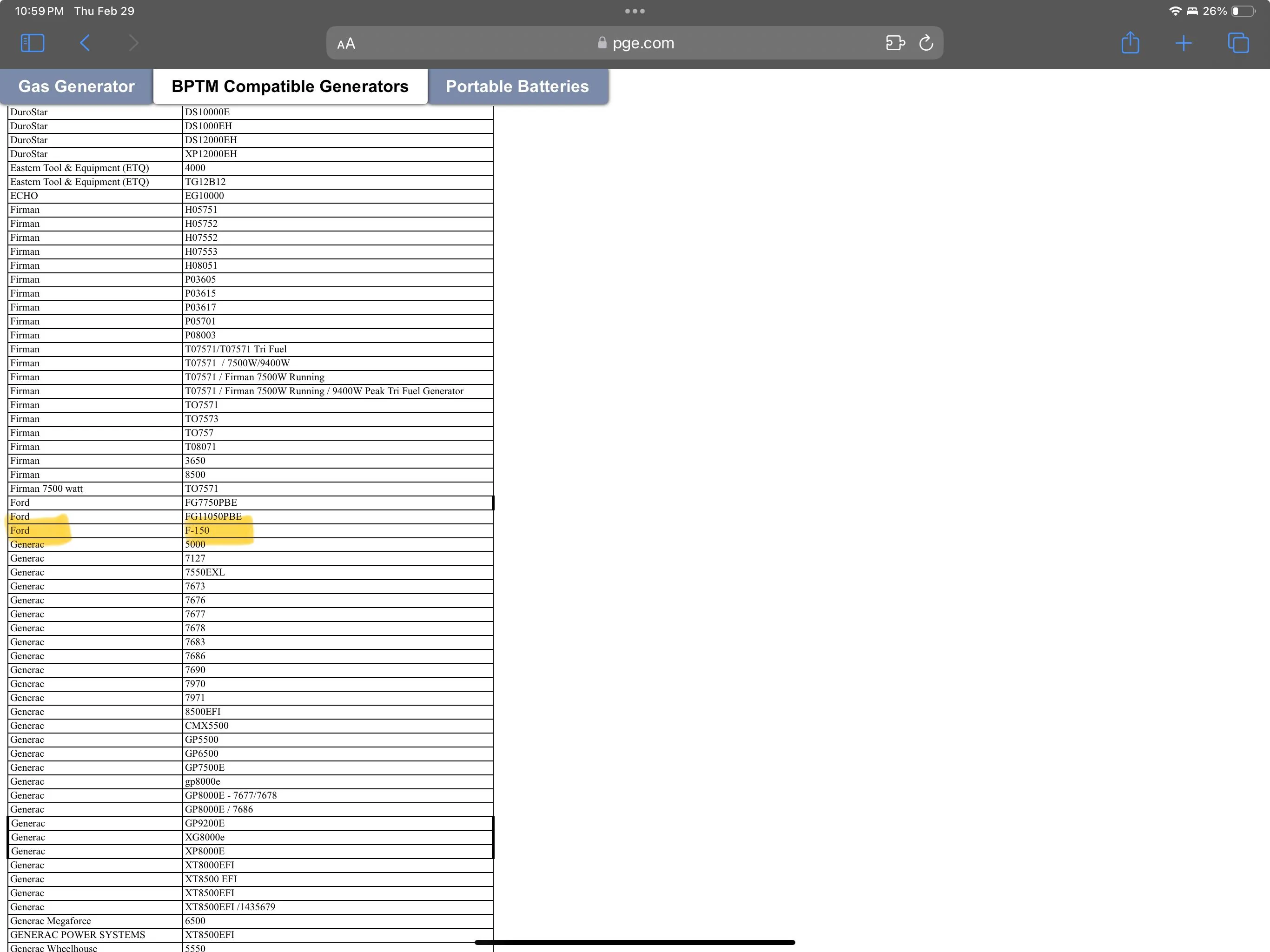

Thanks for sharing, but I don't see how this test can work. My understanding is that the generator (or Lightning) connector isn't even active unless the transfer switch has activated, which can only happen when grid power goes away. There is no user way to make the grid power go away as it's all on the PG&E side of the meter. Am I reading something wrong in the test? Thanks

To Wsh68 and frautumn,
Yes, PG&E has a list of acceptable generators and fortunately mine was on the list...so I was approved. But, as was stated, no one ever confirms your generator....not PG&E or the installer. Also of note, I did see a list of compatible generators elsewhere that specifically listed the Lightning as NOT compatible. But we know it seems to be as it worked fine for Wsh68 and me. Also of note, I was not home when the installer came. It took him all of ten minutes to install! He left the cord and a hook up instruction sheet on my front porch. Perhaps they've changed the supplied cord since Wsh68 got his, because mine fit just fine into the ProPower outlet (no adapter or smaller plug needed) when I used mine last week for our small outage. I was very pleased with it all! Now my Lightning IS my backup power source and with no cost to me! Perfect!

I can't find this particular approval list. I download the spreadsheet on this page, and it doesn't list the F150:
https://www.pge.com/en/outages-and-...gram.html#tabs-60f688bab6-item-3e8eade954-tab
PG&E is a pretty massive organization. Who knows what corporate cluster could be going on internally…. if I were in your situation, I’d not apply using the Lightning (I didn’t). I applied as did my neighbors and my mom using my Yamaha generator that is on the list. There was zero ā€prove it!ā€ or proof required and the electrician that installed it Never even alerted me to him arriving, installing or how I would use it. I just happened to be home when he did it all and asked a bunch of questions. My Mom was not and he just left the directions and her cable on her entryway. One big caveat. If you sign up for this backup system, you may be eliminating your chance for a free Tesla PowerWall. A few of our neighbors snagged that freebi. I’m pretty sure if they offer that program again that I’m disqualified. My $.02 and hereā€˜s my generator I haven’t fired up in 2 years now. (fuel drained and probably going on Craigslist next year).
