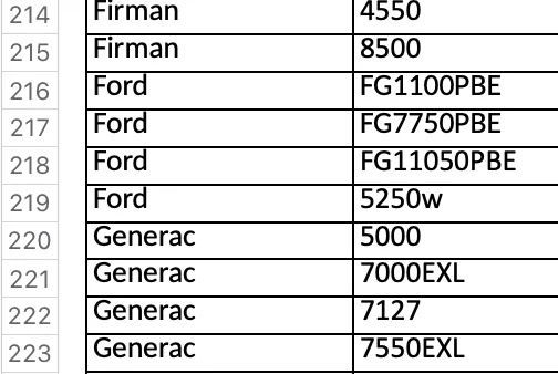

Nice! It was definitely NOT there about 6 weeks ago when I filled out my application. The spreadsheet at that time (ending in -5) had these entries for Ford:
I just got an email from PG&E to apply for this program, and the drop-down list for Ford is exactly as shown, with no option for "F150".

What even ARE any of the Ford options? Are they Ford generators?
All I know is that I did have one of the generators listed so signed up for the program....a PG&E contractor came out about three weeks later and installed it in about 5 mins and left the cord and a basic instruction sheet (no charge). I was not home but saw it happen on my security cameras. No one (of course I wasn't home) asked to see my generator. I don't think the installers care in the least what equipment you have.
