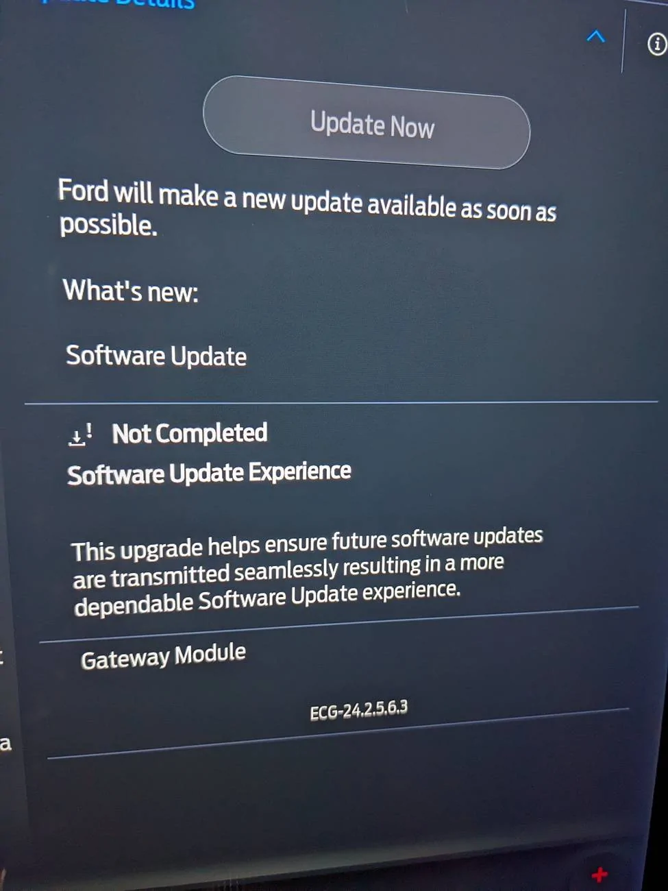

'22 Platinum received ECG-24.2.5.6.3 on 12/4/24.

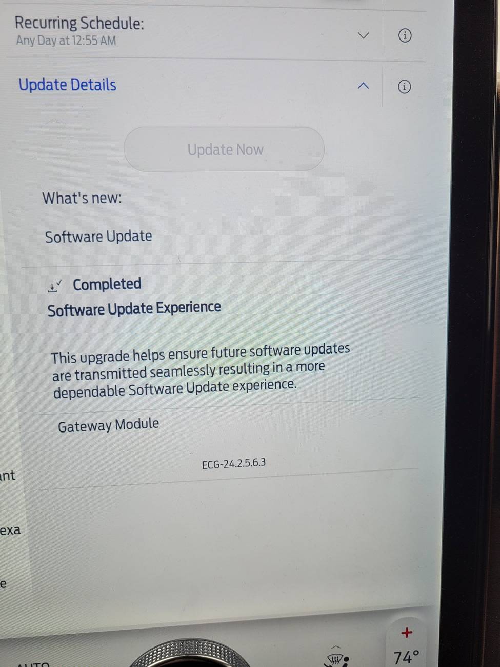

This installed successfully on my truck yesterday while on a short road trip. First update since 9/6/24.

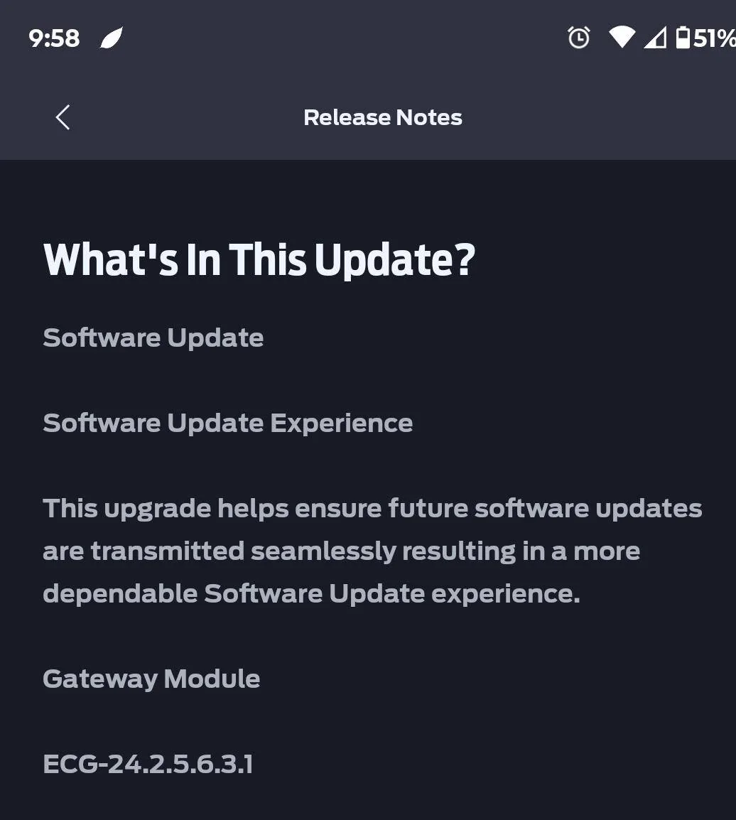

The software update experience is more comforting when the version number is longer?

Maybe an issue was discovered and and fixed with this version 24.2.5.6.3.1
