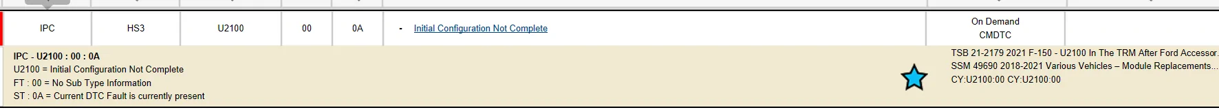

Happy BlueCruise day (hopefully) for everyone. I finally had a chance to get started and got the Mongoose going and did a network scan. This is the only DTC I have, if I understand it correctly I need to PMI it and choose that the module was replaced? @iceman77 @Jesse-Infotainment would love if you could chime in so I don't nuke it. Once it's cleared I'm updating all the BC modules today.
Try a PMI, worst case IF we have to I can side load the files.
