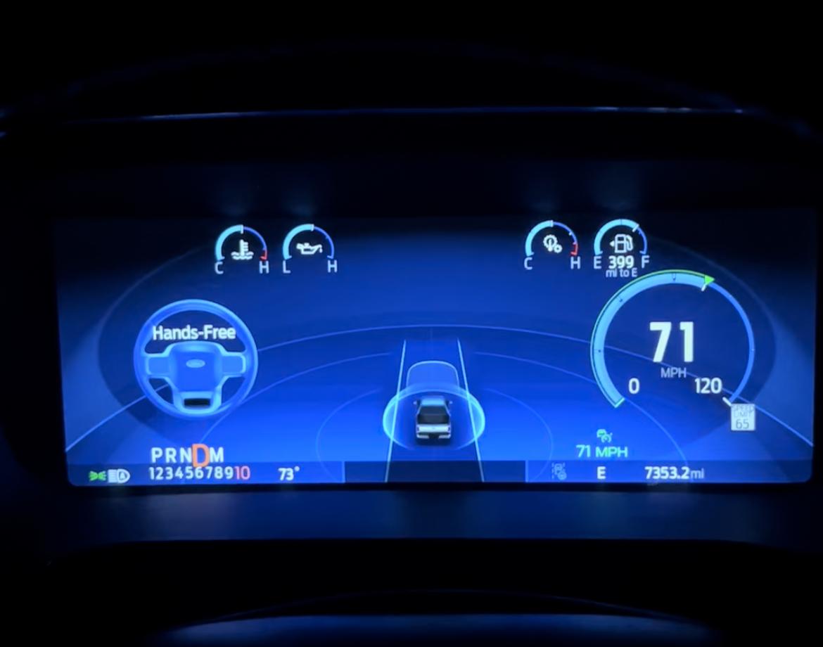

Finished. Drove for almost an hour. Lots of bluecruise highways here. Works great, definitely worth it.
