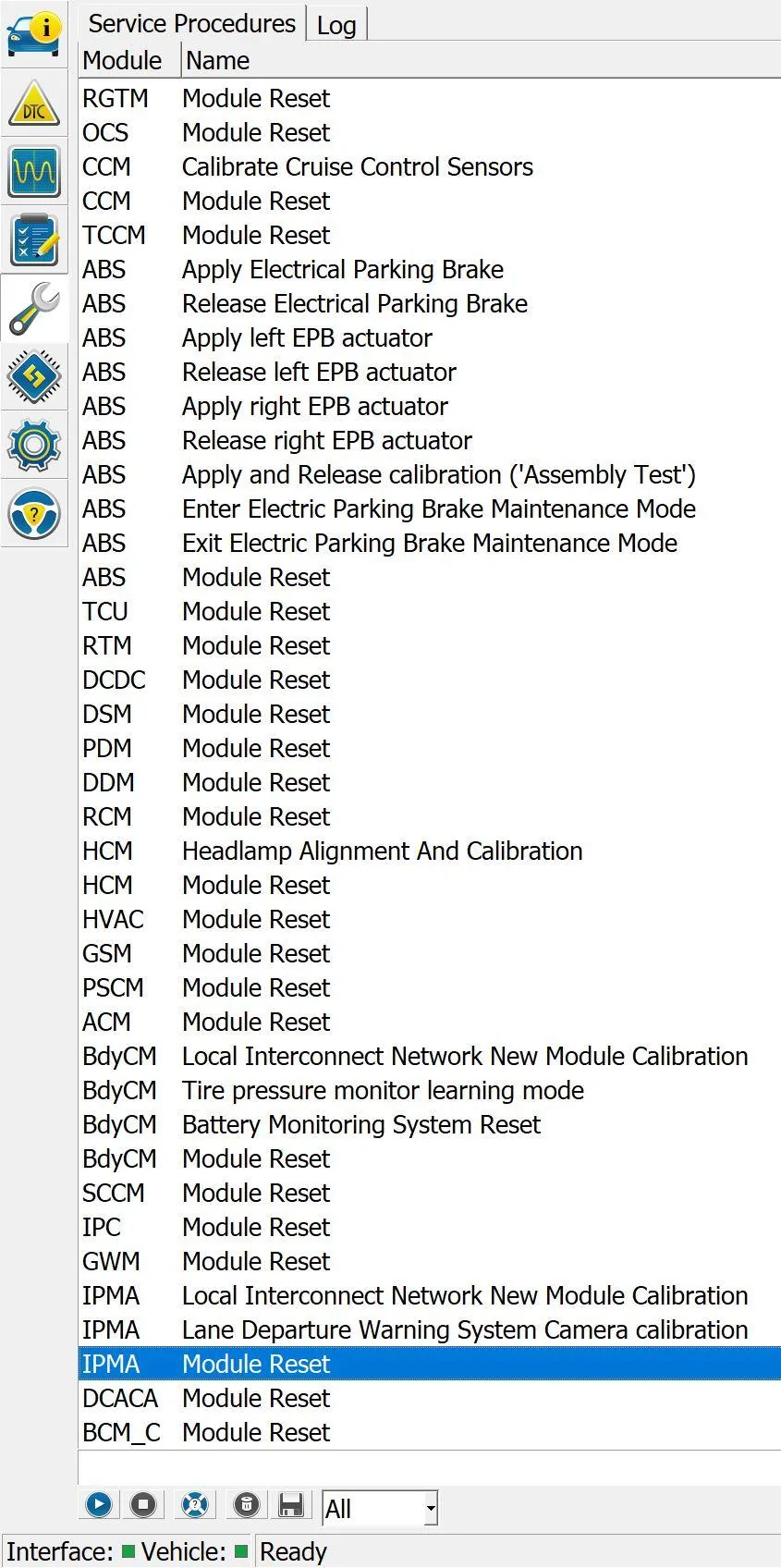

As an FYI,
This is what I was talking about regarding rebooting modules with ForScan. All the modules appear to be listed. So for those of you sitting in your truck with a laptop already open, this could be a quick way to kick an ECU that appears unresponsive. Obviously I wouldn't try rebooting something while it's in the middle of an update though. The list is longer than what's shown. This is version 2.4.5 Beta 3
Ford F-150 Lightning ECU module programming guide using FDRS ECU Reboot

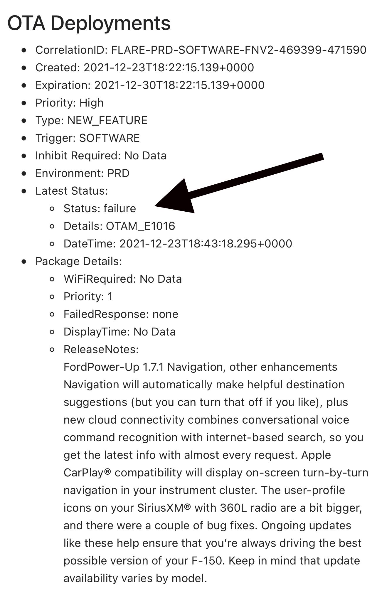

One thing is not clear to me is if the current APIM software offered by FDRS will address the OTA failure update on Job 1 F150’s that have been attempted to update to 1.7.1? Will this procedure apply the update successfully from F150’s in this failure state?

The thread has some great information! Thank you everyone for reporting your experiences with the updates.
Rpetersill, it could be said that in many ways that's exactly why many of us landed here. It IS why there's a run on mongoose adapters and folks are driving around this morning with a coffee cup in their left hand acting like that's normal. ?
Yes, is the answer
