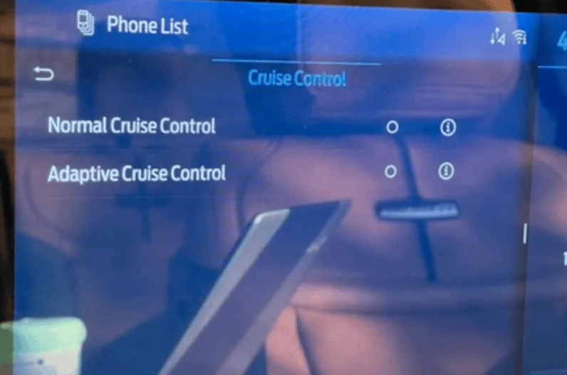

Iceman. I don’t remember where you posted about bad behavior with the adaptive cruise control, but something weird happened on my 4-hour drive this morning. When I tested my setup after your first post, I configured the cruise control to recognize speed signs. Like your system, mine also didn’t keep the setting past one ignition cycle. But I never actually used the cruise control or set it back to default. Multiple days and ignition cycles later, when I used cruise control for the first time this morning after updating my APIM, it worked exactly like it was supposed to. The adaptive cruise control changed the speed setting according to the changing speed limit signs. When I went into the settings, however, it still looked like cruise control was off. Not just the “smart” part but the entire function. So, at least on my system, it did work as I configured it a few days ago. The display just didn’t show the settings accurately past one ignition cycle.
I’m not sure if this is a better or worse result. But there it is.
Yes, the APIM settings are messed up. Not the ACC. If “I set it and forget it” it works as expected. The issue arises when you restart your truck and you purposely go to SYNC Settings -> Features -> Cruise Control. That’s when it messes it up. It does not just deactivates the Speed Sign Recognition but the Cruise Control mode itself is messed up (no CC mode is selected):
Ford F-150 Lightning ECU module programming guide using FDRS 1643396559458
When you tap "Adaptive Cruise Control" it will show that your "Speed Sign Recognition" is deactivated. But if fact, it deactivates this feature right when you enter this menu. So as long as you re-activate it and don’t enter this menu it works!
It seems to me, that the APIM software has a bug, where it does not retain this setting in its EEPROM and when you enter this AAC menu, default values are loaded. I believe this bug was introduced when their developers moved the SSR under AAC menu
Yeah, I guess I didn’t completely understand what was happening. But, at least there might be a workaround—set it how you want it once and then don’t look at it again. Only look when you want to make changes, at which point you’ll need to start over.
That's exactly my philosophy! Set it and forget it! My issue was, that I initially entered this menu each time I started the truck (just to verify if it retained the previous value). Then I learned, that this action actually deactivated already active SSR. So I reactivated it, and I left it alone. I just don't enter this menu section, until Ford developers fix this. And ACC with SSR works just fine!
