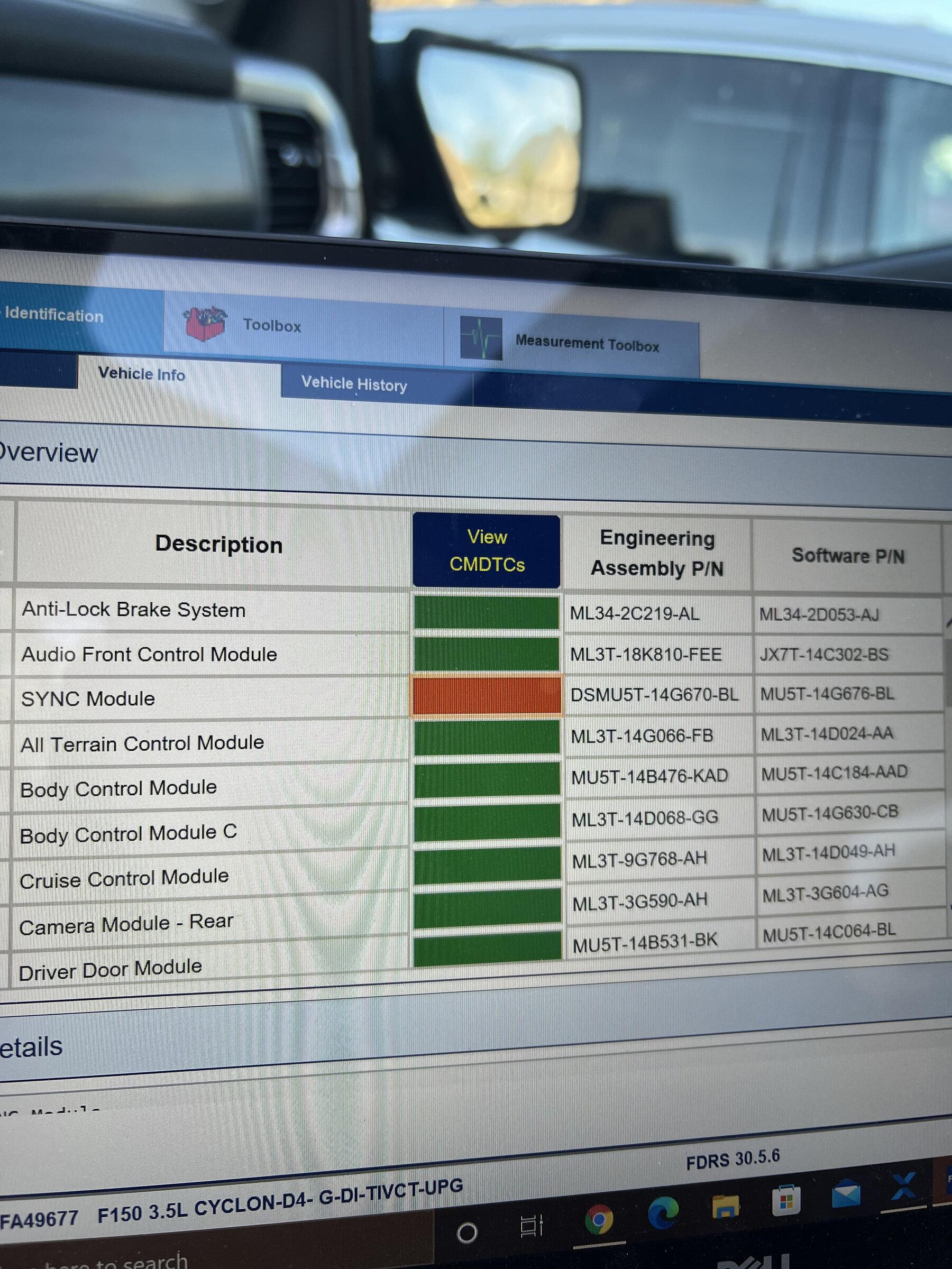

Ok so I let it run all night long and I don't know that it worked, also don't know that it did not work. Here is what I show this morning on FDRS: (meaning I can't download or run TCU anymore)
Hopefully now I can actually get an OTA, had the truck since May of 2021 and have yet to receive 1 OTA
What is the SW revision of your TCU ? If you PM me your VIN, I can check it for you

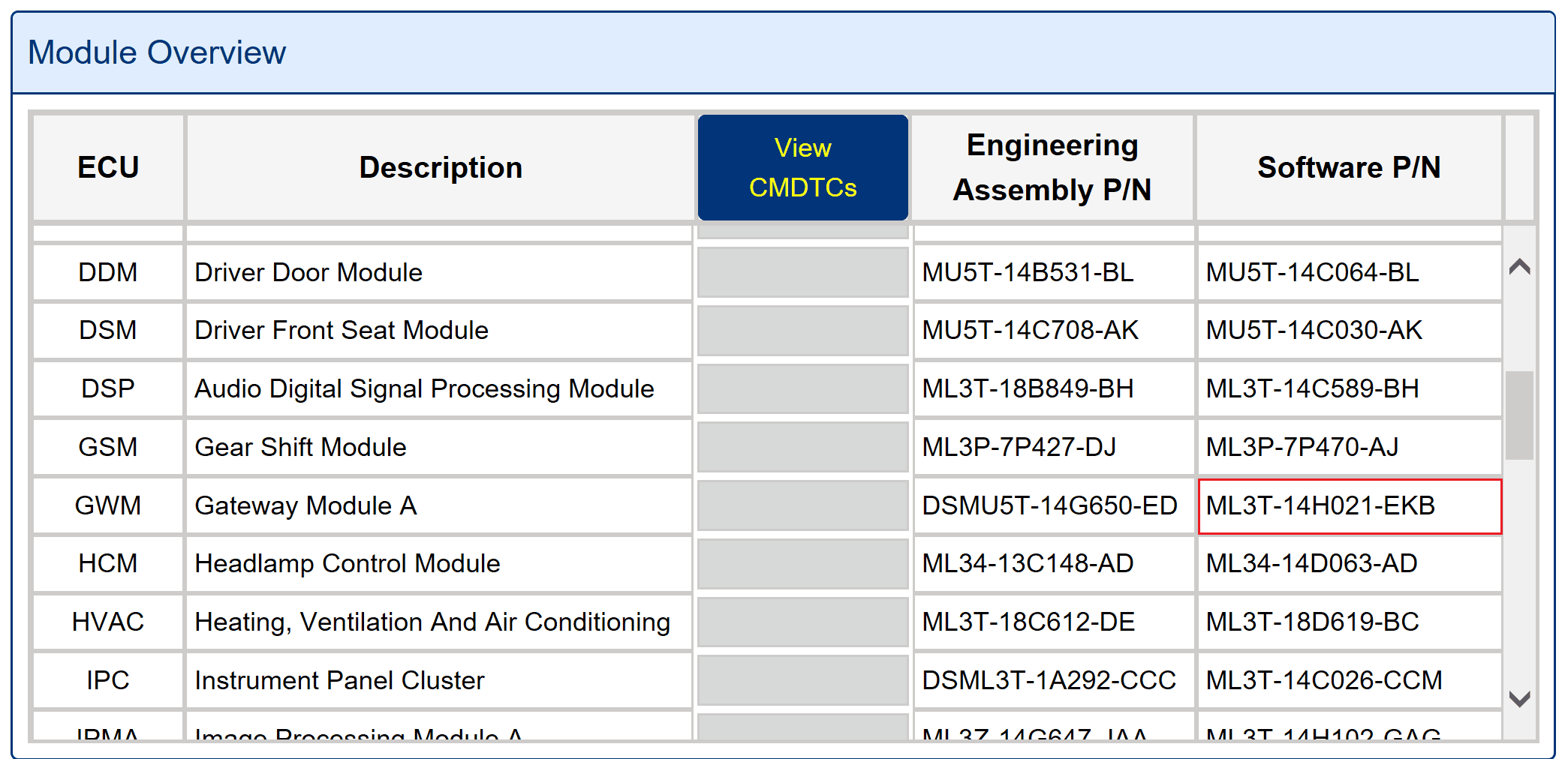

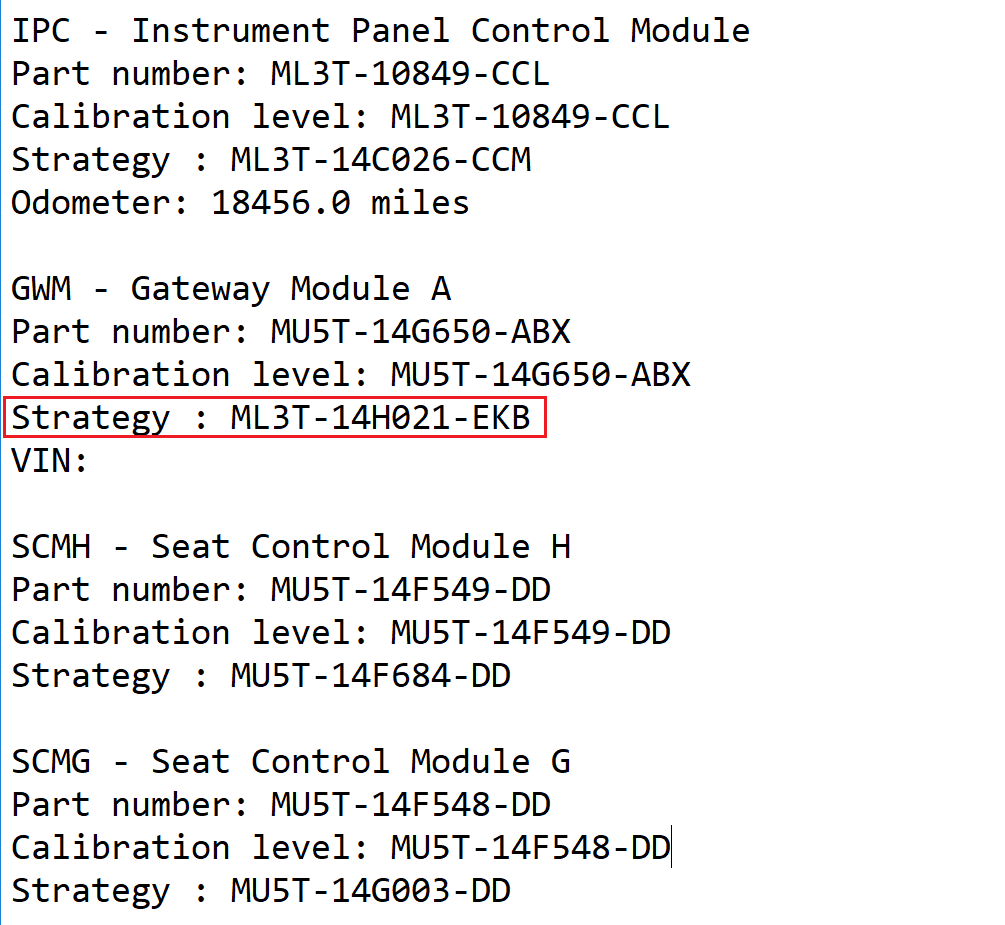

Kind of wish we had a method for reading each modules current revision.
You would think between FRDS or Forscan it could be revealed? :)
You can in fact get that information from both FORScan as well as FDRS:
FORScan:
Ford F-150 Lightning ECU module programming guide using FDRS 1642518678558
FDRS:
Ford F-150 Lightning ECU module programming guide using FDRS 1642518273693

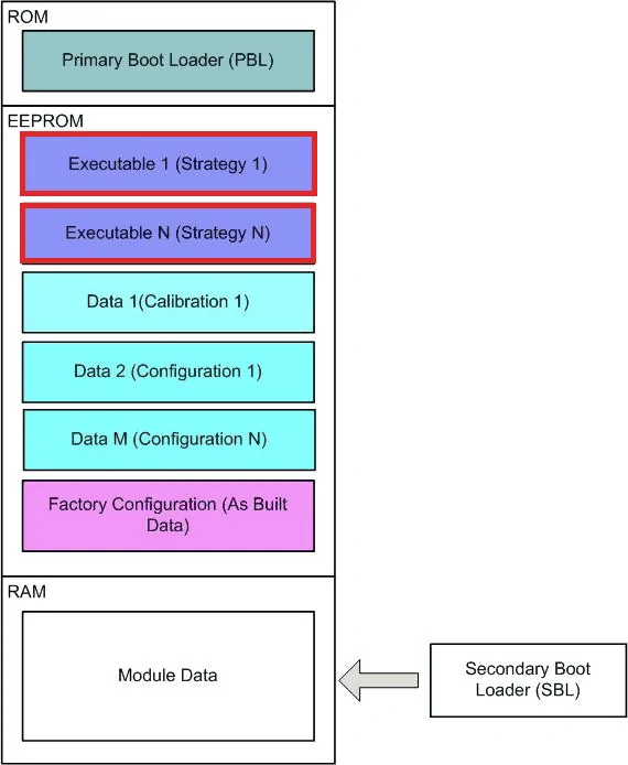

It's the "Strategy" what you need to look for. That is what reflects your executable software level (or version) in your module:
Ford F-150 Lightning ECU module programming guide using FDRS 1643296172781

I have in fact looked at the module/software-P/N grid in FRDS. But I remember thinking that I don't know how to map that to anything meaningful to me. Which is really me just being too lazy to build a spreadsheet myself and populate it with every data point possible.

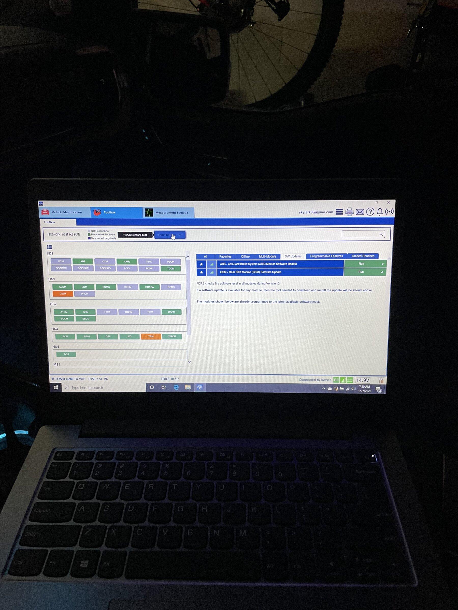

I'm a stubborn SOB, so I paid another $50 to get my FDRS license re-upped and found this waiting on me. Could this be why it's not kicking off the usb update for APIM? And if so what can I do?
Ford F-150 Lightning ECU module programming guide using FDRS unnamed
iceman77
Pete
Dec 29, 2021
381
275
Dallas
2022 Ford F-150 Platinum
Click on Toolbox, select APIM (its under HS3 section) and run Self-Test. See what's the issue and try to clear the fault.
Ford F-150 Lightning ECU module programming guide using FDRS 1642543987407
Post a screenshot if you need further assistance
