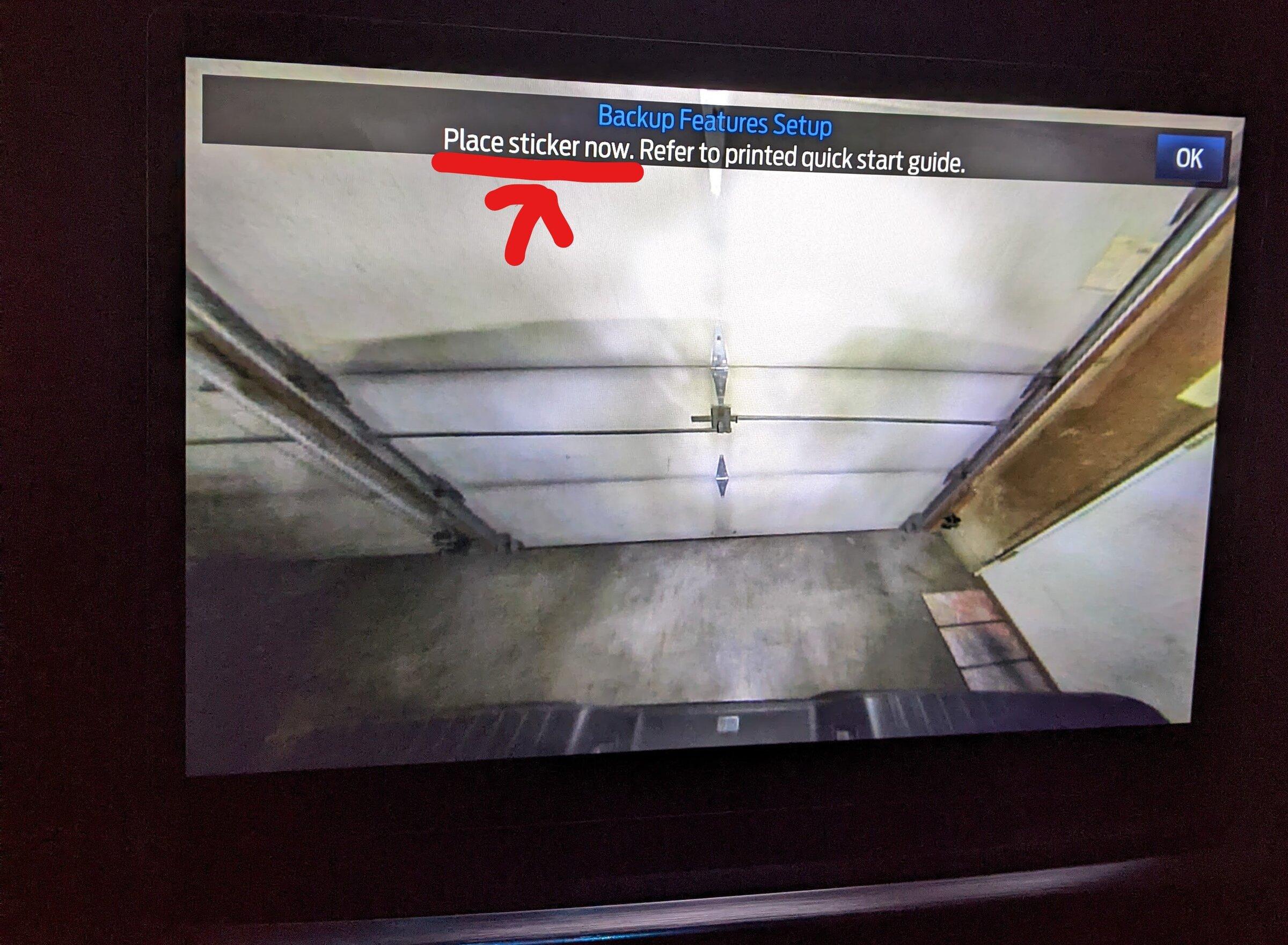

I don't have the joy of enabling Blue Cruise, but I was able to get the IOD BedCam to work now. I had to enable it via ForScan. I also updated the TRM module and the persistent DTC is not gone. ALL GREEN modules now! A side note I believe the trailer reverse guidance stickers are now enabled. I pushed the button and this showed up. Before It would say no sensor was detected.
This looks like the mega update we've all been waiting for. Blue Cruise, Camera's at speed, Trailer stickers. It's a shame Ford's messaging was so poor, but at least we are getting the updates now.
