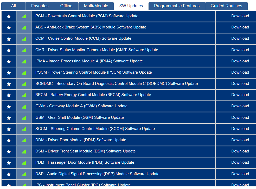

Could someone check my VIN to see how many updates I have listed? Debating to buy a mongoose. Want to make sure I have updates listed before I pull the trigger.
1FTFW1CD5MFB75327
1FTFW1CD5MFB75327
You're what I call a scroll
You have so many updates that FDRS creates a scroll bar for them.

I would definately suggest a 30 day license. Hes going to need a lot of time and patience. It can be done. I would get a mongoose too
