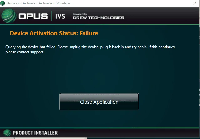

I've received my Mongoose but it won't activate. It was new from Amazon but I could tell the box had been opened before. Any suggestions? When I plug in to the computer I hear the noise from Windows of a device plugged in and the green light flashes on the mongoose.
I figured out that Amazon sent me a mongoose plus for Lexus instead of Ford. Couldn’t tell looking at the actual Mongoose. After trying everything I could think of I did a return to Amazon and read the box to notice it was the wrong one. ?‍♂
