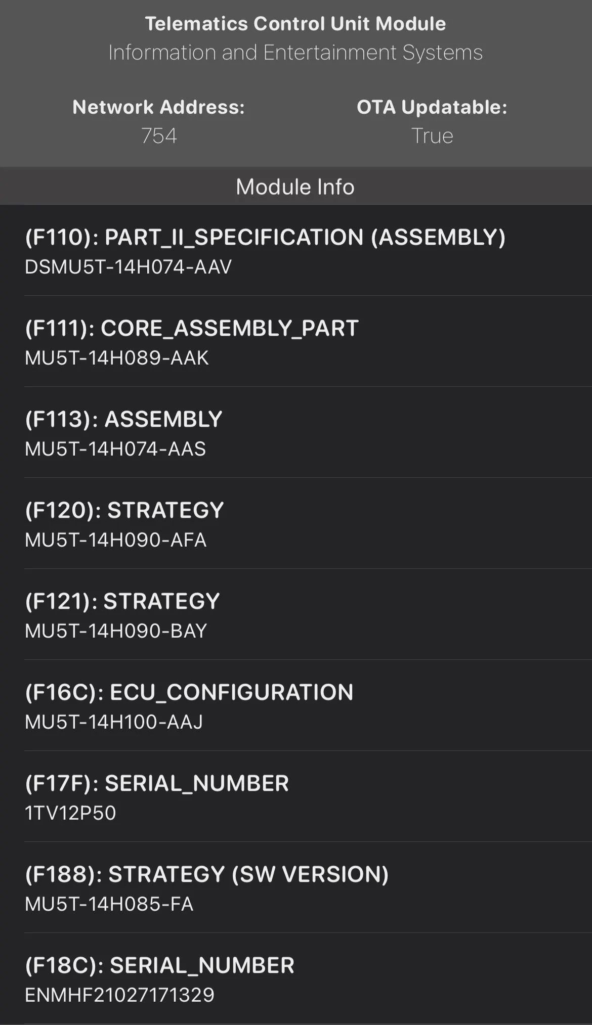

So my truck is failing to flash this MU5T-14H116-CA, but ive searched all my modules and cant find it in any of them. How can i find out where its missing from and how do i get it? Would a PMI fix this? Still trying to get the Module Update Repair to work. I assume it should be in either the Apim or TCU but neither of those have a line of code with that in it.

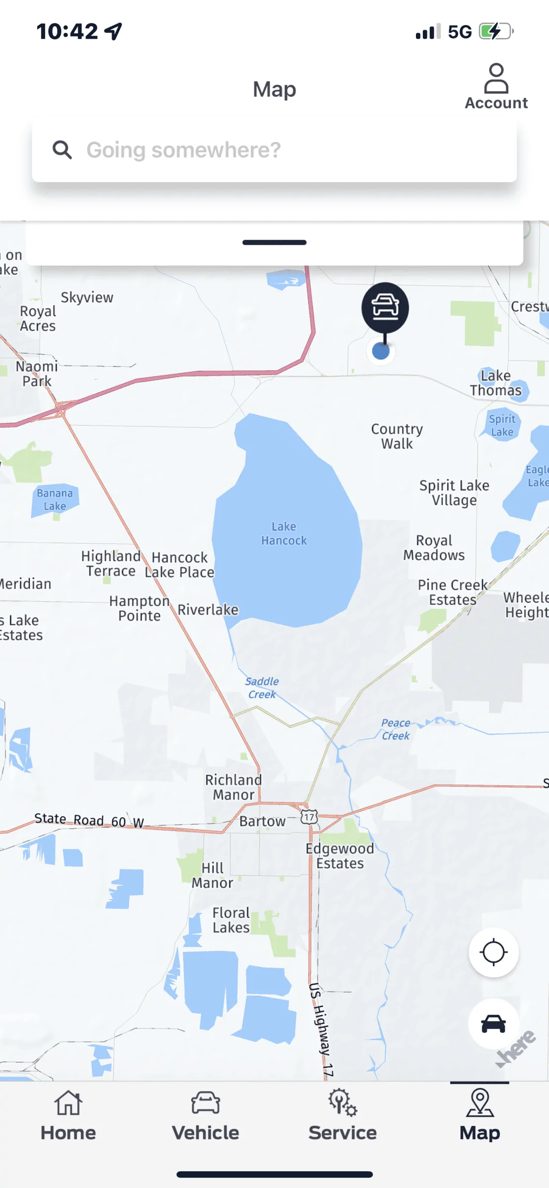

jperry5835
Feb 22, 2021
259
2021 F-150 Hybrid Platinum
That was me... I've tested it Red vs Blue... Its accurate. FP shows red. Nav screen shows pale blue. Red on Nav screen would indicate a hazard. Map in FP app is not meant to do much more than to locate your vehicle.
any idea what the orange and yellow roads are on FordPass?
Never seen any. Not like I look at that map feature. I just checked our whole metro area. Doesn’t show anything those colors.
jperry5835
Feb 22, 2021
259
This is what I am seeing for my area, just wish ford would put out a little information.
I looked at all of my modules and XXX-14HXXX-XX only shows up in TCU and GWM. The GWM only has the 14Hin the CORE_ASSEMBLY_PART which usually doesn't change with updates (I believe). All of my TCU numbers are MU5T-14HXXX-XXX (note the 3 digit tail number) except the Strategy (F188) which is one of the files that get written during FDRS updates. Mine is MU5T-14H085-DG (2 digit tail number), so my educated guess is that your file is the F188 for the TCU. The F188 for my IPC is the file I had trouble writing, so it seems like you are in a similar boat with a different module.
Guessing you haven’t figured out how to correct it? This is my TCU
