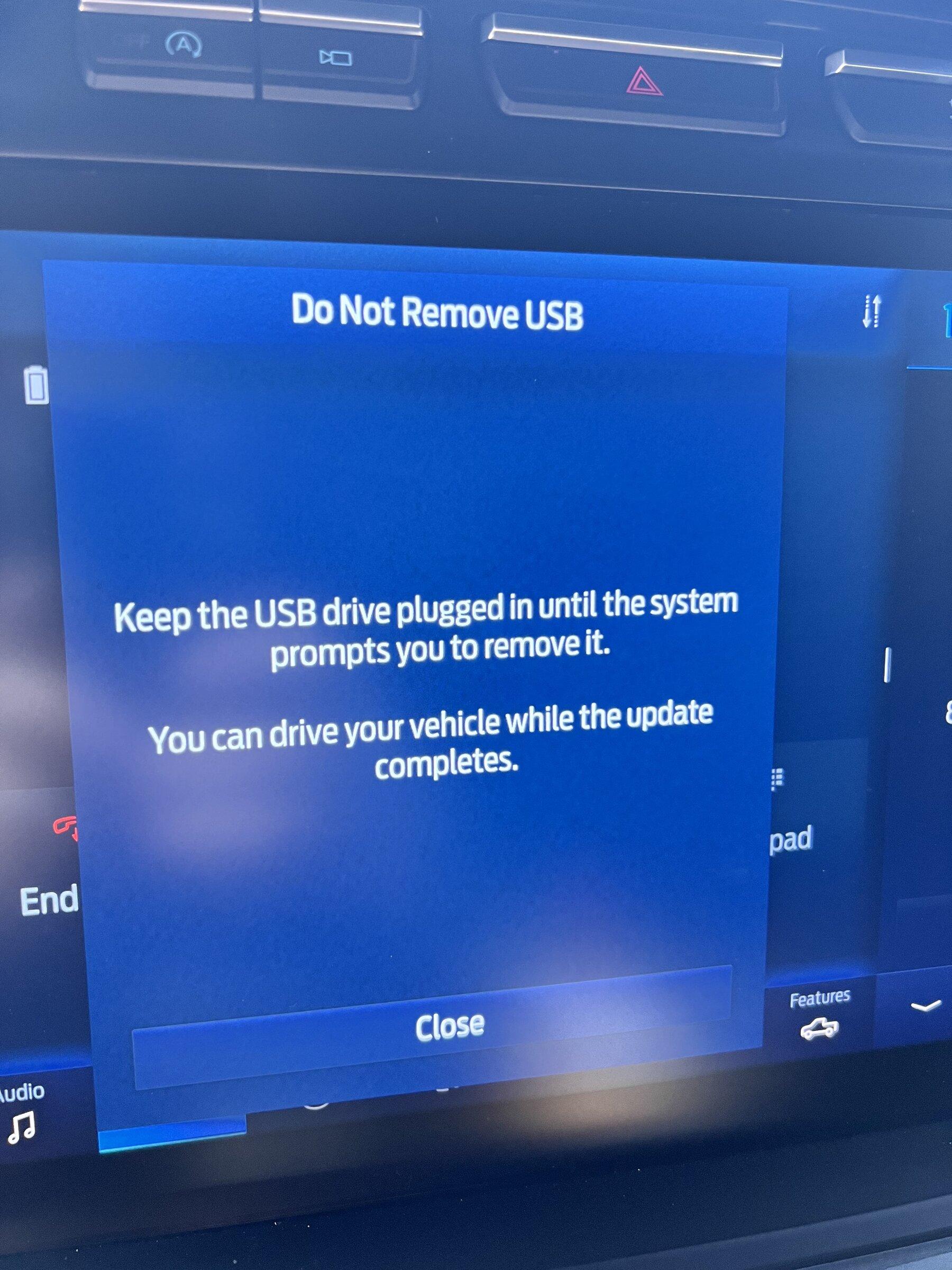

Im not fully following hi situation. If it wont update. Look at @Whoskyle . He left his usb in for a month or something. It finally kicked in. THe dealer is waiting 5 mins and goes oh bad apim. It wont fix it and it will just make it worse. THey wont finish a PMI they wont get you anywhere.
