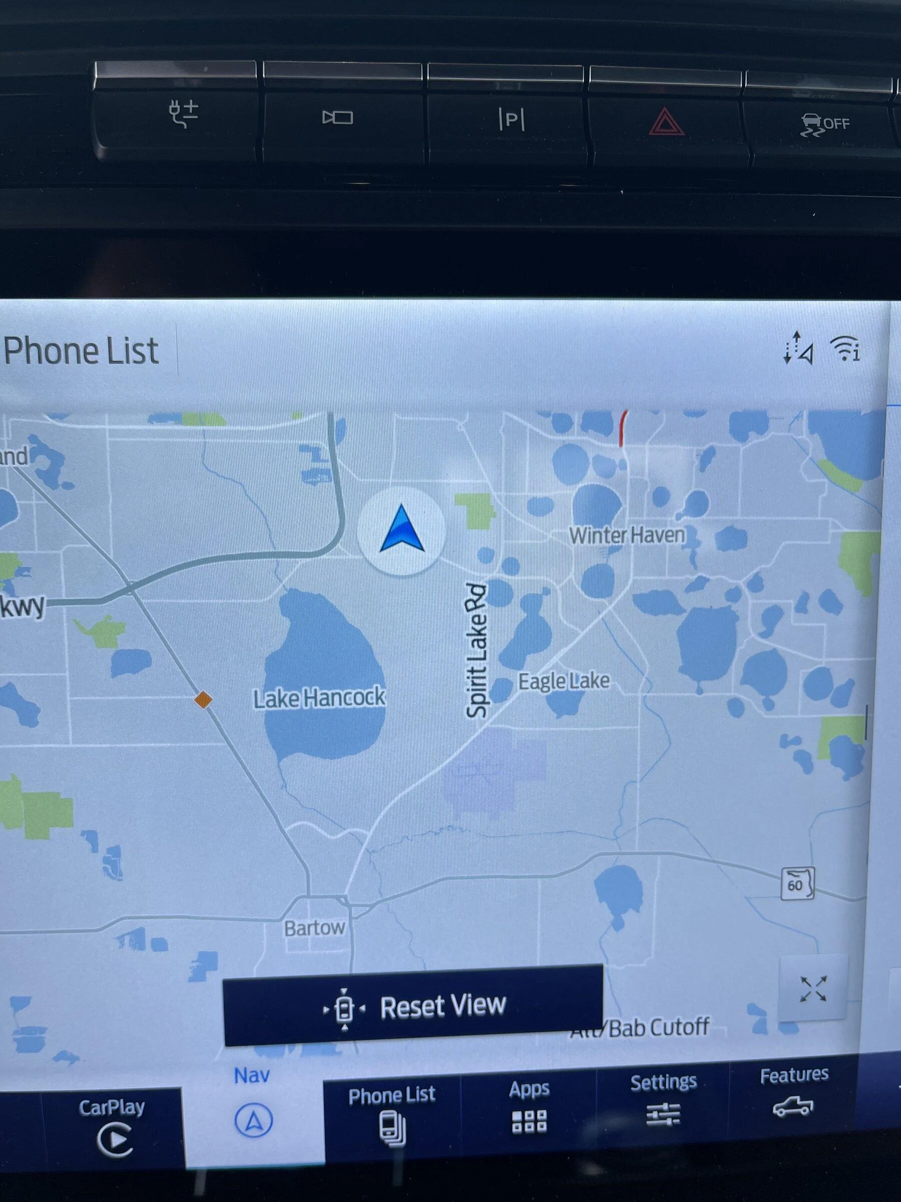

Guessing you haven’t figured out how to correct it? This is my TCU
That actually all looks reasonable, nothing jumps out at me as out of date. I'm back to being clueless.

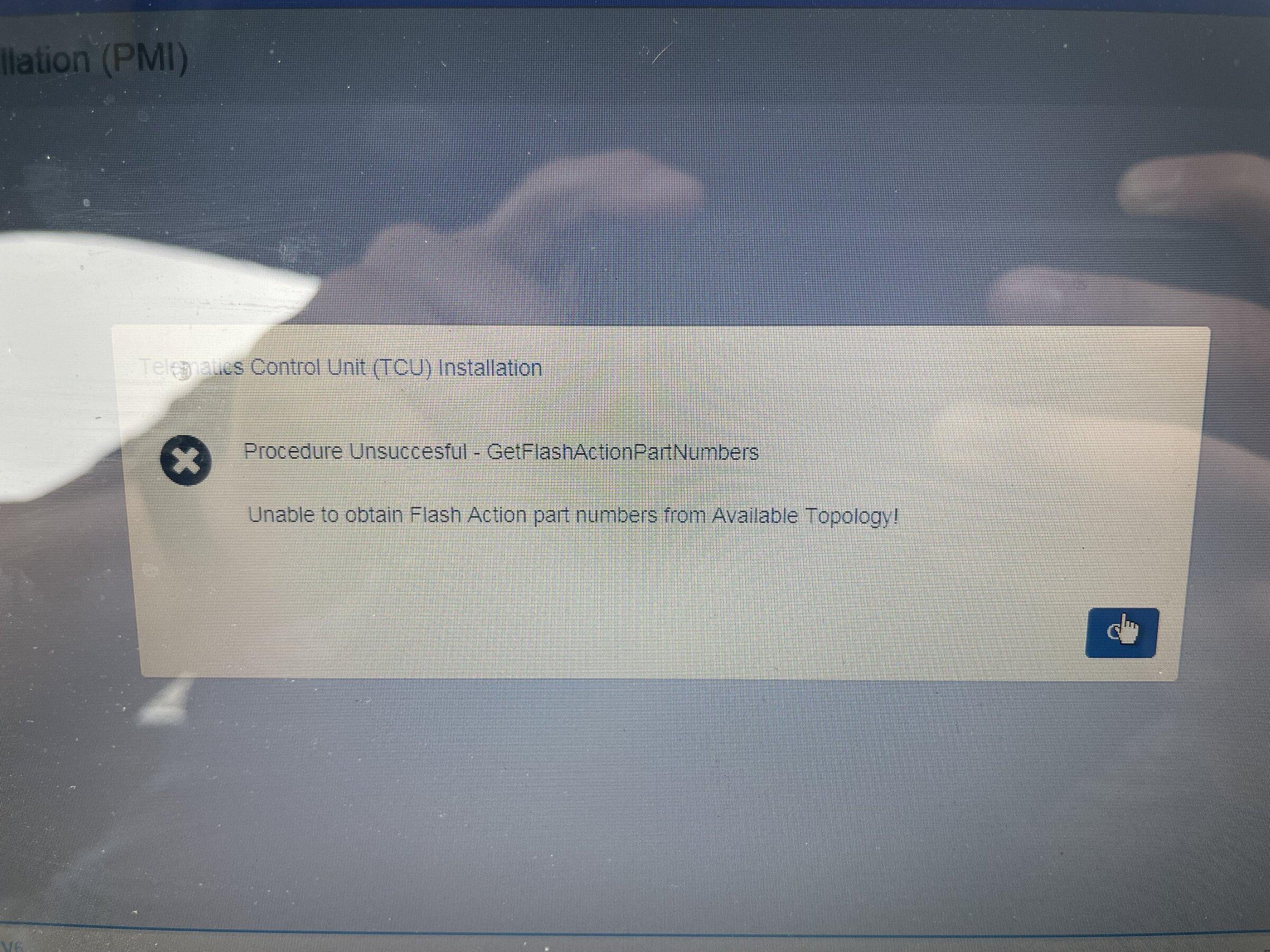

Attempted to do a PMI on the TCU and got this message… ??‍♂

Dumb question: how does one “PMI” a module?
I had this issue when i tried to update too far away from my wifi. May want to log out log back in and refresh the update/download and try again. Make sure your within wifi range.
