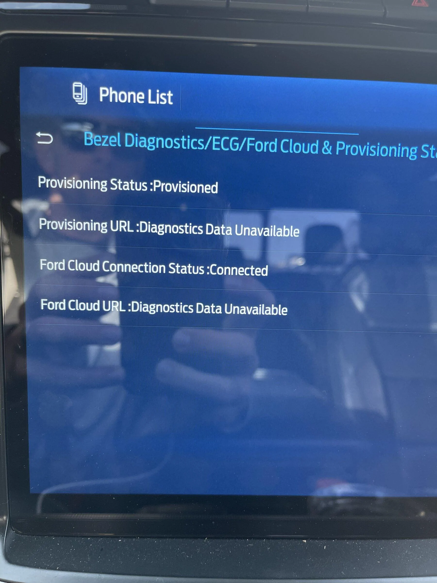

Out of pure curiosity, does anyone have any data in the url sections? This is the bezel diagnostics/ECG/Ford Cloud Provisioning
Ford F-150 Lightning ECU module programming guide using FDRS 9C27DFDE-1842-4AAA-8BD2-2294F5CEA837
