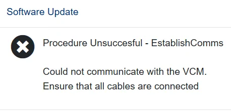

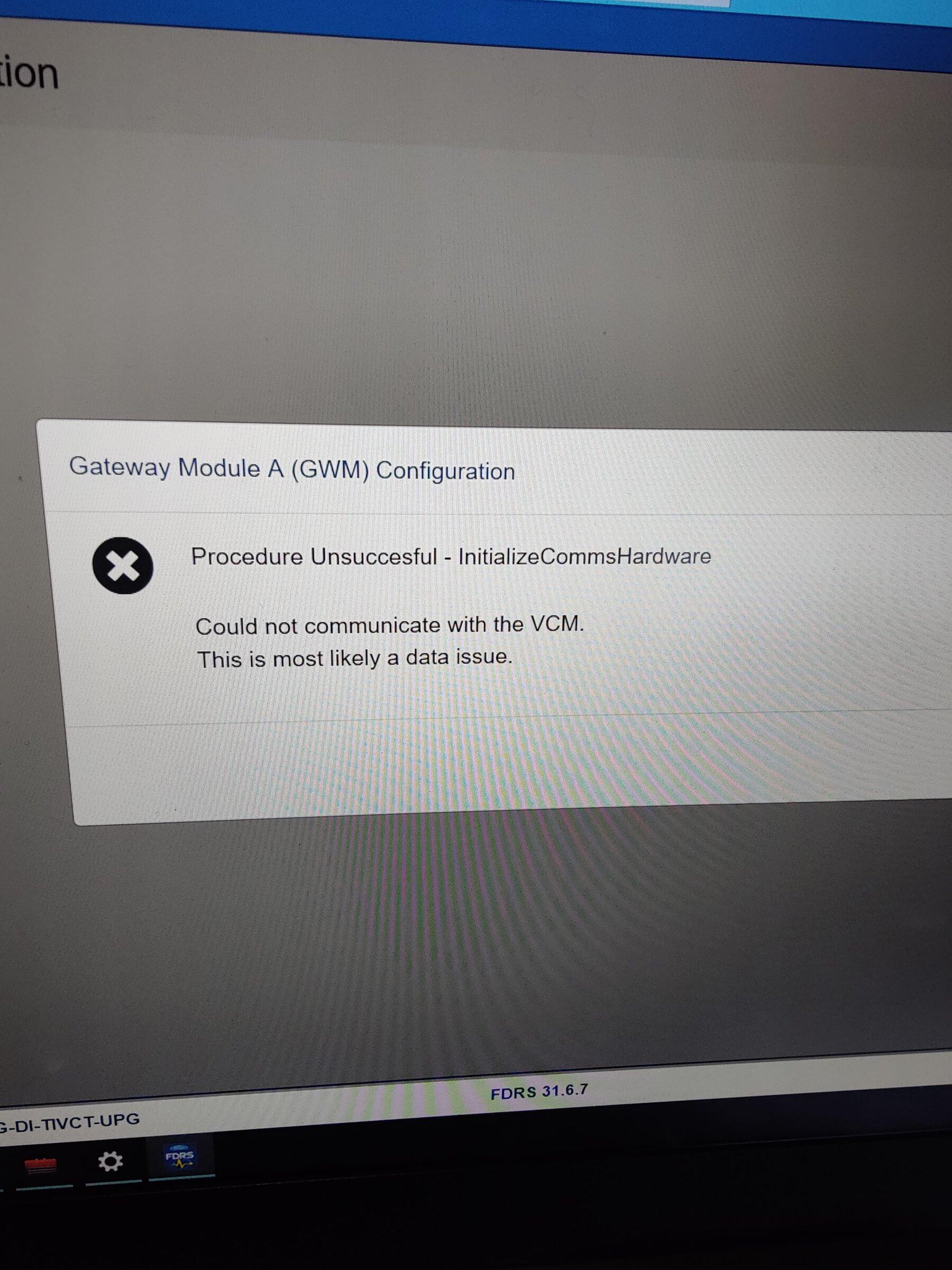

no change. hmmm. still getting cannot connect to VCM. i cant move on to the rest of these until this is sorted, eh?
and i shouldnt need to do the multi module repair again, right? that was just to repair APIM for the frozen updates?

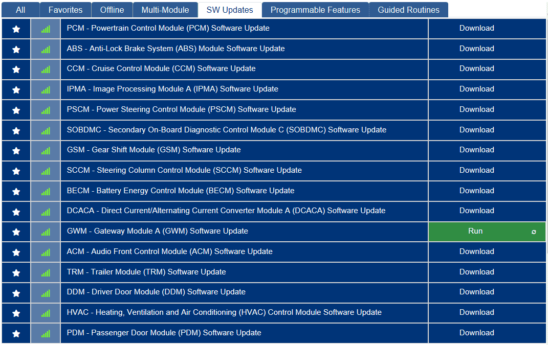

Got started on some updates today but running into an issue. GWM update downloads, the truck accepts the update and says its complete. After restarting following the outlined process, everything seems fine but running another network scan shows another GWM update. I wasn't really paying attention to the numbers, I just assumed it needed many updates. After the 5th time I got suspicious and it looks like its downloading and trying the same update over and over. Anyone ran into this before?
GWM or GSM? The GSM is known to not clear out, it's mislabeled.

same error im getting. trying to do a 2nd gwm update it says i need. going to try leaving overnight i guess if i shouldnt update the others.

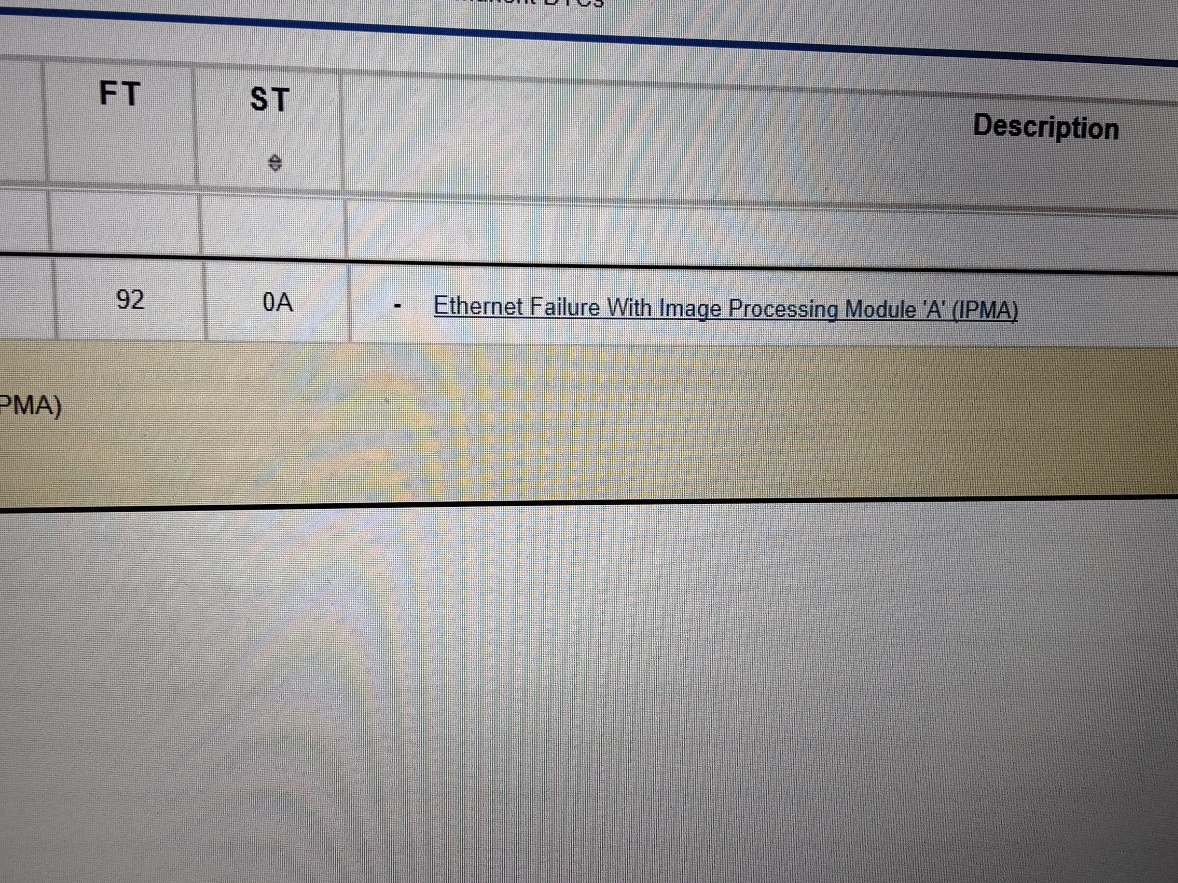

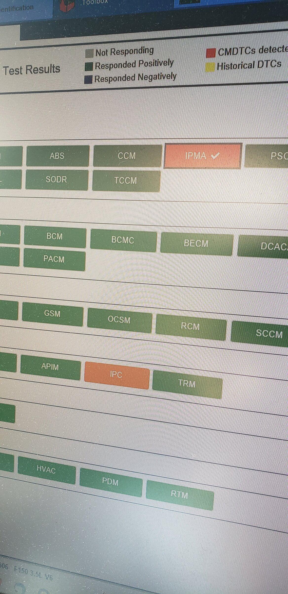

Yup getting GWM update issue also...so i went through the process waited over 10 min came back turned ignition on it would not show on sync as update successful anyway long story short got the same massage could not communicate with VCM now GWM is still in orange did self test and it cleared reran network test its back in orange ran self test again now i have DTC
Ford F-150 Lightning ECU module programming guide using FDRS IMG20220416164351
Ford F-150 Lightning ECU module programming guide using FDRS IMG20220416164345
Ford F-150 Lightning ECU module programming guide using FDRS IMG20220416164340
Ford F-150 Lightning ECU module programming guide using FDRS IMG20220416165056

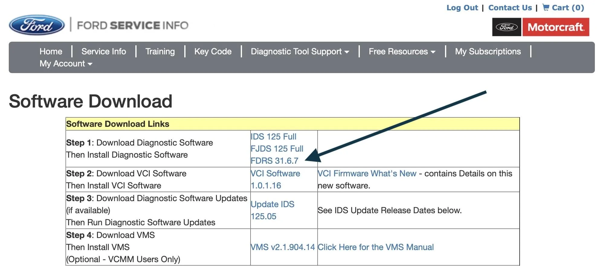

Getting ready to take my turn at TSB 22-2117 to unstick the APIM/TCU. Have the hardware including the Mongoose-Plus. About to load the software. All the online posts simply say download the FDRS software. When going to that page there all multiple steps listed with many software downloads. Just want to confirm that FDRS 31.6.7 is all that is needed.
That is all you need.

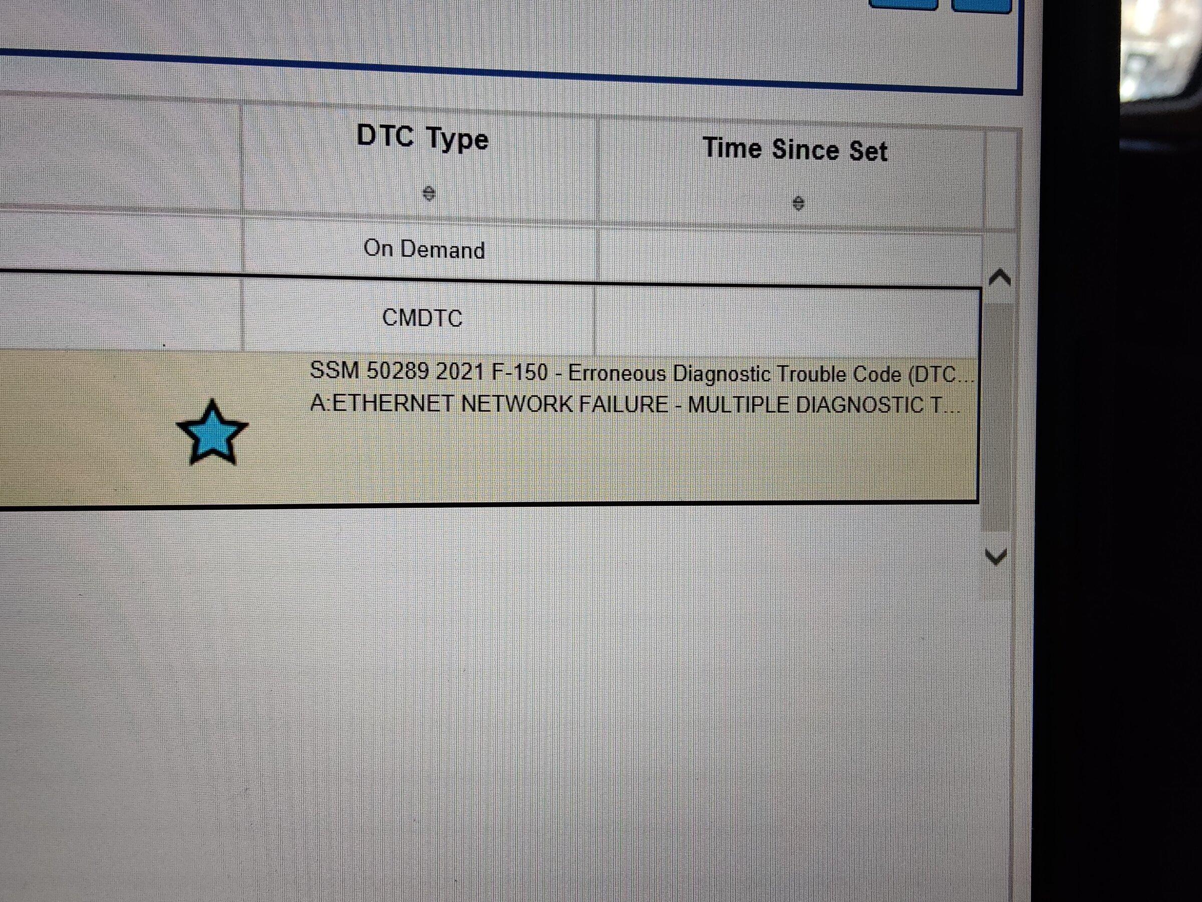

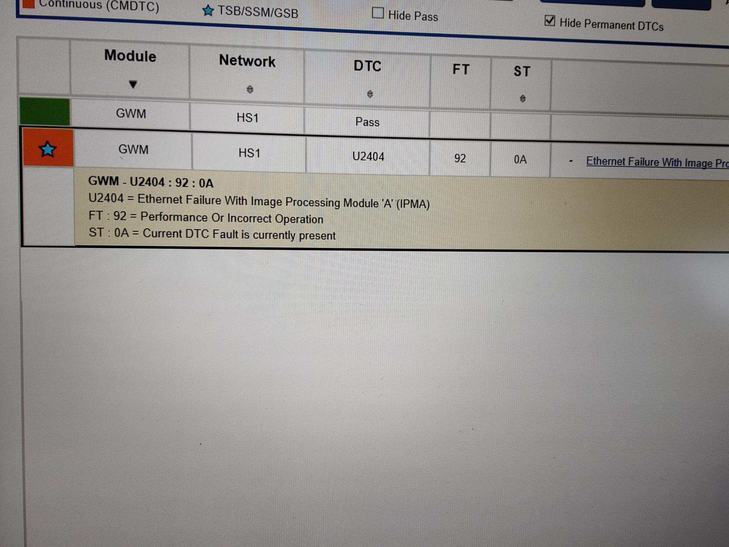

think i got some dtc too. should i resolve these first?
Those will resolve as you update. If you’re still getting the “data” error on the GWM then it needs to sleep overnight. That did it for me.
