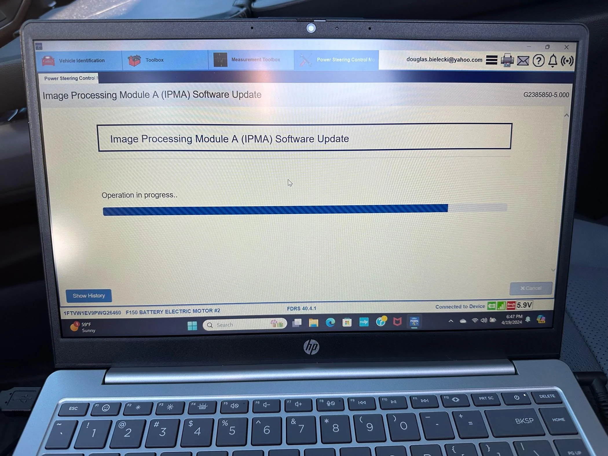

And I’m back…was able to knock out some smaller updates. Running the IPMA and it’s going on 3.5hrs. Sitting in operation in progress mode after installing everything.
This usual? Connection etc looks good. Started at 13volts on battery and down to 6.7volts now. Normal?

25A is not sufficient to sustain FDRS programming. The recommendation especially for long programming is 40A (or a piggyback of 2 20A’s)
With that said, I’ve been in the same situation and found that around 7 volts, the Lightning’s HV system activates and briefly bumps the voltage to 13V so that is probably saving you. It saved me during my IPMA update as well with 30A of charging not being enough.
But don’t rely on this in the future — for one I don’t know which module enables this emergency charging functionality, but during updates of that module you probably won’t be rescued by the HV pack. And also the voltage dropping this low and jumping around is thought to be risky in terms of successful programming of other modules.

I allowed the module to hang in processing mode another hour before I disconnected it. I cleared the initial codes and the car seems to work ok…how can I “check” via the sw if the module update took or if I can/should reapply it?
I no longer see any more modules to update after refreshing and checking again in fdrs.
