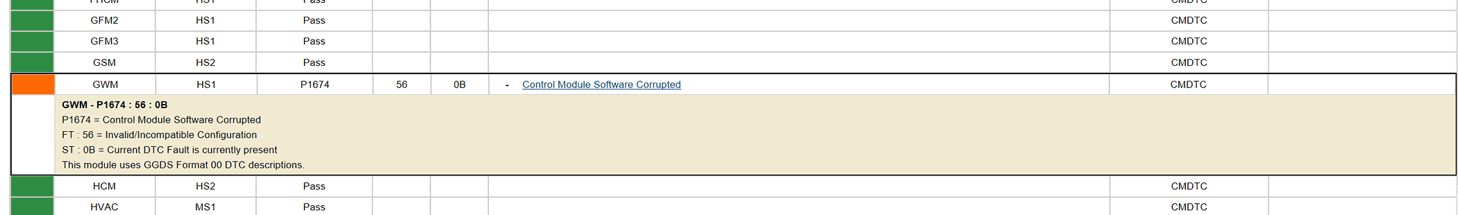

Just finished installed software updates. Avoided the PCM but accidentally selected ABS and it ended up updating the PCM as part of the dependent updates. Seemed to install ok. Unfortunately, FDRS crashed when verifying GWM software update. When I restarted FDRS the software update had disappeared from the SW Update tab. It keep throwing this error after every subsequent software module I updated. When I would clear and retest it would pass and be green. is this something I need to worry about? Should I try to reinstall the GWM software. I went looking for it but wasn't sure how to do that. How should I proceed?

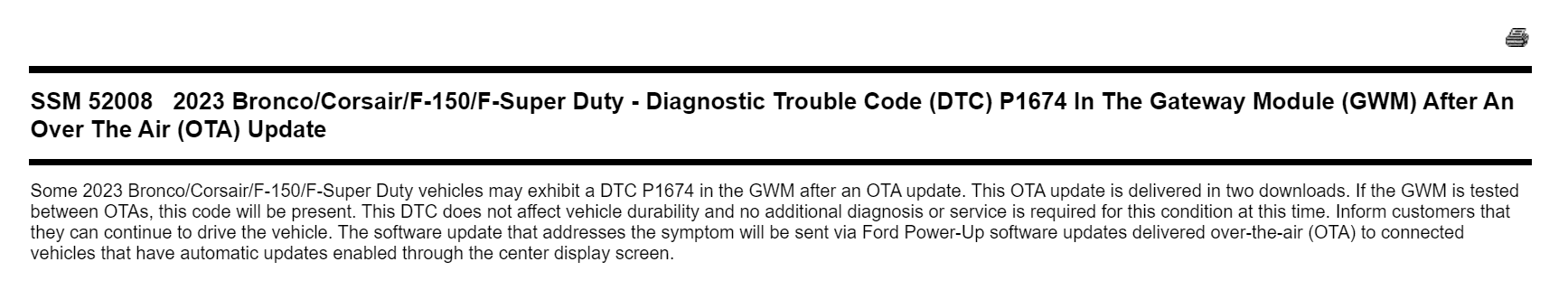

Same thing happened to @dugiepts66 a few days ago. There's an SSM about it. Nothing you can do about that for now.'
While I'm not excited per se to have someone hanging with me in this limbo stage, I welcome you ditkafan1985. We shall endure this together.
If Ford released an SSM about, believe me, it's a bigger party than just the two of you.
