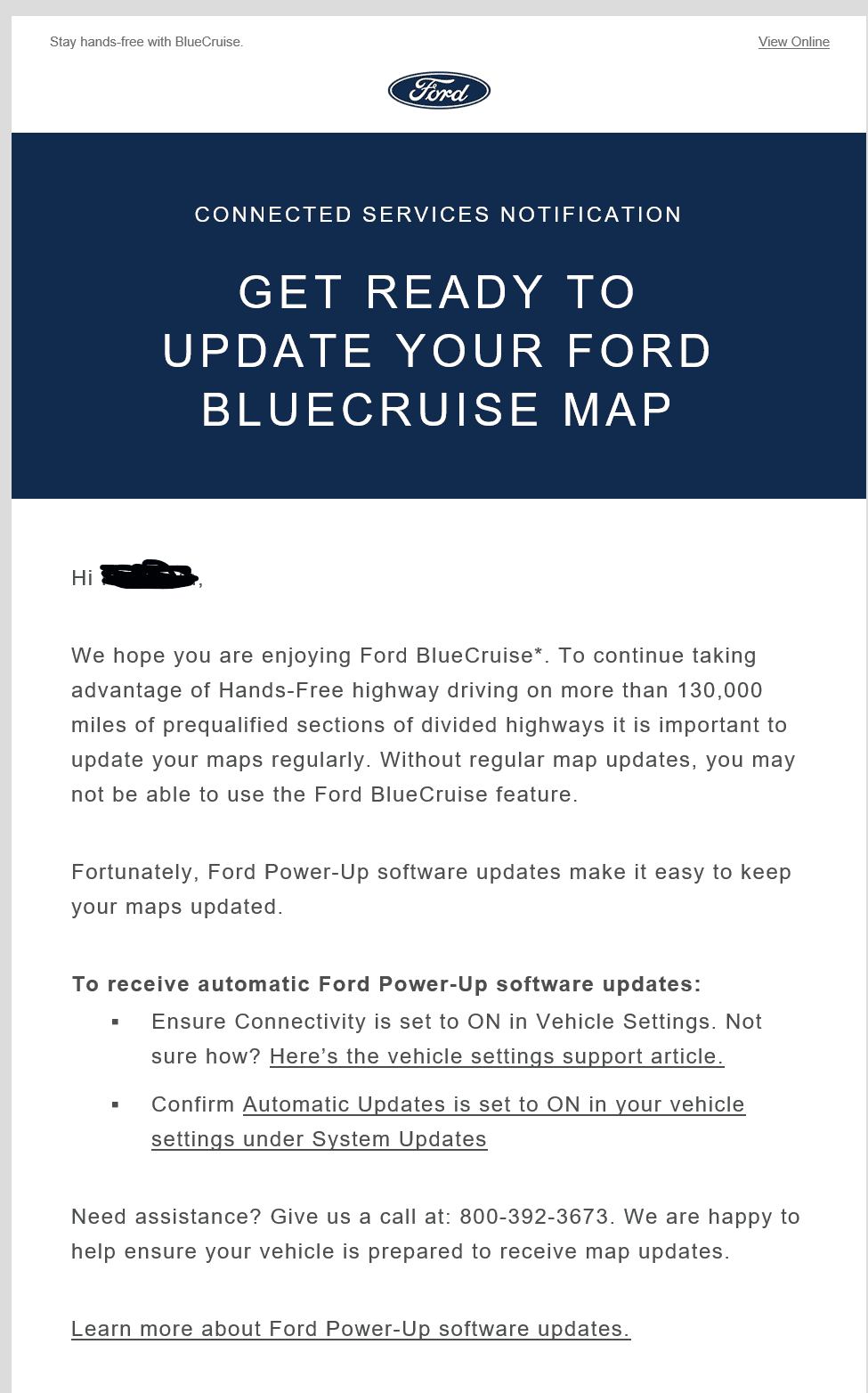

I received this email yesterday about a BlueCruise update coming; it looks like purely a map update. Curious if anyone knows if they are also updating the IPMA as part? I'm not exactly sure where everything resides for BlueCruise. Sorry if a silly question.
Bluecruise works off of approved premapped roads/highways. This seems more targeted to those that have it already. Do you have a truck with bluecruise. Job 2 trucks have it already.
They have maps updated for anyone with connected nav they are always updating maps. I have noticed several roads that when I bought the truck were not on my map and now are. They are updating them fairly regularly from what I see in dallas at least. My maps rival the apple and google options for accuracy.
Yes, I have a job 2 truck (8/21 build) with BlueCruise, but I've never had an OTA update applied, even for BlueCruise.
Job 2 trucks dont have any as of yet.
