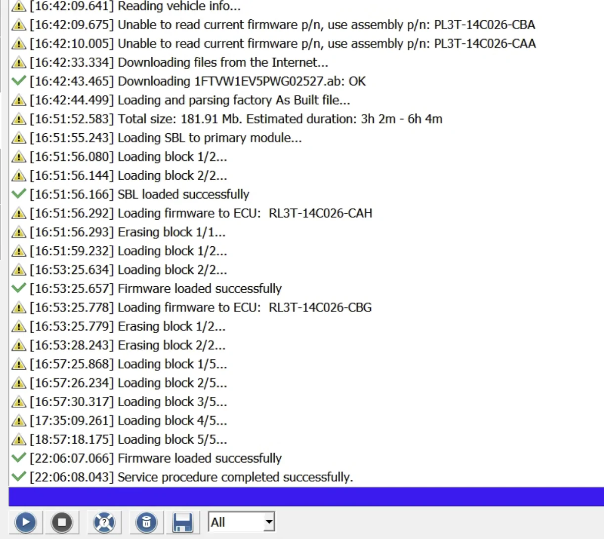

So what's the procedure?
I have stock IPC with no customized value
I can use forscan to flash the IPC and then use forscan to modify the hex value via as built and good to go?
The 23 and 24 firmware has different value mapping right? Do I need a 24 latrit LR as built hex to start and write the vin
if you’ve got no changed values in the IPC then just do the update and dump this stock as built from a 24 Lariat in your IPC
2101 is due to the lower portion seatbelt config. You can load a complete 24 IPC as build file and write it.. it will clear the 2101..
here is an as build you can use
2024_IPC.ab

To confirm, because I know if I have questions, others do too. Hoping someone here can confirm in plain language like not so smart.
1) If you have a '23 with IPC mods from previous tweaks you
a) complete the upgrade with the '24 IPC and then you must
b) apply an as-built for your chosen vehicle (in my case, a Lariat ER with max tow etc.)
c) re-do the mods as desired, but using the '24 IPC sheet.
Is that correct? Have I missed a step? Do I need b) or can I go right to c)?
2) Best to do the IPC updates before applying any of the new centre screen changes to charging preferences?
3) 12V, 100A Server supply a good way to ensure the truck stays happy. Disconnect the 12V battery, and use jump start terminals to connect the Server Supply?
Want to give this a go, no stranger to FORSCAN, but also don't want to brick ;)
A-Do the upgrade first
B-Do a write all just to the IPC section (720) from a 24 asbuilt to yours
C-Make Previous changes (matrix lightning, seatbelt chimes, etc) to that section (720 section) because after doing the write all, you will be back at stock values in the IPC.
I connected the power supply to the jump points and left the battery connected. I also had to take off my windshield wipers because they were trying to wipe the whole time. The upgrade itself will take around 5 hours. Then however long it takes you afterwards to change all of your previous forscan mods in that section back.
