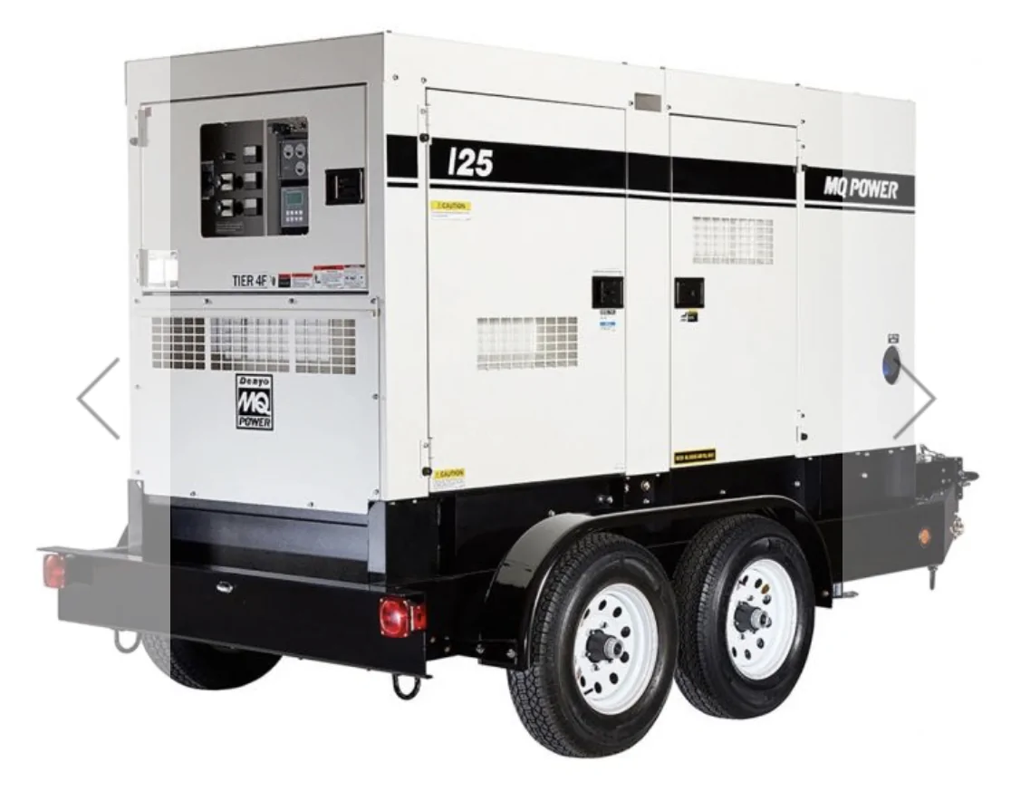

There is no way that it is a 130kW generator. This is what a 100kW generator looks like (and it costs $100,000)
I mean I get what you're trying to say, but between the trailer and 169 gal fuel tank it's a little hard to visualize the difference. Until you realize it's a 5.2L diesel engine. Most people can visualize that.

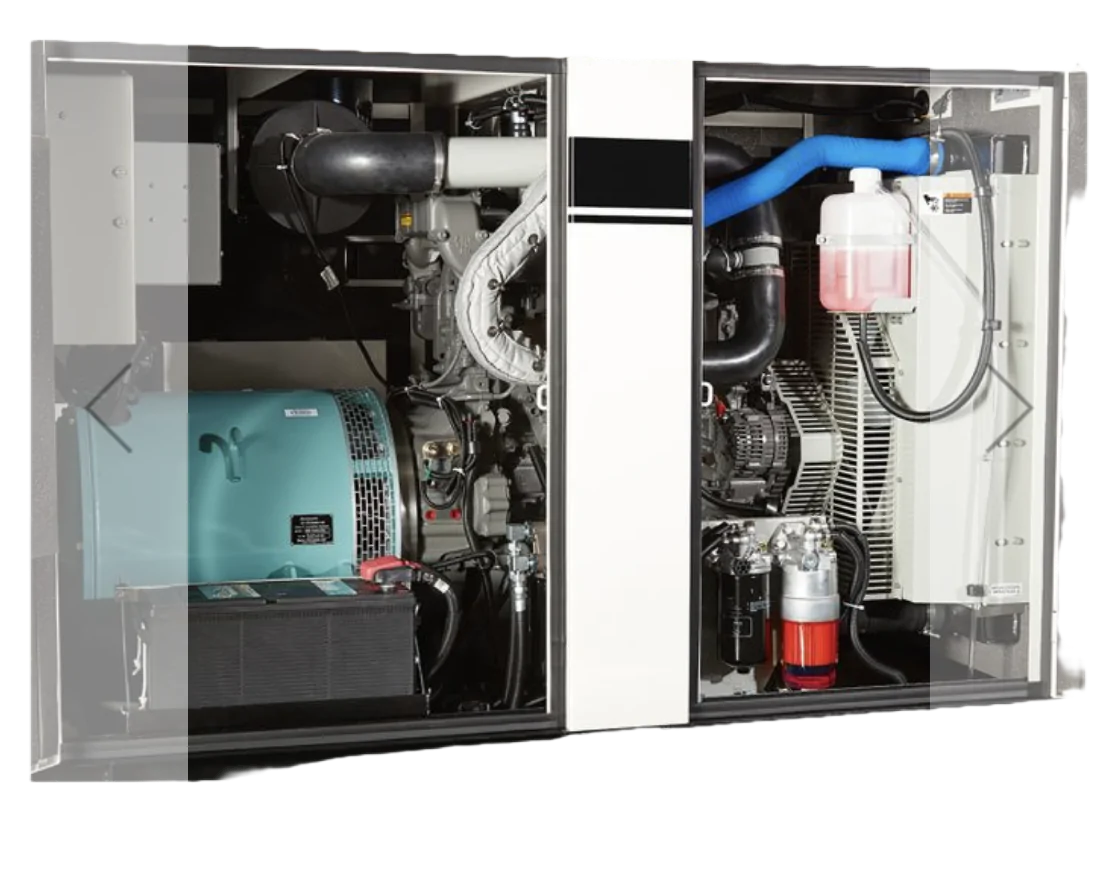

Here it is with the doors open. The blue cylinder is the important part, a very large and heavy alternator. For scale, look at the battery.
From what I have read I get the impression that the REV is 30kW , and even that is a big ask for a gasoline Pentastar V6. I would question the longevity of that system, although I'm a diesel guy so I suppose I am biased.
...what?
30 kW is not a "big ask" for a V6 pentastar. Do you not realize that kW is just a measure of power? 30 kW = 40 hp. Pentastars have been making 200-300 hp peak for over a decade. You'd want to optimize it for this use case, but 30 kW is not some sort of unachievable power output.
Generators for buildings are larger for a lot of different reasons (cooling, need to sustain output indefinitely, less focus on packaging efficiency, etc).
