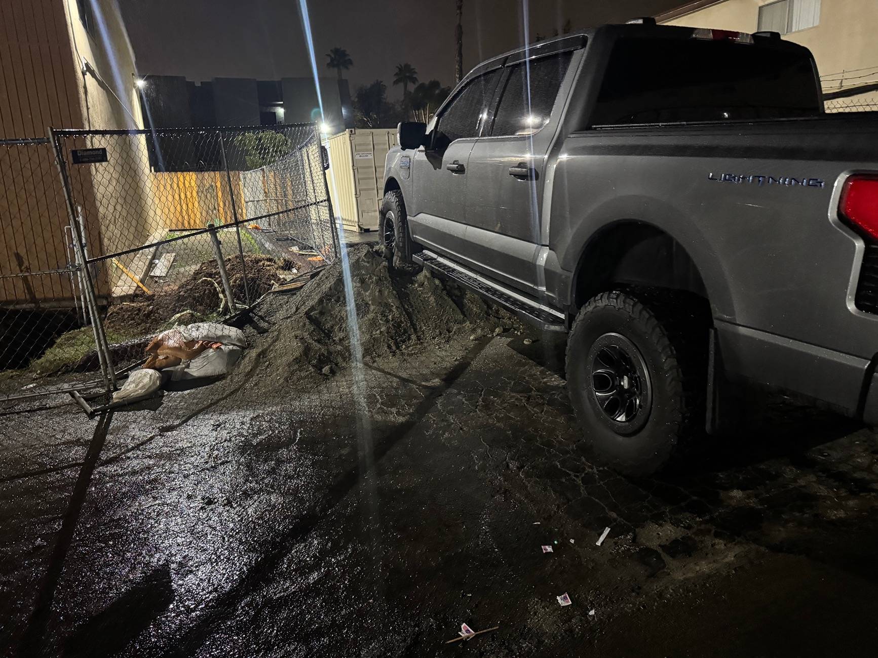

Is the front bar light tinted in the night time charging pics? @mdarcy002
I didn't tint the rear light. I only tinted the front light bar because it looked out of place to me in frost white.
Yes, the front light was tinted in the charging picture.

Lightbar tint looks great, really makes a huge difference.

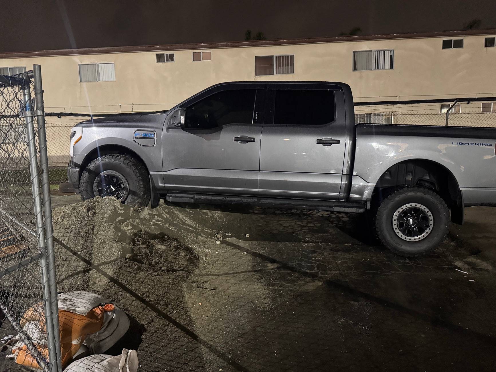

When you have a chance, would you mind posting a couple photos of the side profile of the truck?
I’ve got my leveling kit in and am struggling on offset for my wheels, looking at a set of methods 17x8.5 don’t know if a 0 offset or +25 would be better. Sounds like a 0 would hurt range as you suggested. I believe you said the raptor wheels are +34 so even 25 may be pushing it with aero and clearance.

Remember these are "37" wheels with the 35" tires, not 37" tires. They're only like 1" taller.
Before I swapped the wheels and tires, my miles per/kw in my area, with hilly city driving, and with the current hot summer heat, was 2.0mi/kw. I reset my Trip 2 the day I swapped the wheels and tires, and it fluctuates back and forth between 1.8-1.9 mi/kw now. Also, that is with an uncorrected speedometer. The computer thinks it's using more energy over less distance than it really is. I get 2.0-2.1 on days when I'm not heavily using the AC, and it's not hot out so the extra battery coolers aren't going. Since new, my Trip 1 hasn't changed from 2.0 mi/kw.

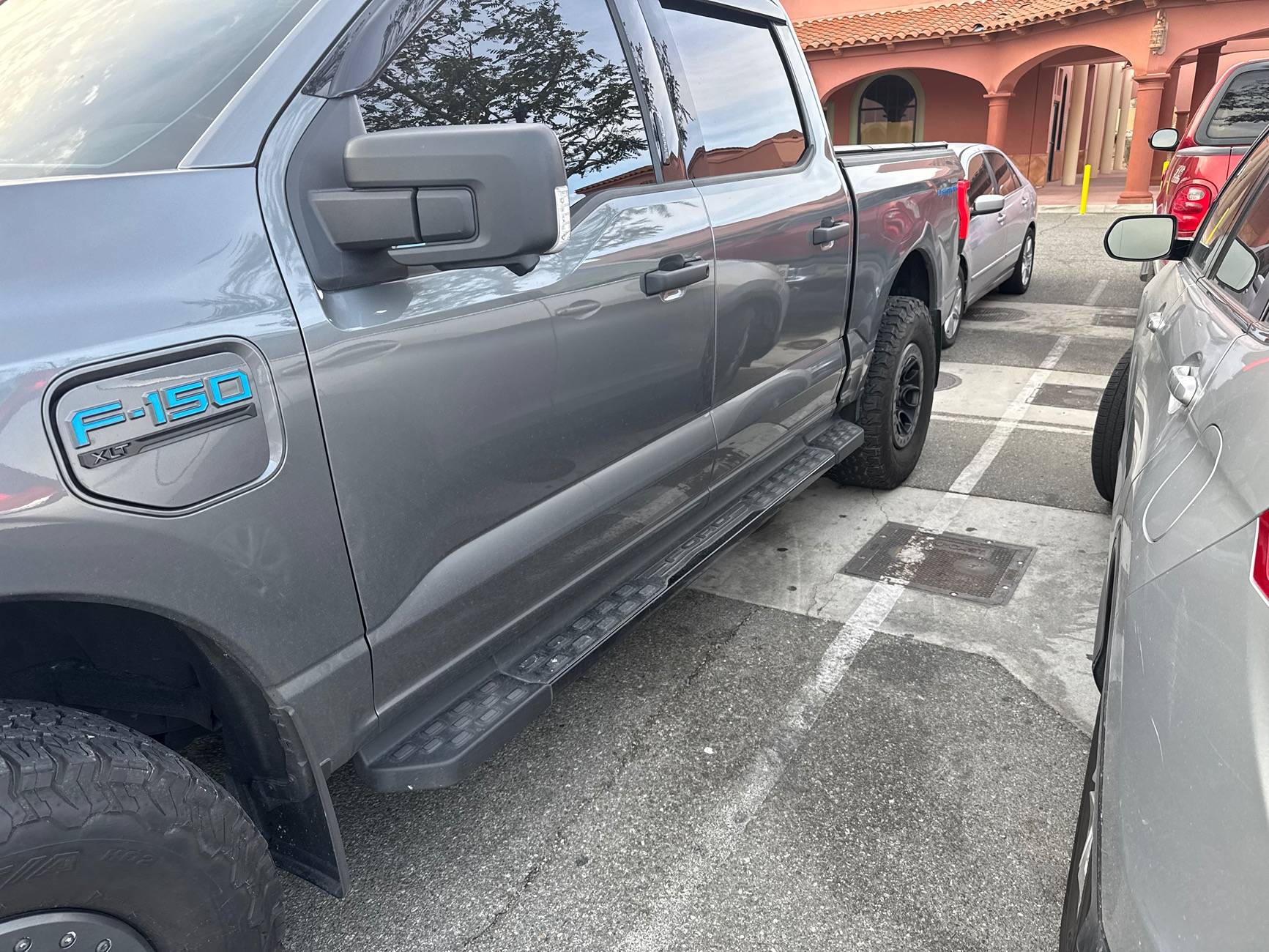

I picked up my Lightning early July. Forced myself to drive it stock for a month in an attempt to appreciate it as it came. I really liked it but didn’t LOVE it. When I walked away from it I wouldn’t turn around to look. Now I love it. The steps had to go (amp steps ordered) and the leveling kit, raptor wheels and tires made all the difference. I don’t feel like I’m driving a 2wd grandpa truck anymore.

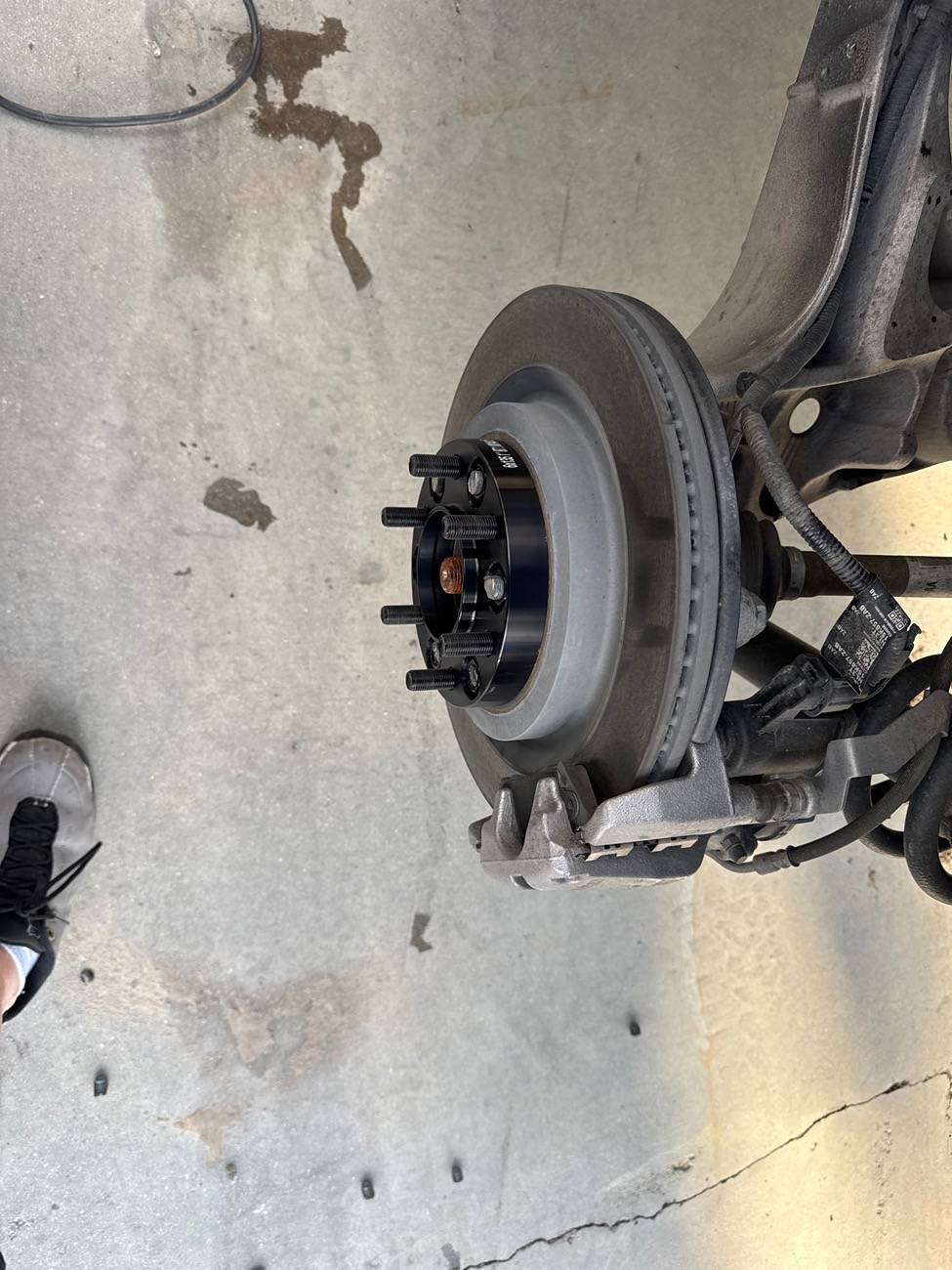

Bought the same wheels from a raptor r, wheels are rubbing the caliper, what size spacers did you use?

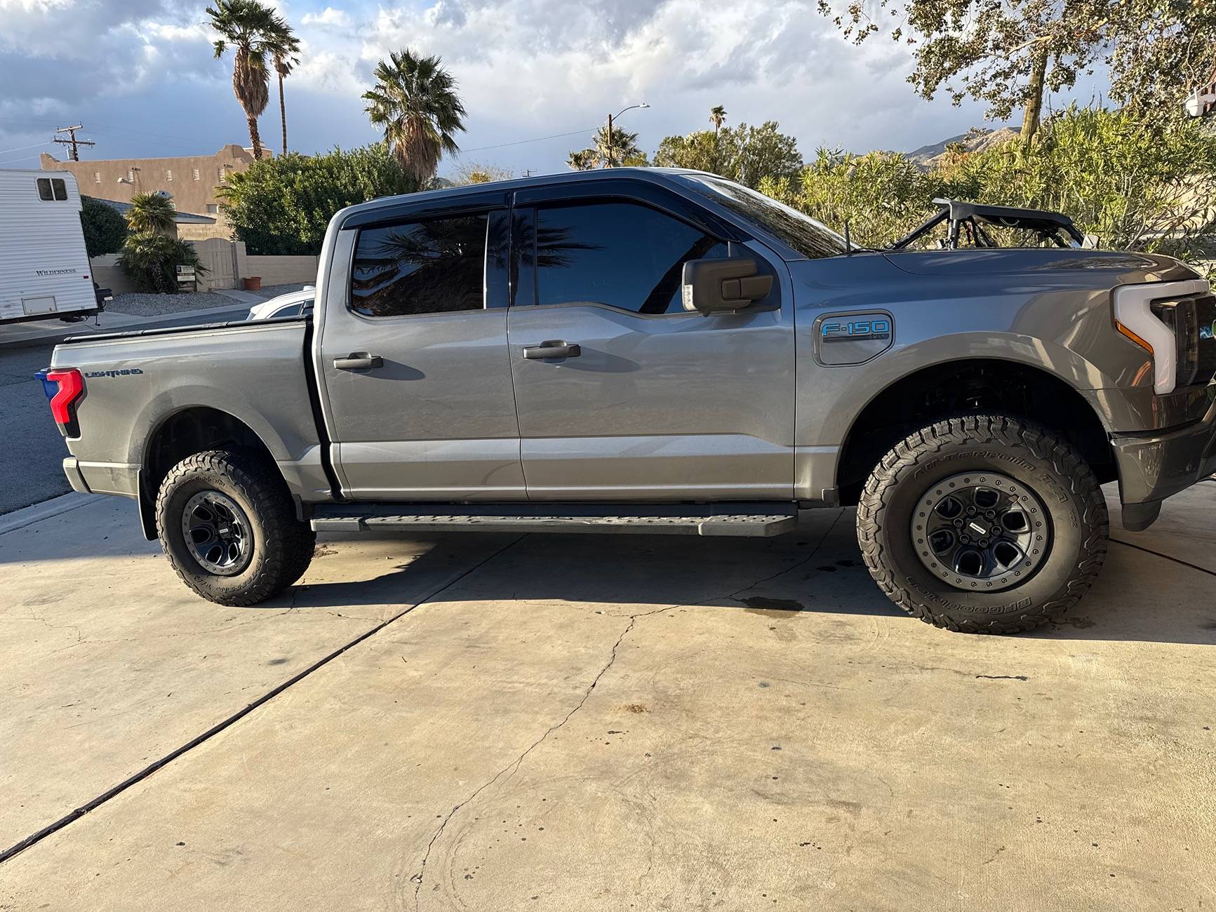

I used 1 inch spacers with the raptor wheels, and just a slight bit of trim on the bumper. I did remove the front bumper crash bar but the back ones are still in place. not worried about the ones in front, they just have to be unscrewed and bolts cut. no tub and flexes great, I do have a 2 5 inch bilstein leveler in the front no spacers, all shock

Are the tires 35" or 37"? Actually, what's the actual tire size please (315/70/r17 etc.) since a lot of folks have different ideas about how to translate these numbers to tire diameter in inches.
I've seen that some folks say you can swap the crash bars (right and left) to gain about a 1/2 inch of clearance, would that have been enough for these tires?
I'd love to know the offset on the wheels, but if you don't know that, do you know what year Raptor they came off of? (I figure I can research that and add 1" of offset to that for ordering custom wheels.)
