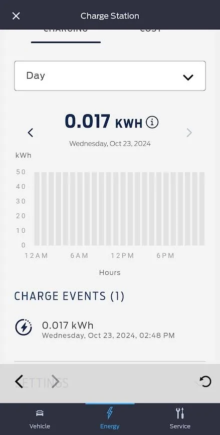

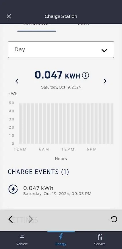

So, I just completed a mid week charge to test my experience, it's consistent with what I normally experience, ie. now white signal that a restart/reboot of the FCSP has occurred.
It did transmit my charging session, but this and last few sessions have had corrupted data transmitted.

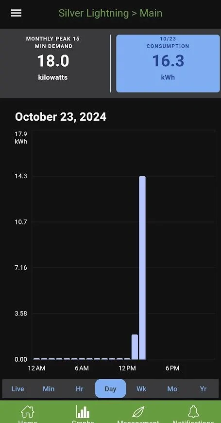

Today my Emporia tells me I consumed 16.3 kWh, generally the FCSP value is within 98 to 99% of that value, what I got today was 0.017 kWh.

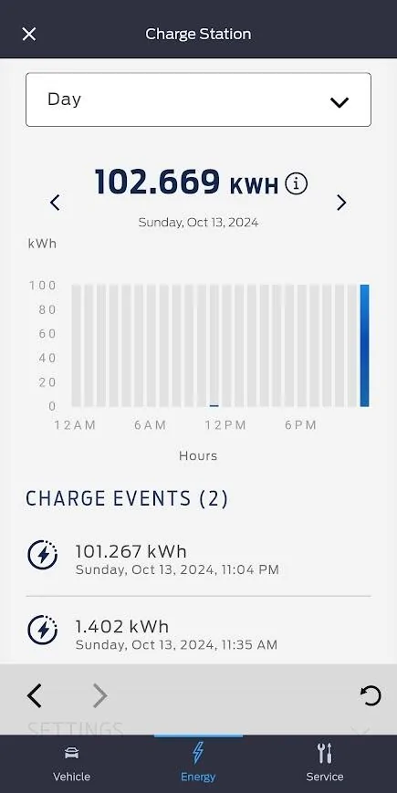

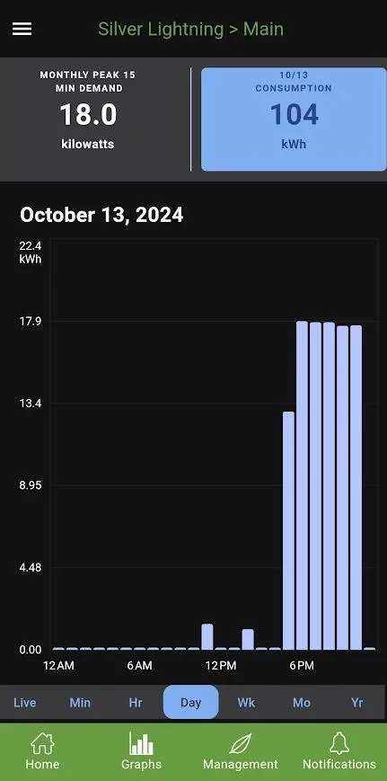

Last Saturday weekly session:
Ford F-150 Lightning FCSP going white (resetting?) after disconnect from truck. 1729710524210-68
Ford F-150 Lightning FCSP going white (resetting?) after disconnect from truck. 1729710552768-p8
Last time it was working properly on 10/13

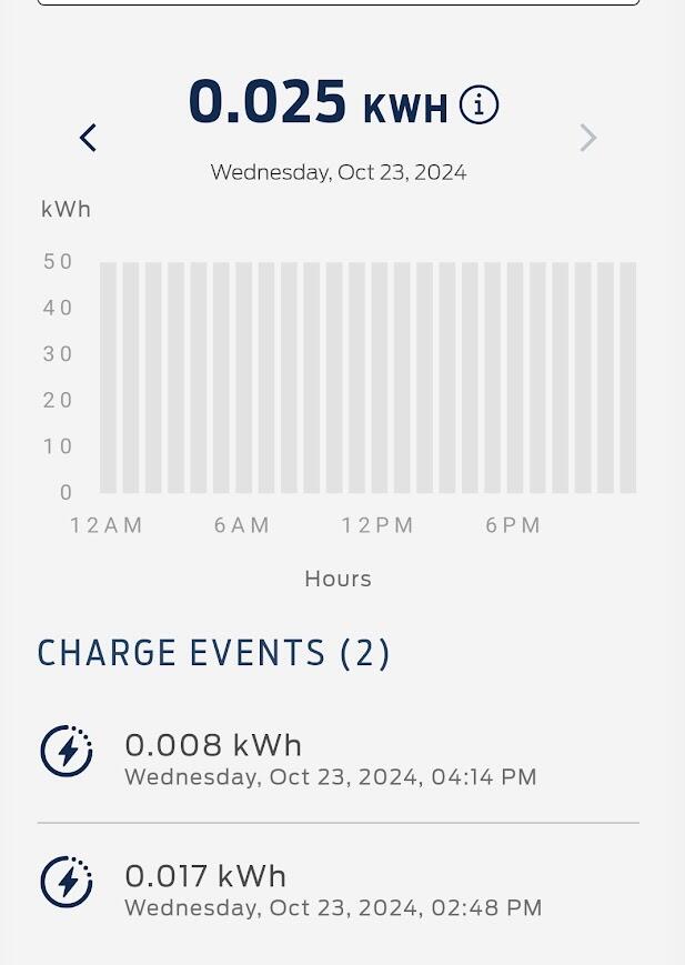

FordPass shows the “correct kilowatts”, but the FCSPdoes not!
I happened to look at it this morning after unplugging and waiting for the white light to turn back to blue on the FCSP.

Looks like yours started doing it about the same day as mine did so maybe there was an update that screwed things up?
I think you're onto something, the last time FP was updated was on 10/9, the 10/13 charge session was ok, but all after that are bad data, either the FP app FCSP plug-in or cloud data is off by an order of magnitude.

Second test session, similar results, data display is off by an order of magnitude, 5% charge to 95%, Fordpass said 7.1 kWh, Emporia said 7.8 kWh, and FCSP as viewed through FP shows 0.008 kWh, yet historical data 10/13 and prior is OK.
Code issue in the cloud database is what I'm suspecting, it's receiving the data but storing in the incorrect format since Z date.

Same here, seems the FCSP is reporting 1/1000th of actual.

I've reported this problem via android app play store for Ford Pass and the developers email contact point.
For BEV vehicles, the energy tab, Charge Station feature, INSIGHTS data is corrupted at the FORD server, values are off / low by a factor of 1000, one order of magnitude, this failure is systemic and experienced by MULTIPLE users since 10/13. Please fix your database

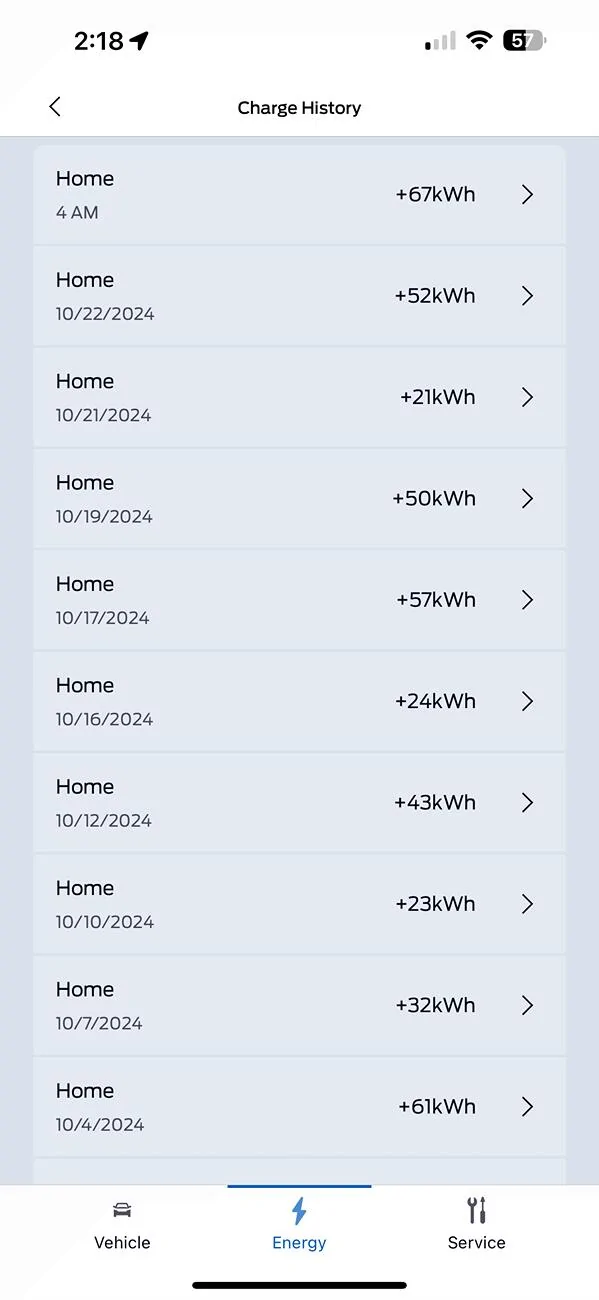

Confirming on my end - last charging session > 1 kWh was Oct 14th. I don't charge every day, but probably every 2-3 days at least and everything after 10/14 is sub 1 kWh which clearly doesn't make sense. I haven't paid attention lately to the white LED, but I've noticed it in the past and eventually started ignoring it since things seemed to be working OK.
