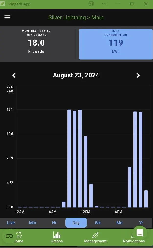

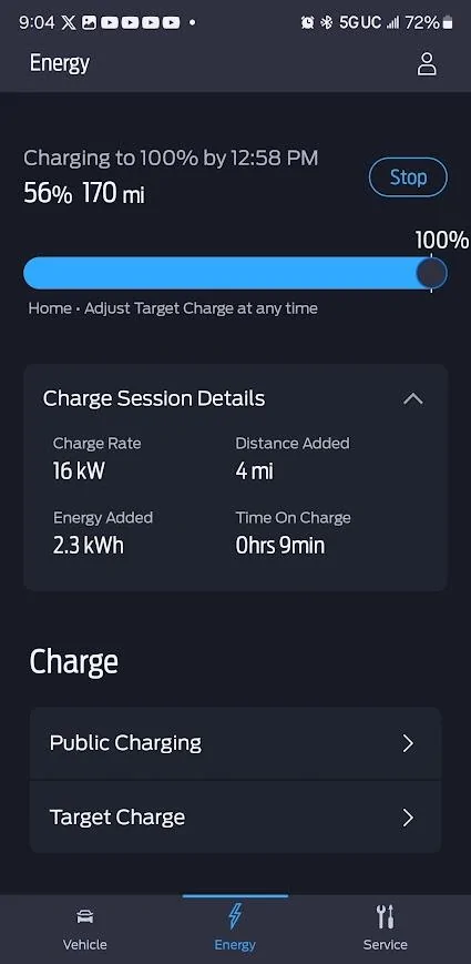

Put everything back together, rechecked dial set to 7 plugged in the truck and got a reported, in FordPass, 16.7-16.8 kW which is about 70A. Not going to troubleshoot anymore for this issue.
You are doing fine, FordPass under reports the actual amp rate [16 KW] compared to what I've seen with my Emporia energy monitor showed [18.1 KW] in the same moment.
This snapshot was only a few minutes into the start of the session so it could have still been ramping toward peak, I never seen 17, 18 or 19.2 KW on Fordpass, and I generally see 18 KW on Emporia
I’ve always figured that FP was reporting net to the battery which might explain the difference.

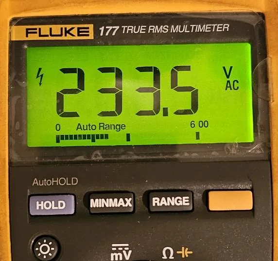

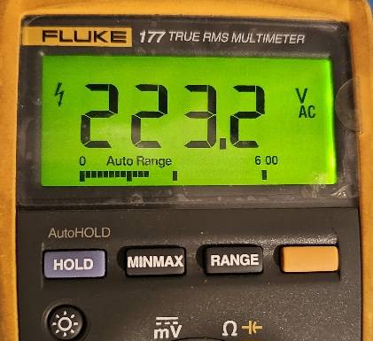

Voltage into the disconnect was 120.xx per leg so little to no line loss from CB panel to disconnect.
Check your voltage when the truck is charging. You may have voltage drop under load.
This is my normal voltage.
Ford F-150 Lightning FCSP refuses to charge at set amperage 1000020110
And this is the voltage when I'm charging at max amps.
Ford F-150 Lightning FCSP refuses to charge at set amperage 1000020109
Thanks, I’ll check
