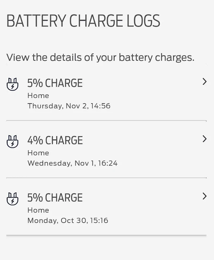

Have you updated to Fordpass version 4.31.0?
The new version is more responsive.

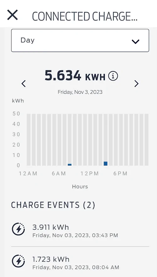

Ford appears to systemically suppress charge records for 24 hours now on the Vehicle > Charging > Charge Log.
When I charged and unplug in the early afternoon of Thursday, the charge record does not appear until Friday morning, this has been the case since release of 4.30.0. Now that I'm looking at it ... my Friday afternoon charge is MIA, this should be visible now but it's lost in space.
Ford F-150 Lightning FCSP Update Pending, Connection Lost 1699098906817
The Insights log shows my preconditioning & afternoon charging from Friday.
Ford F-150 Lightning FCSP Update Pending, Connection Lost 1699099027999
