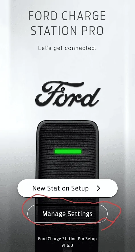

Try logging into the FCSP using it's setup utility

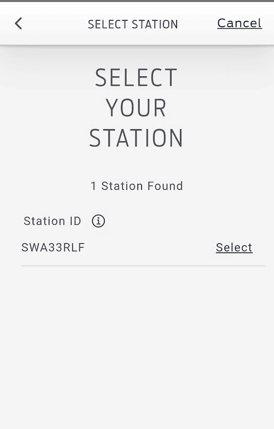

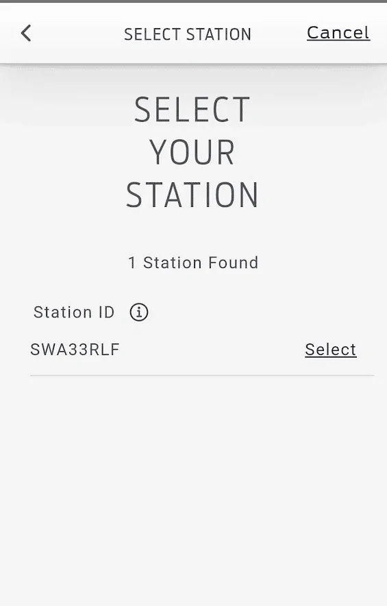

Select the station ID from this screen

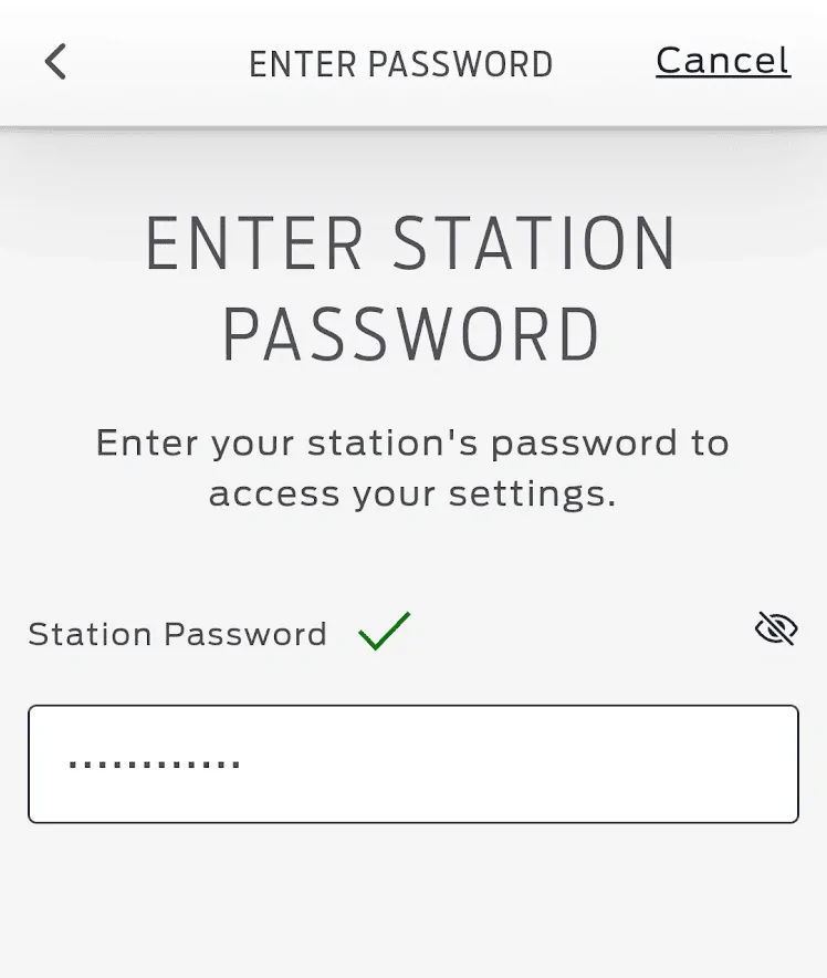

Enter the original FCSP password, then wait a few seconds

If so, while your mobile device is on wifi connected to home network, try logging into the FCSP using it's setup utility
