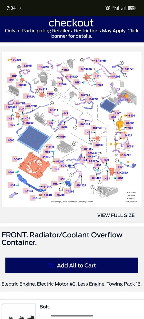

Be careful about that replacement part number you said Ford gave you. (NL3Z-18E254-B) It doesn't seem correct. Double check with another source. The last thing you need is for them to or der the wrong part. Also if you get used, check the manufacturing date on the case of part to make sure you are buying one that does not fall into the group manufacturered in August 2023 and before. (Recalled/faulty)
Here is a picture of a heater out of a Lightning. One without a bracket and one with a bracket. 2023 Lightning.
Date Code: 23330. (2023 on 330 day of the year) November manufacturing date. OEM: BorgWarner.
(BorgWarner emphasizes U.S. production for certain high-voltage coolant heaters,)
Part #: RL3H-18E264-BB (There may be newer numbers) Search this number and select images.
I even showed one opened up so you could see how they are made.
Hope this helps
